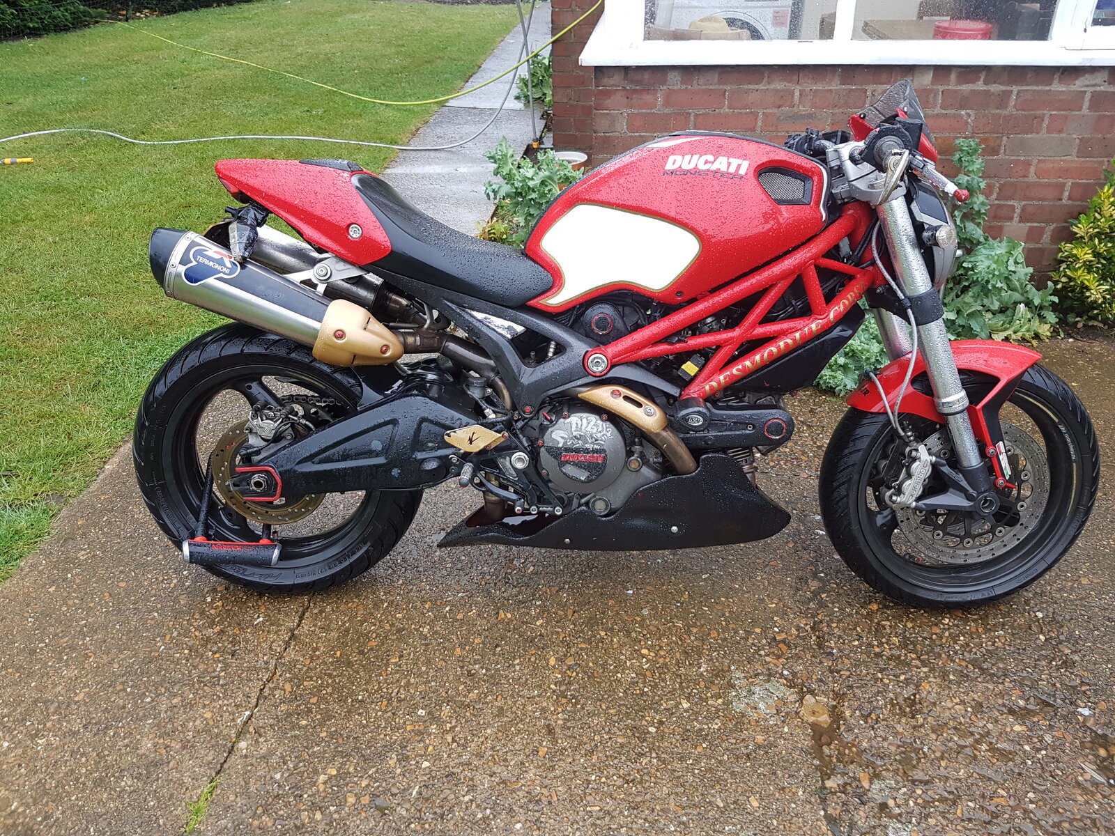

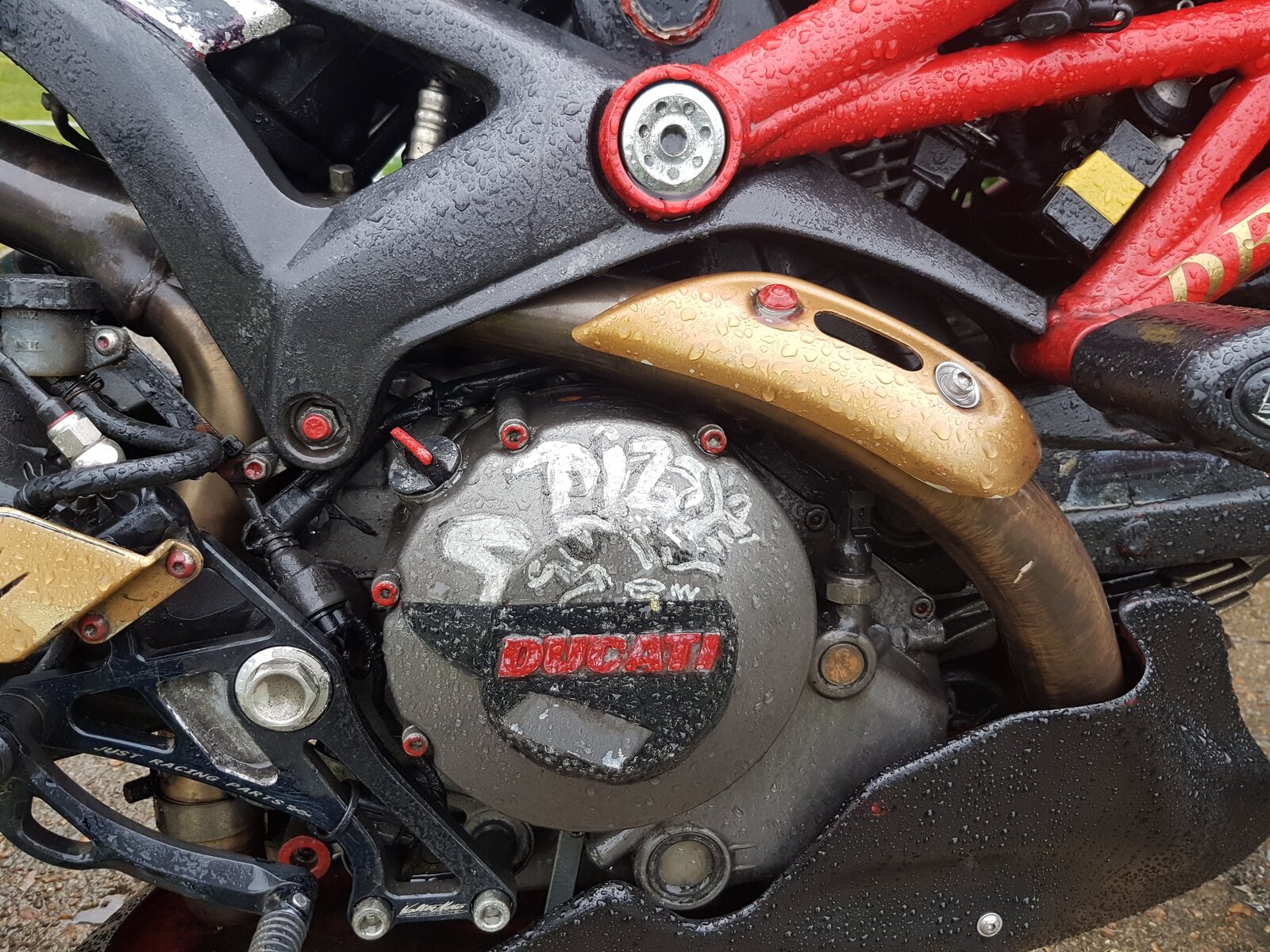

  12. Here are a couple I took this morning, not too bad from a distance but not so good up close. Apologies for the bike being left out in the rain, I hoped it might help remove some paint.....
    The Trouble & I have already spent about 6 hours on it and believe it or not it already looks a lot better than it did.

  15. Something just popped into my head whilst seeing if there was any update, I wonder if the painting on the engine cases is nail varnish?
  16. Funny you should say that, nail varnish remover is next on the list to try today. We are making progress and have the vast majority of the crap off and I took the belly pan off too as that looked terrible on the bike.
  17. Using what?
  18. Mainly petrol and white spirit so far .
  19. Try warming it gently with a hairdryer and then use a plastic scraper to loosen the unwanted paint but go very slowly and carefully!
    Finish off with Tcut and polishing cloth.
