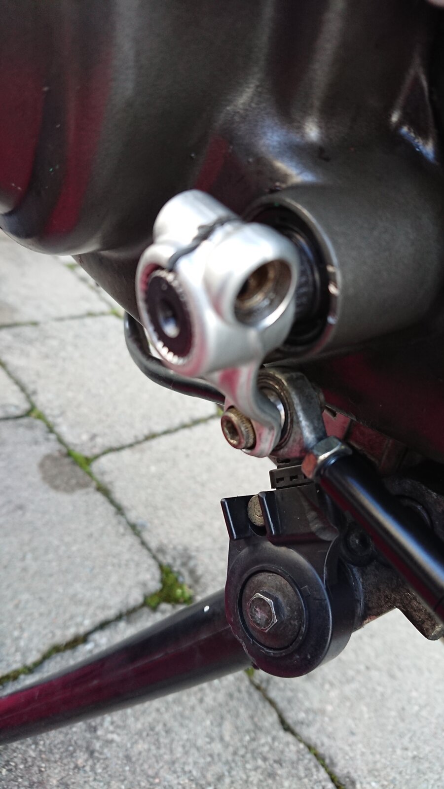

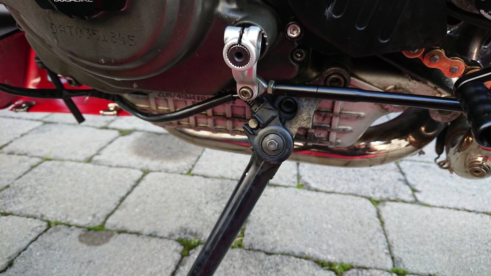

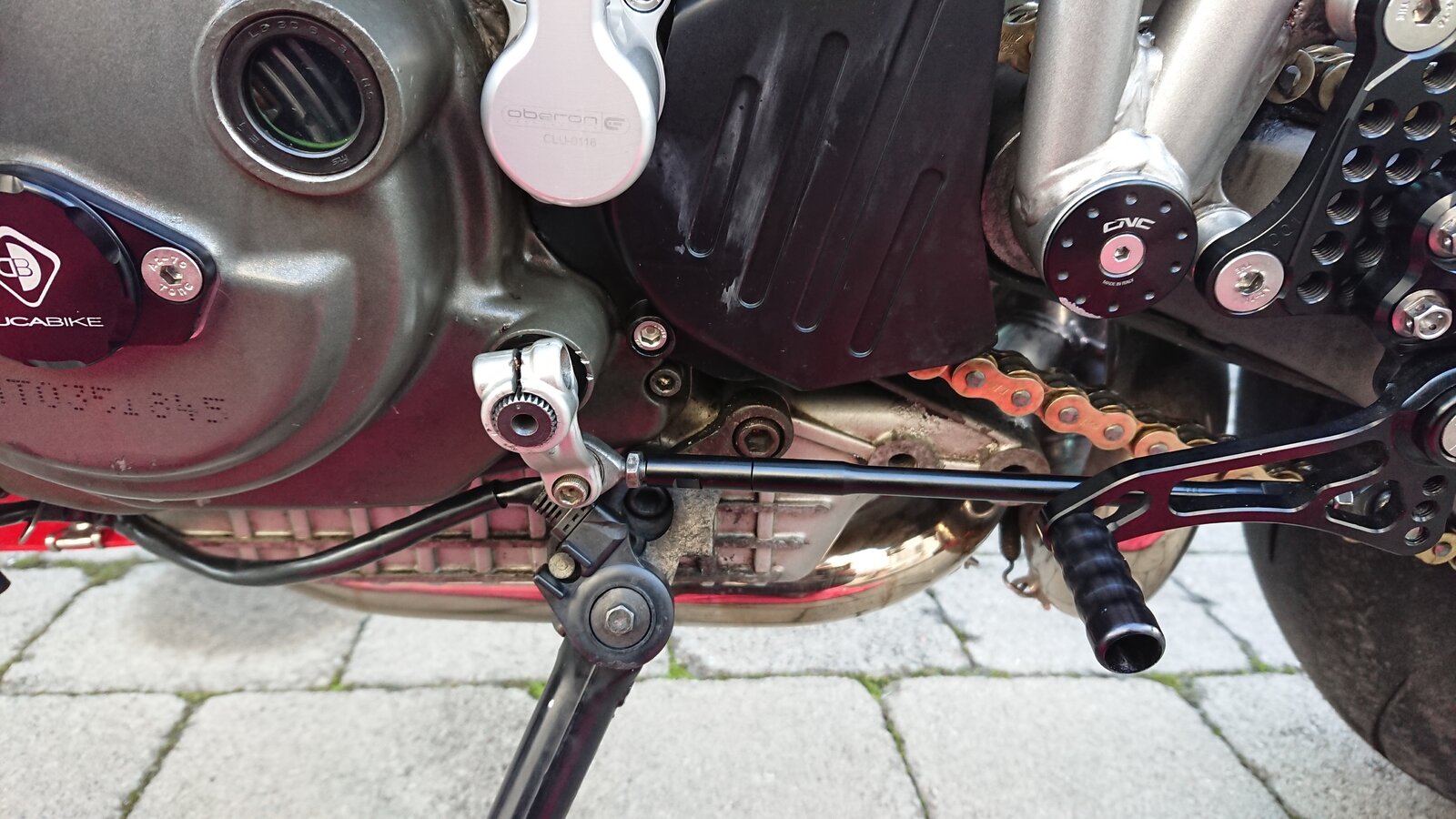

  4. On the clutch lever, did anyone manage to get a 90 degree setup, I tried a few adjustments with spline, extension bar... But anytime I set it to 90 degrees linkage it his the engine casing on up shift
    At the moment its slightly off 90 degrees with 2mm clearance on maximum extension on up shift
    This is as close as I could get it

  6. @CarloL get one of those splines from Podium racing in the states. Don’t cost much. I had the same problem and this solved it. You can have it either way round for both road and race shift.
    27699B28-438A-434C-9257-2E55B69ECEC3.png B22B4895-4D9D-4FF7-A567-35D9CE98A952.png
  7. Excellent , Thanks Ian!
  8. That's close enough as long as the shift is smooth without having to use excessive force. 90 deg is optimum but not always possible.
  9. I got the podium racing clutch lever hopefully should allow me get 90 degree angle
  10. It will! :)
