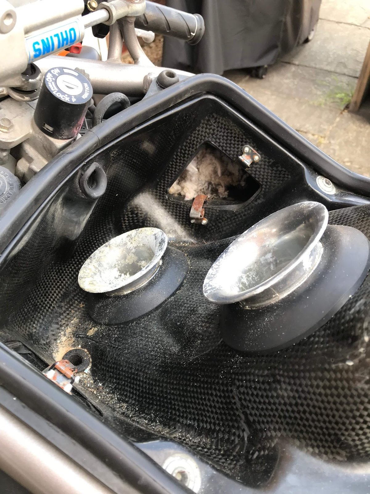

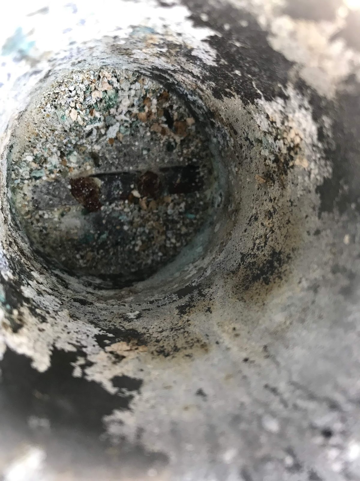

  1. Today is a sad day. I just got the word that my 2000 996S is most likely beyond repair. While stored in my shed over the winter, a mouse got into my air box and built a nest. The resulting excrement that dripped down my throttle bodies and into the cylinders and pistons corroded it so much that it is probably cheaper for my insurance to write it off than to repair.

  2. Nothing is impossible to repair on 996 mate, take it to bits and rebuild it, good excuse to tune the engine as well.

  11. Are the pistons and valves corroded as well? Would the insurance assessor know without taking it apart. You might find most of that corrosion is above the throttle butterfly valve. In which case you can remove the throttle bodies and work at cleaning them up. My 748 had been standing for 8 years or so and the throttles were seized closed with corrosion from moisture - admittedly not as bad as mouse wee/s**t. I thought I'd have to get some replacement ones they were that bad but as I had nothing to lose I tried to clean them up and see if I could fix them. The result was yes. They now work perfectly albeit a bit marked from the corrosion. If it's just the throttle bodies get out all the loose crap with a vacuum cleaner so it doesn't drop onto the valves. Remove them and rub the corrosion with vinegar and aluminium foil, it works a treat. Even if it has got inside the cylinder I can't believe its so bad it can't be fixed, that's a cracking bike you've got there. Even if it is red! ;-)
  12. The shop pulled off the throttle bodies and yes, there is corrosion that has entered the cylinder. They're guessing it has attacked the pistons also. Known costs are already pushing up against pay-off costs, and they won't know the extent of the damage unless they pull the heads off. Current thought is they will probably make me an offer rather than getting into more money with the repair facility just for inspection. I'd like to buy it back then sell it to someone who could get it running again. I'd hate to see it go to the junk pile. Really just depends what's best financially. It is definitely repairable...just at what cost?
