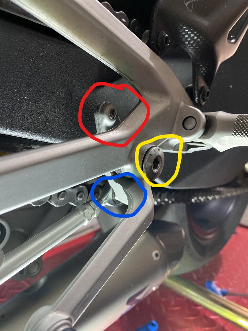

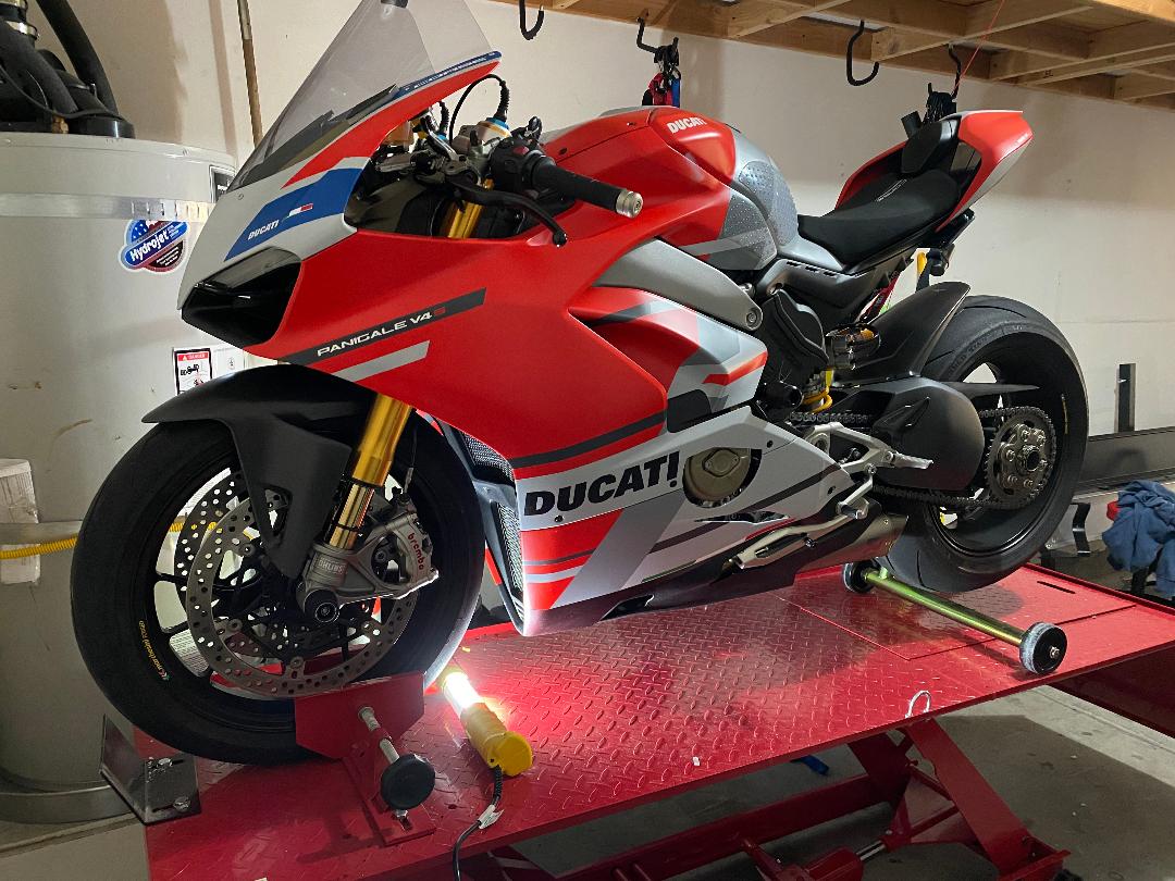

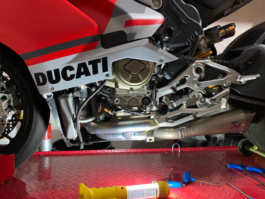

  4. This was very easy to do.....done in less than an hour.
    First up on the lift
    Remove lower left fairing/belly pan
    Remove bolt holding on shift lever (yellow circle). Shift lever and linkage will hang down giving you room to work.
    Red circle is OEM location for the linkage, remove bolt and move the linkage down to the blue circle and now you have GP shift.
    Did not need to adjust anything, QS works great up and down.
    Cheers

  9. Photos are bang on thanks. Do you know the torque setting for your yellow bolt, and the linkage bolt?
  10. I snugged them down and used a little blue lock-tite
