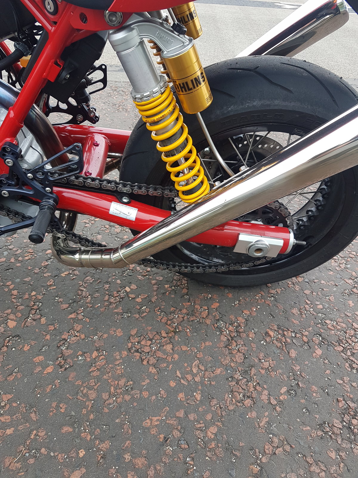

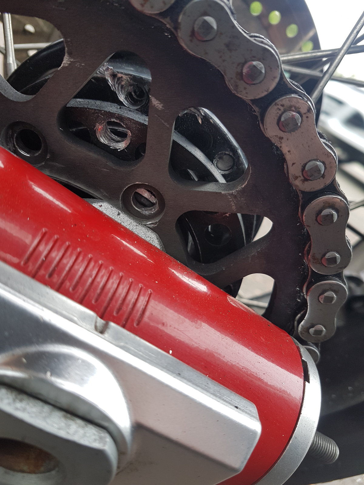

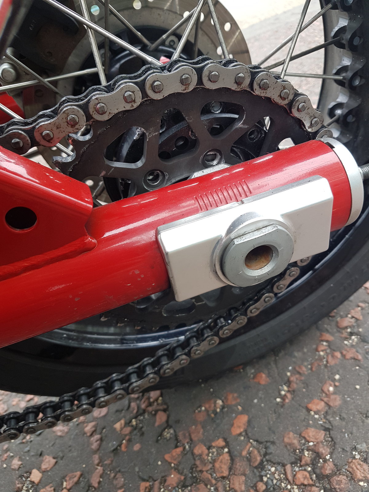

  1. Im standing at a roundabout on way home from nw200...the fecking back sprocket has sheared off the bike. Mate on way with van. 20180520_152248.jpg 20180520_151728.jpg
  2. Grrrrrr :mad::(
  3. What bolts were in it? :thinkingface:
  4. Feck i dont know but they look to have sheared.
  5. Doesn't look sheard to me, looks like you have lost the bolts. o_O
    **Edit - Have you lost some bolts and the remaining ones have snapped? :thinkingface:
  6. Im bored.....on van stopped but full of moto cross bikes....to the multistrade rider who nodded and rid on past........thanks.
  7. The bike was ok yesterday. I felt a wee knocking in portrush but nothing i could see.....have i been vandalised?
  8. If I were a betting man, you've had a few bolts spin out and the load was too much for the remaining bolts to take........:bomb:
    • Agree Agree x 6

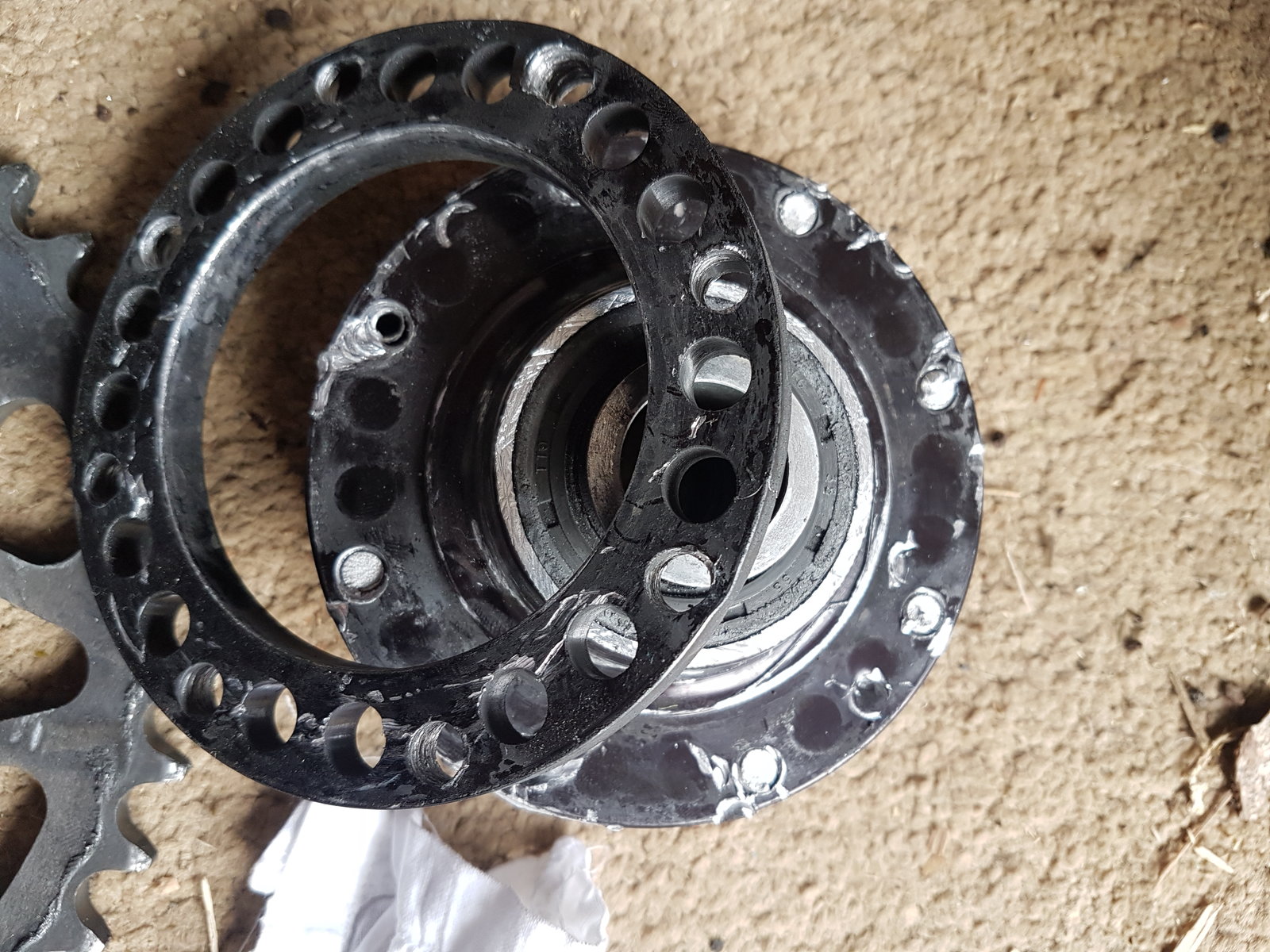

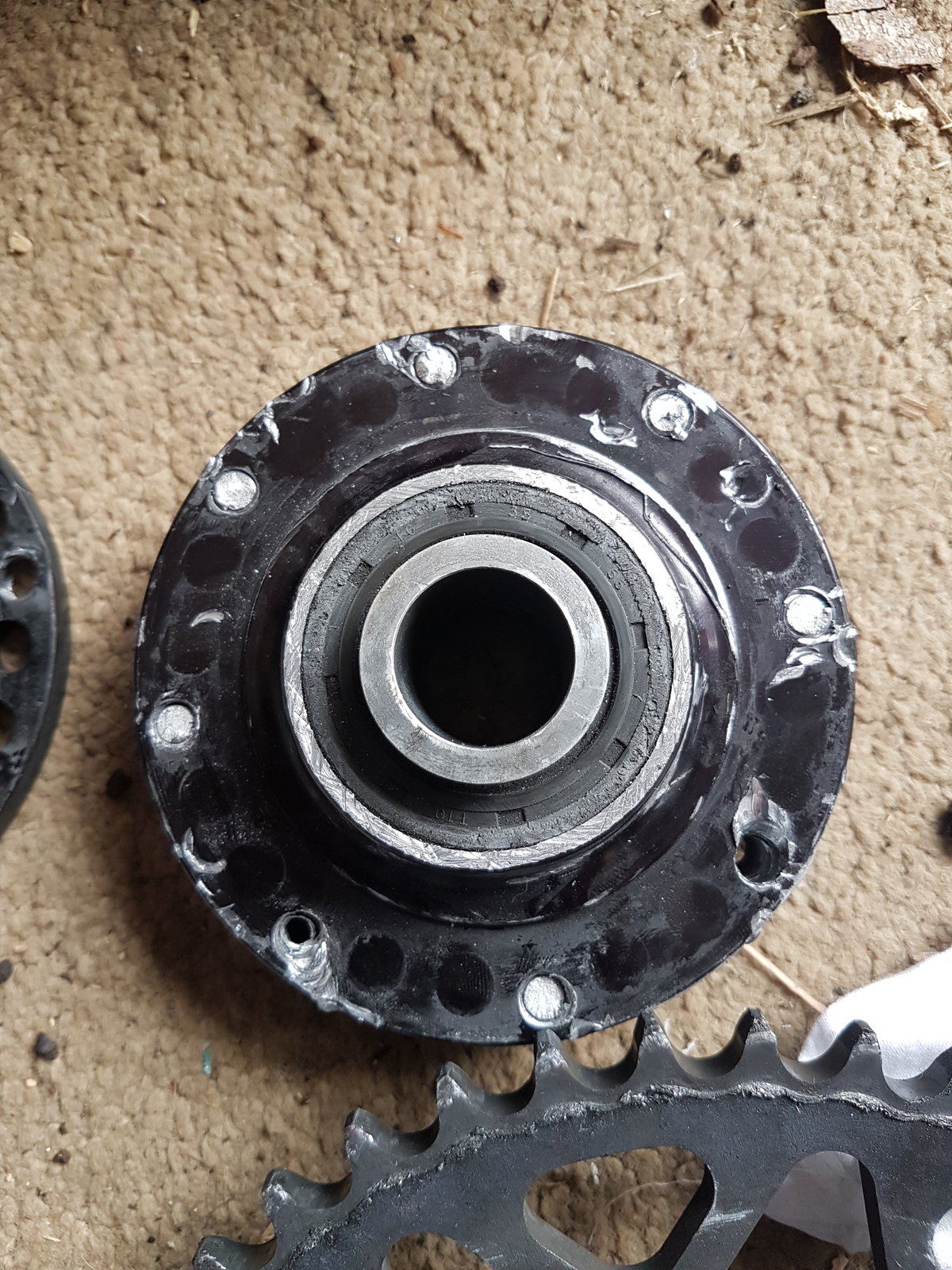

  9. How many remaing sanpped bolts are in the hub? I think this would be a good indicator of how many you lost prior to the failure. :thinkingface:

  11. Im ok....i just dropped down the gears from a 100mph dual carriageway with lots of traffic and lost drive ,managed to weave my way to side of road. Could have been really really nasty.
    I think your right re losing bolts, but just out of mot? No probs in seven years fitted. I cleaned it a week ago and no sign of anything.....fecked if i know what happened.
