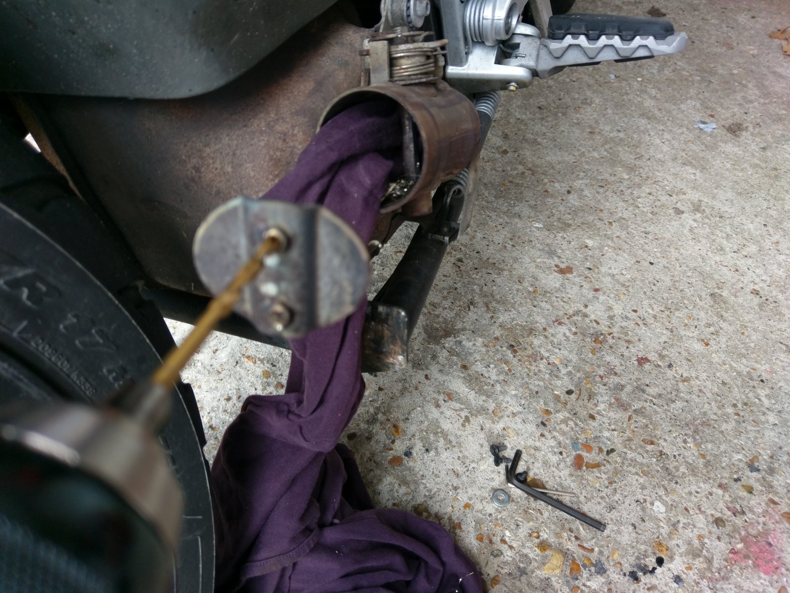

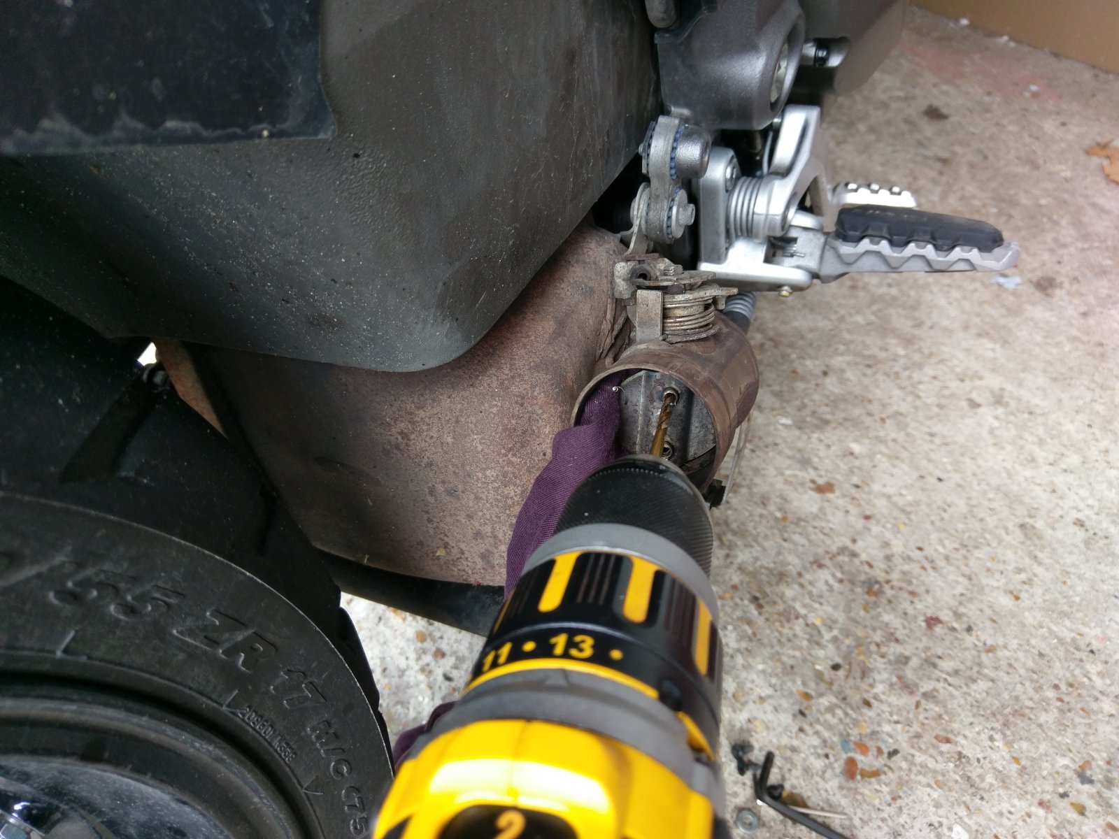

  4. I drilled out the screws on mine as it was sticking
    pretty straightforward - but it's easy to drop the butterfly into the cat which would be a pain to get out

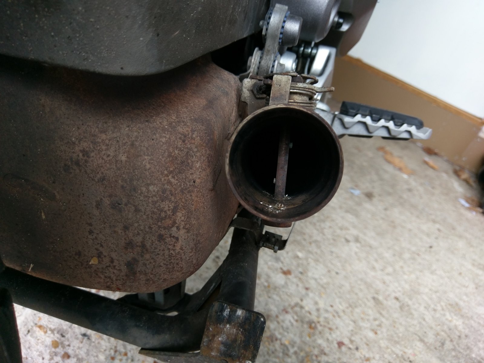

  5. cheers mate, that's exactly what I've just done and throttle response is definitely sharper since that daft valve removed. I put cloth down pipe to catch swarf and valve, would recommend doing this to all multi owners. And for my efforts, a pint me thinks :grinning: IMAG0459.jpg IMAG0460.jpg IMAG0461.jpg

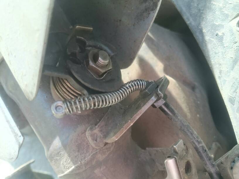

  6. 10 pence fix valve fixed open and spring fitted as shown keep the servo in the loop so no error messages.

  9. My butterfly had Phillips screws that had a weld spot to butterfly. Dulled six bits so far I may have to use spring.
  10. Yeah mine too, used a 4mm drill direct into middle of Phillips screw, once heads of screws drilled, butterfly fell off. :upyeah:

  14. Not too bothered now it ain't there, cable and motor can do what they want :upyeah: Definitely makes a difference to the mid range throttle response, whereby that valve usually pulls in. Much better, easy fix :)
  15. Ammended my post, just looked at drill bit, is a Ti coated HSS 4mm Makita, one bit did both screws, but the bit is now done for

    I'm using spring method.
  18. If you have a Dremel(EVERY biker has a dremel :) ), just fit a small grinding wheel, and remove the screw heads. Only took a few minutes, not including the end can removal/refitting, and no broken Drill bits.
  19. That's what I did, I just ground the weld off securing the screw heads, then removed the screws, simples..!
