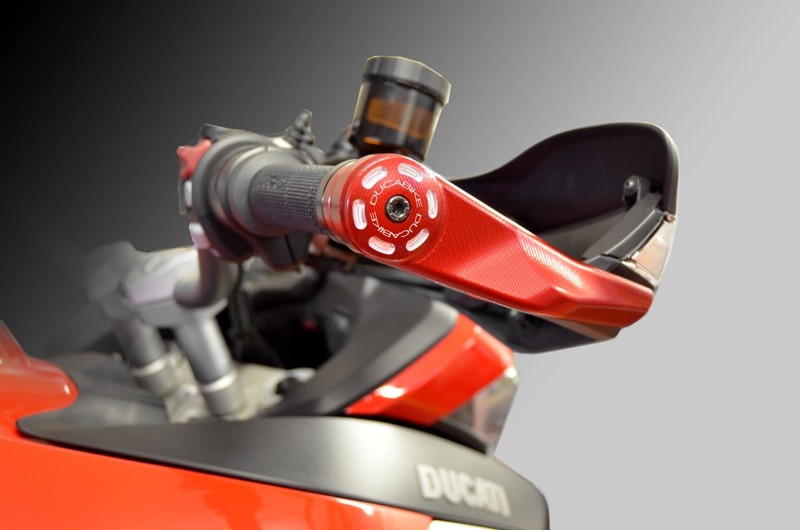

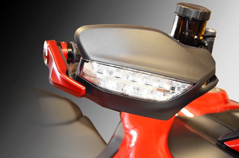

  1. Having broken yet another hand guard this morning in London traffic I was wondering if there was any other option for protecting these (apart from Bark Busters)?
    I found these ones for the Enduro, (they are also listed in the DVT section on Ebay), Does anyone think they would fit the DVT as well? Expensive but might be cheaper in the long run.
    http://www.ebay.co.uk/itm/Ducabike-...tors-Silver-/182597295288?hash=item2a83a59cb8
    Can't seem to get hold of anyone at Conquest Carbon to ask...

  7. Effective, but not well designed way of fixing and somewhat ugly...

  10. Admitted their not the prettiest of things, but they worked brilliantly at protecting my levers and my hands many many times on my KTM enduro.
    Can't see how those little bits of alloy will work though but they do look pretty.

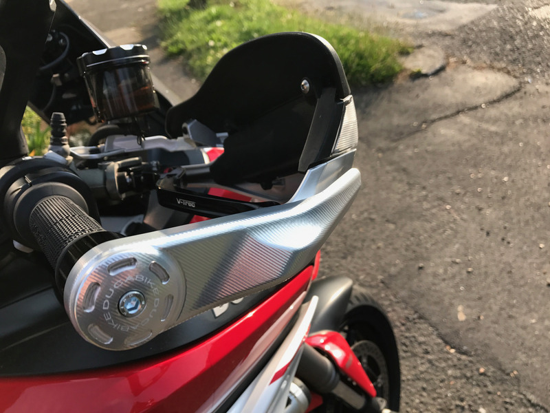

  16. I fitted these last night, very easy job, just don't undo the bolt too much and lose the end of the brass adjuster inside the handlebars (I didn't do it this time!).
    I have to say they are very smart. I went for silver so they blend in with the existing hand guard, well made and there is a nice machining finish to them. The probably add about 5mm to the width, but the mirrors still stick out further. I think the only criticism is if they extended a little further around the front it would make it even less vulnerable to knocks.
    The new silver hand guards cost £44.74 each from Ducati and I've broken 2 in just over 12 months, so it justifies the purchase... in my own head :)

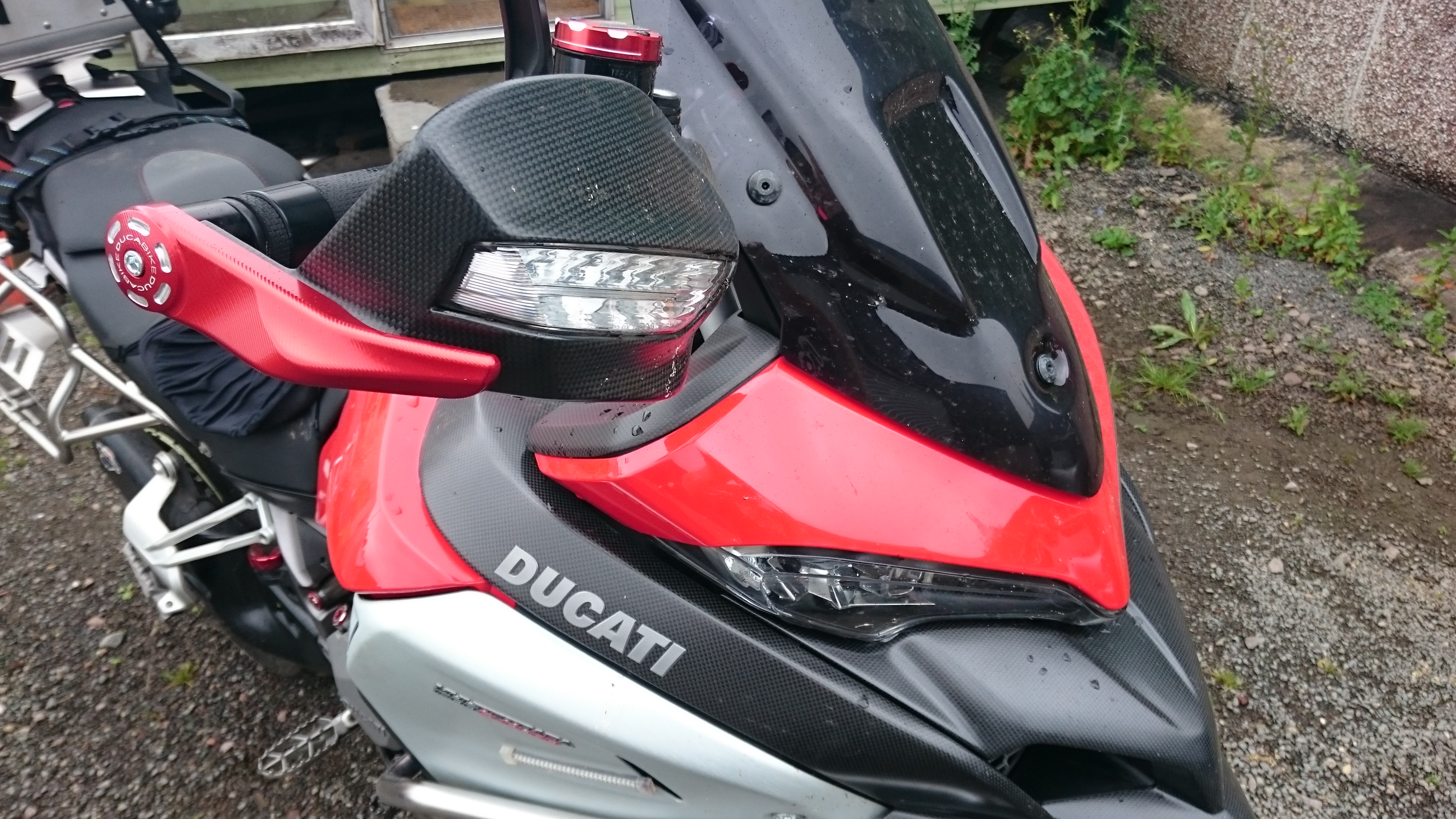

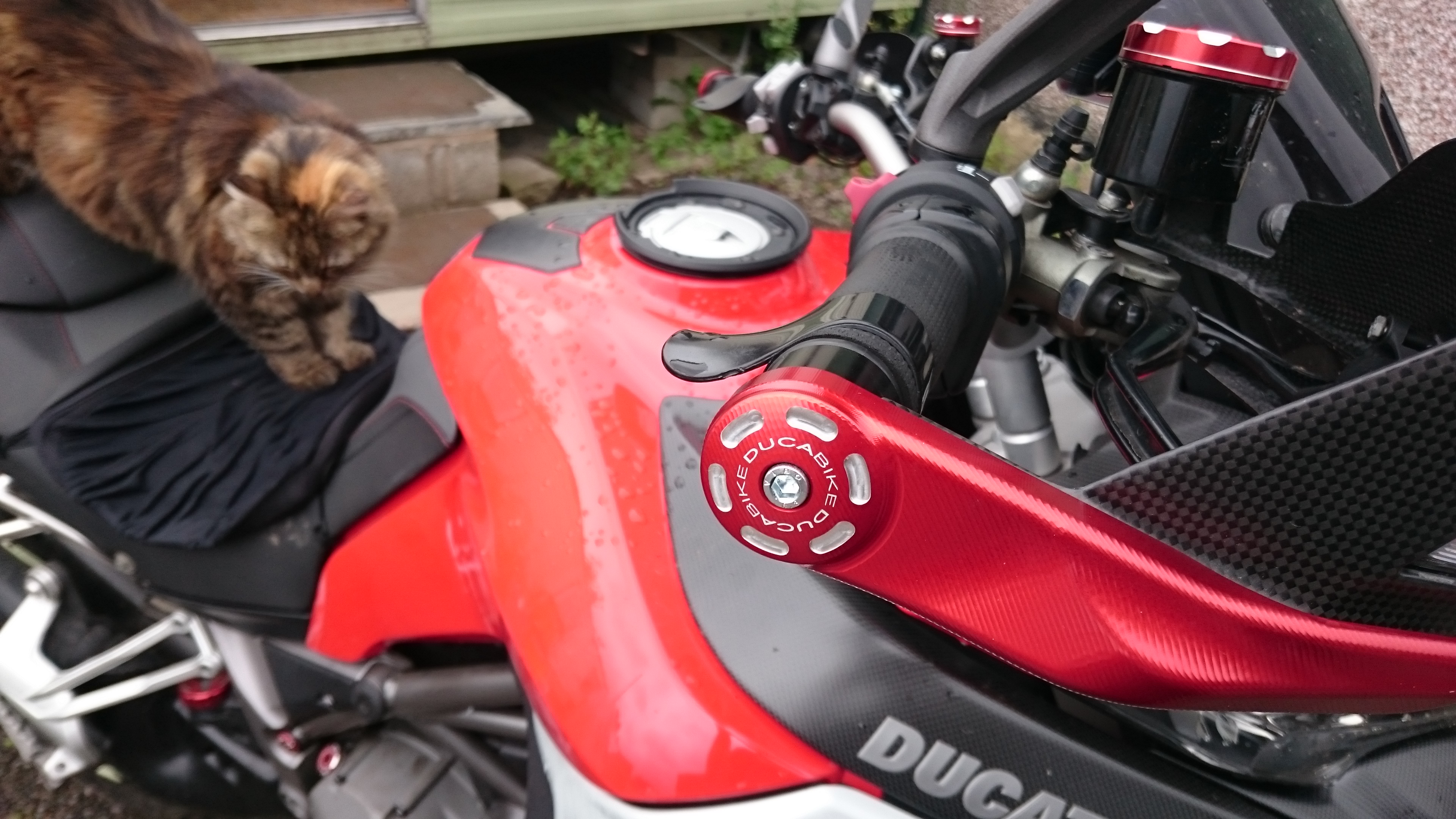

  19. Mine arrived yesterday with another thing to add once my axel sliders arrive. So trying to show off a few other bits-n-bobs from Ducabike through carbon-conquest (here on the forum traders bit) check out my dirty bike!
    Install; bike on center stand, twist handbars down in one direction. Remove the orginal bolt & small hidden spacer. Remove large spacer & inner brass nuts. Slide a small plastic bag into tube around the depth of the new bolt length. This plastic bag acts as a stopper to help do-up the brass inner bits. Put all parts back in in reverse & do up!

  20. probably also act as a bar end weight to help reduce vibration.
    Anyone got any shots from above looking down at grip and hand guard?
