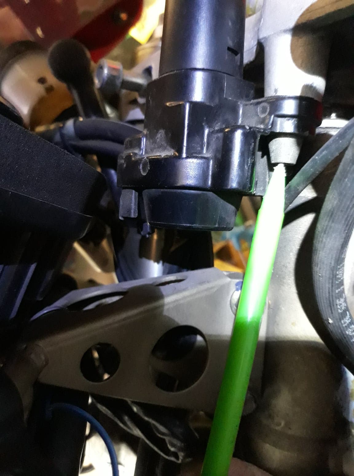

  12. Yoke bolts.jpg So, got the grips etc off the rhs (bar end removal not needed after all) but the top yoke removal looks a bit more involved than Haynes suggests. Fork and steering stem pinch bolts undone, steering stem nut off but I now see gold coloured 2 bolts thst appear to hold the ignition barrel to the top yoke. Don't appear to be internal (allen) bolts or have flats on them. Are these security bolts?
    Ok so I've been a bit lax with searching on here for pointers and have now found that they are security bolts that may or may not come out easily. Various methods seem to have the potential to work so I'll I see if I can remove with pliers or a bolt with a locking nut on.

  13. If you can get the top yoke off, its easier to remove these bolts usunig one of the methods you describe. The ignition barrel has a plug you can remove to facilitate this.

  15. Thanks, access to the bolts is pretty restrictive in situ so hopefully I can manage this
