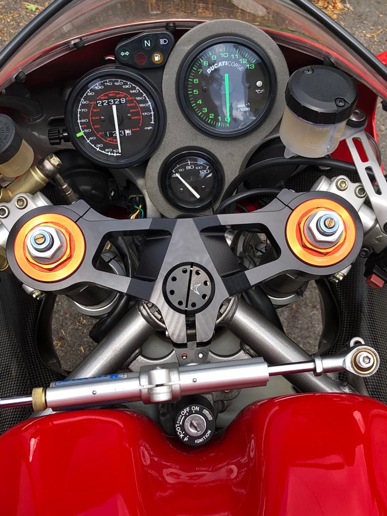

  9. I have the Speedymoto yoke on my 998. Think it’s great, it gives a little more comfort without losing the connection to the front wheel or upsetting the weight distribution and looks good too. Photo attached (colours look a bit weird)
