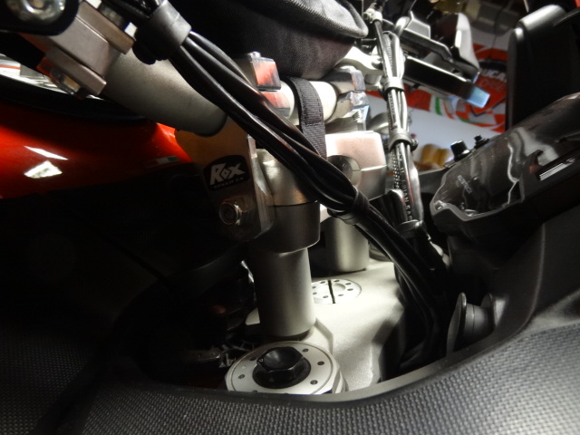

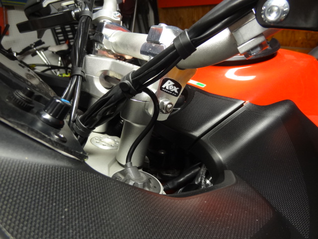

  10. I raised it up add on Rox 1 1/8" and 2" raise

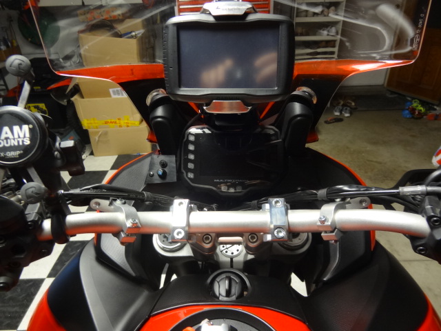

  12. Taller bars might be a cheaper option.
  13. That’s what I’m thinking. Enduro ones any taller?
  14. Certainly a different part number:
    36015561AA - Multistrada
    36015441BB - Enduro
  15. I'm a mechanical numpty. Are the risers fairly straightforward to fit and, any problems with rerouting cables?

  17. CD9A9FF4-C850-4181-B6A4-BB478FED864F.jpeg Certainly look taller
