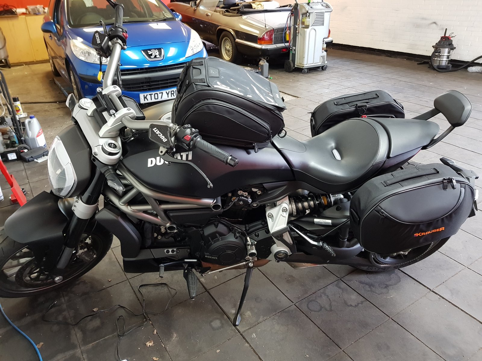

    I'm 11.5 atm and had to wind the rear pre load up but riding 2 up G/f is about 9stn I have to wind the preload right up ! Lots of ppl say soften the rear trust me DON'T.
    The rear spring bottoms out and that's what causes the jarring over bumps! I've swapped my rear spring for a ollins unit for some touring 2up with luggage but not had much time with this weather to set it up yet I have been reliably informed that ollins are going to release a replacment unit soon !!!!
