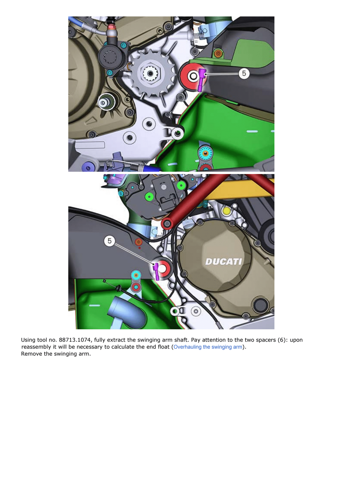

  15. also as post #2 says make sure these are removed (5) in pic below
    #18 knightrider, Feb 15, 2023
