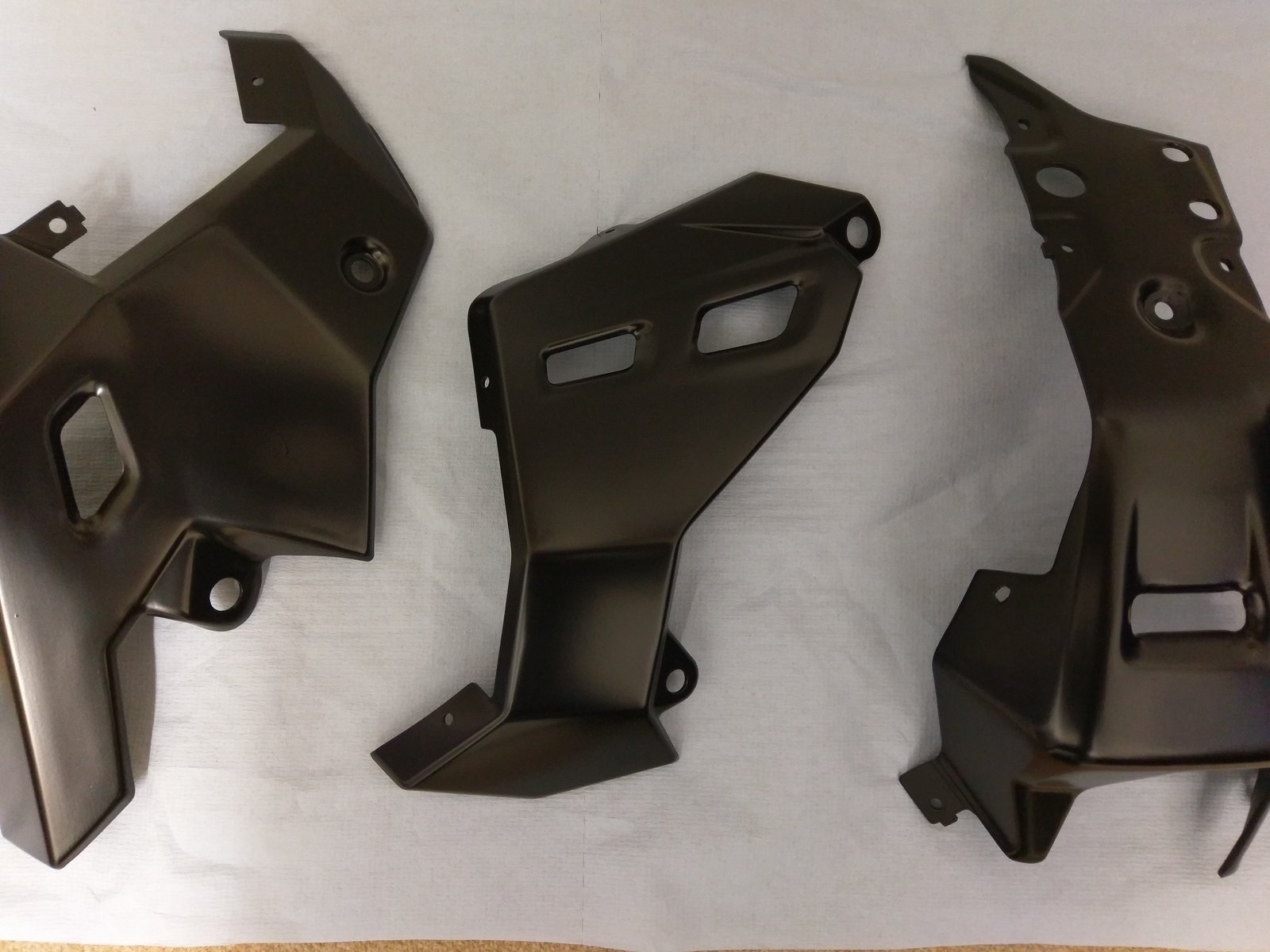

  5. As it's a trellis frame, then you really would be better off either powder coating or painting with an electro static gun as they kind of wrap the paint round the frame using opposite electrical charge to frame and paint. For the wheels, my best guess would be 2x primer cans, 2 or 3 top coat and 2 cans lacquer. For the tank and cowl, my guess would be 3 or 4 of each again, but obviously depends how deep and good a finish you require, but most important is the prep work. Just as a guide, I've just painted a belly pan on a multi, took 1.5 cans of primer, and nearly 2 cans of satin black, but even for such a small item, it took 2 days as I let it properly dry between coats, and used 2500 grade paper after each coat. Good luck and let us know your progress.

  13. Crap photo but the inside and outside of these three parts (Multistrada bellypan) took 1.5 cans of 500ml grey primer, and just shy of 2 cans of satin black. I think I could have got away with 1 can primer and 1 can top coat and would still have looked fine. Each part is approx 12-15 inches long
