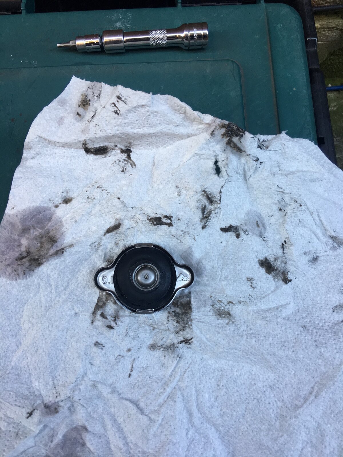

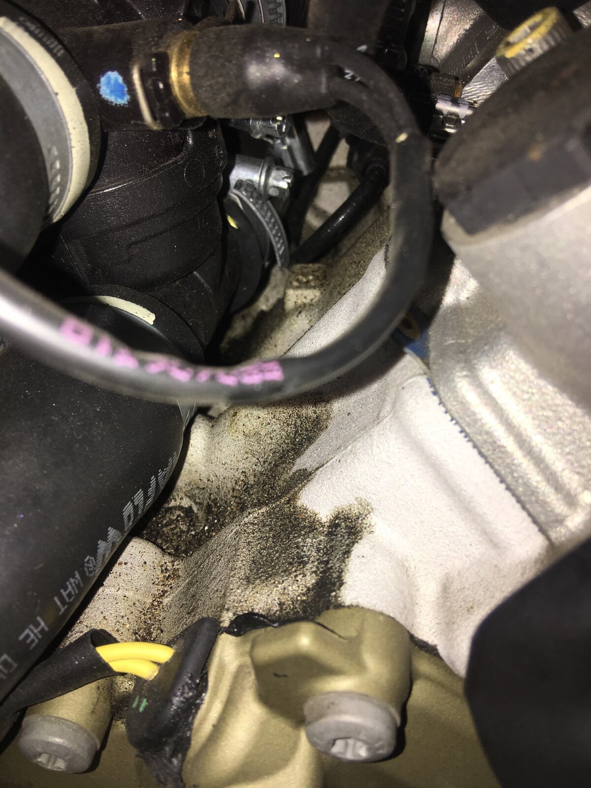

  1. I own an early 2018 V4s, it seems to have sprung an oil leak from between the cylinders and a thirst for coolant. A thirst that means it drinks all the coolant within a 5 mile ride !!!!!
    The radiator cap get a build up of oily slime when the coolant is filled up and the expansion bottle had similar oily residue coating the inside
    Anyone else had similar issues ????

  2. Could be a cracked block or cylinder head not just the head gasket mate

  4. The coolant lasts less than 5 miles before it is all gone. There is no white smoke out the exhaust and definitely no leaks out of the coolant system onto the floor. It just evaporates

  9. Have you checked the oil level?? The coolant can't just disappear like that I bet it's filling the sump up.
