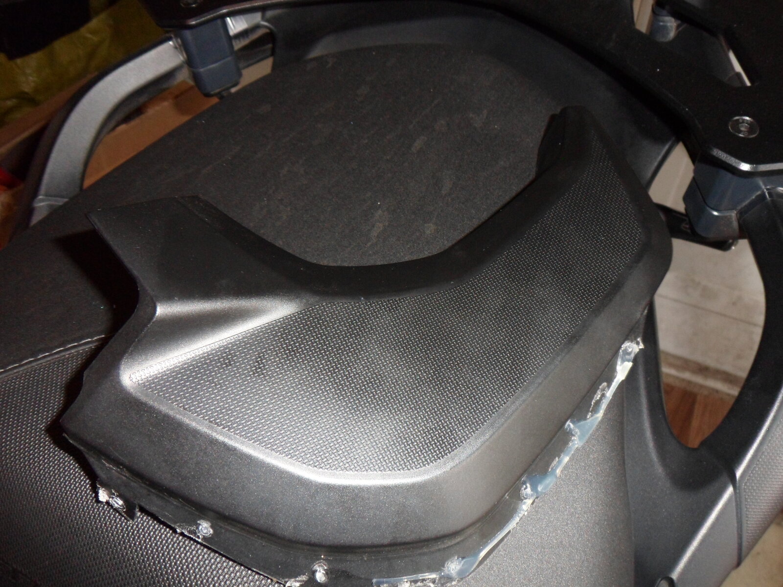

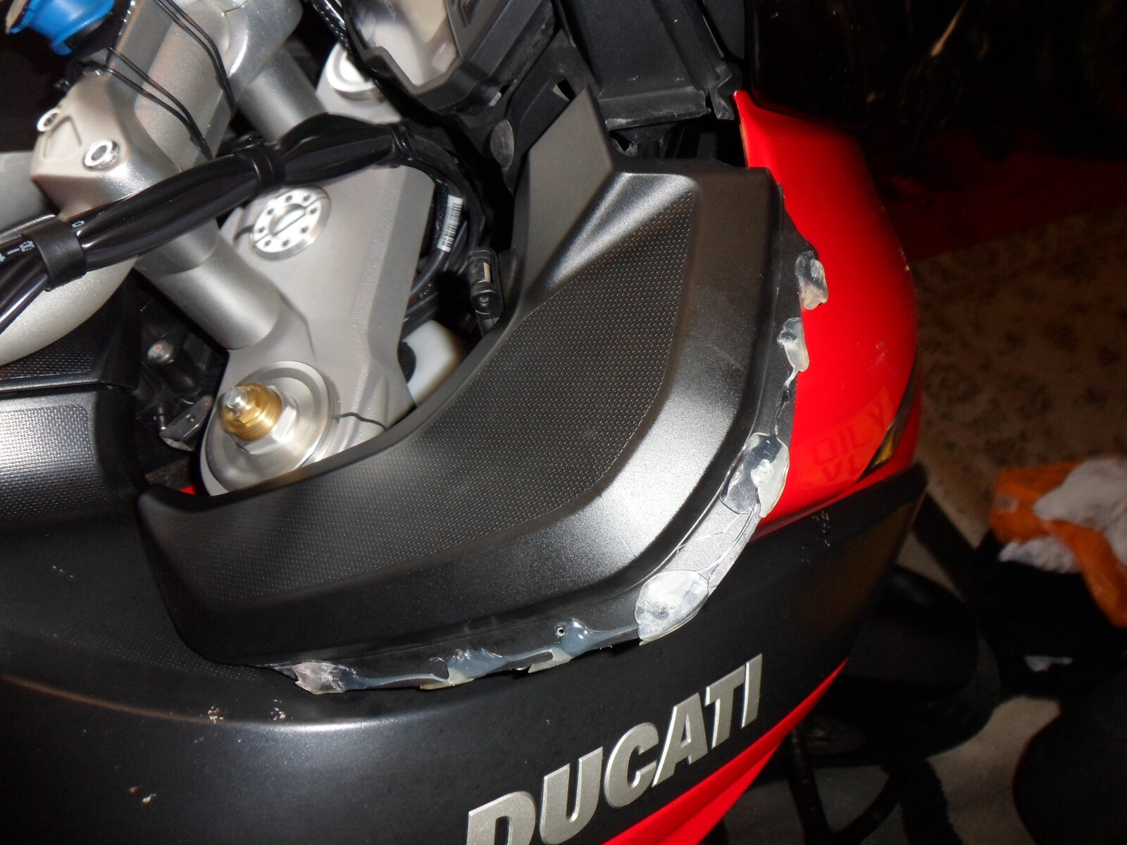

  1. 17 DVT, had a ride out to devils bridge the other day when it was roasting, saw 30 on air temp, anyhoo noticed the black infill panels (where the DIN socket is) on both sides vibrating more then usual. When I next stopped I had a look, found them to be quite loose, nothing I could do then as no tools. On return home, I had a good look and found both completely loose now, and the edges where the infills tuck under the headlight fairing beads of semi solid glue?
    Doesn't look right to me fellas, that was the LHS, RHS with the DIN socket and the wireless coil attached just the same!

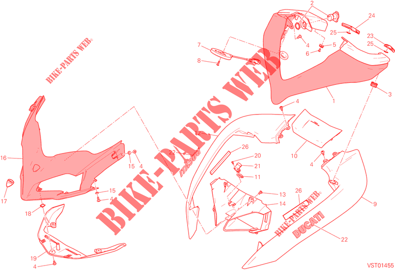

    Had a look at the diagrams on DBP, which shows the headlight fairing part number 1,

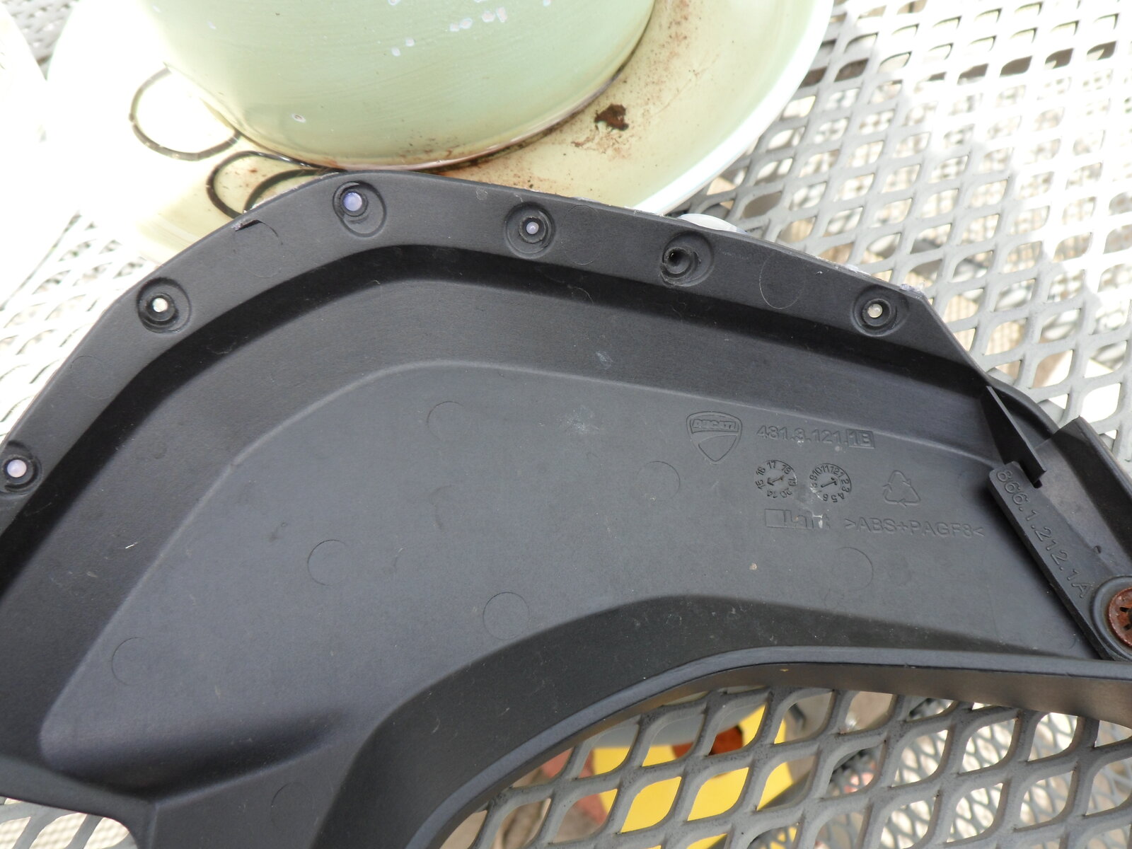

    the part number on the back of infill panel, which I searched for on DBP gave no results!
    Any guru able to enlighten me, as I cannot believe Ducati would just bond these together with a feckin glue gun! Also a pic of space underneath the LHS infill looks a bit bare! am I missing something?
  2. Looking at the parts fiche it makes me think that the red front cowl and those black infills all come as one part.
  3. Had a pull at mine, and it doesn't seem to come apart. Indeed feeling underneath, it does feel like it could be glued together !!!!
  4. Glued together with a glue or process not fit for the application, same as the fasteners they use I guess. They should go through Crest Tests to alleviate these problems at the prototype stage - but it could be that the hot melt was too cold when applied of course. Clean it of and re glue it properly if your out of warranty and Ducati won't help :):upyeah:
  5. Yeah just been to see my mate who has 1260, had a look with a torch and dentist mirror thing, and it is just glued!!!

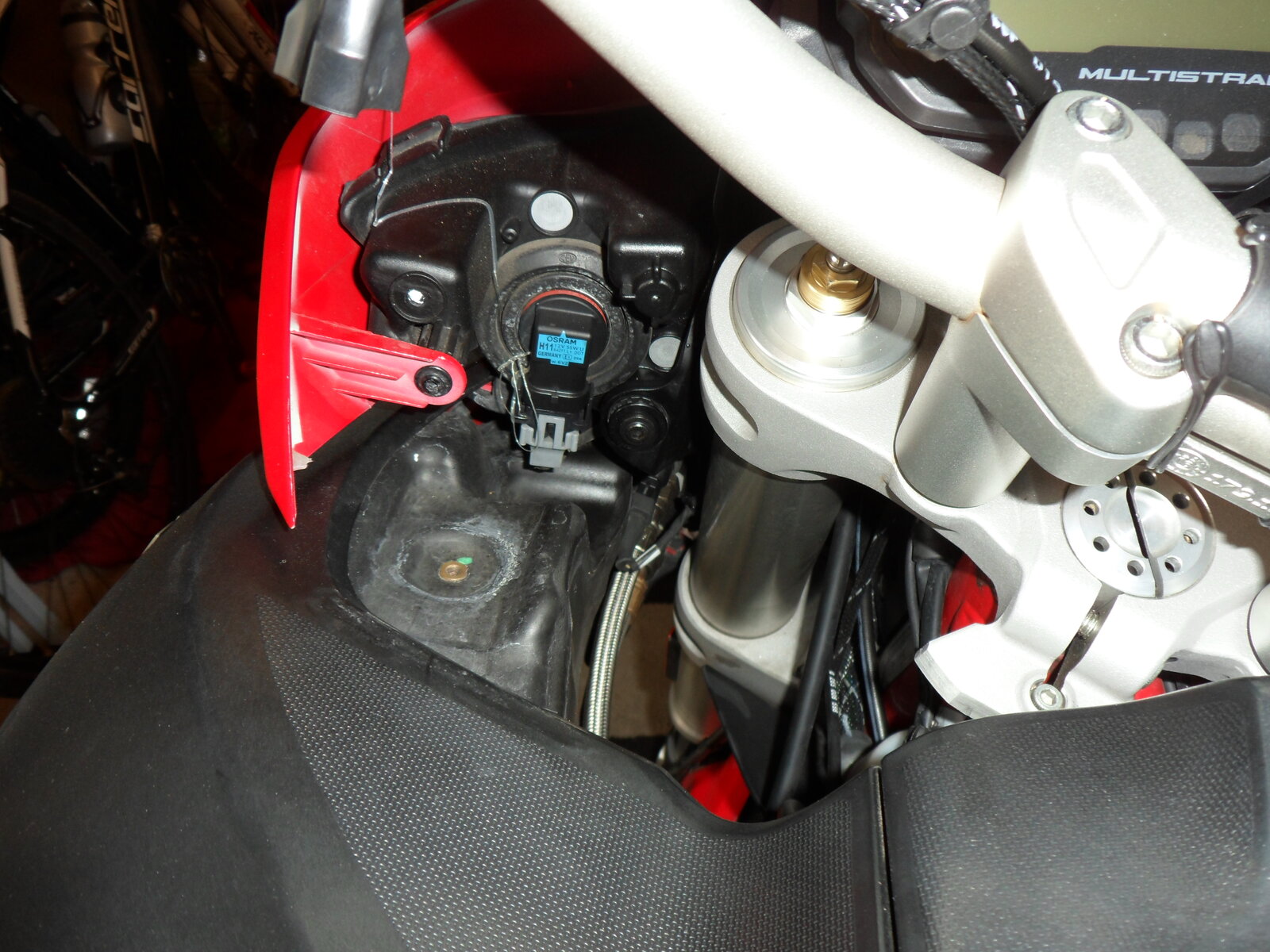

  12. Thanks mate, think you have the definitive, I'm gonna take it all apart, give it all a good clean, fit one of those USB voltmeter units, maybe a TPMS unit too, then bond back on. The hidden screws are in an arse of a location but if I need to strip in the future they'll be more accessible with the tank cover off!
  13. I took mine off for exactly that purpose - I fitted a USB/voltmeter unit, plus a switch for some auxiliary lights. I'd have left it on, except I needed to take a feed off the Hella socket on the other side of the headlights.
  14. That's my intention too chief, take power from back of the din, do you have any pics of finished article?
