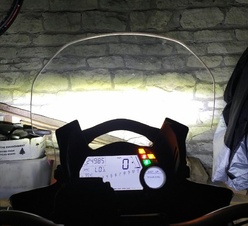

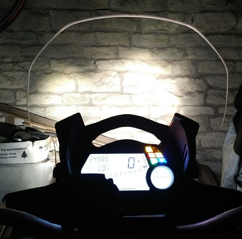

  19. Just fitted some new bulbs for the dipped beam. The main beam are the "upgraded" Osram Nightbreaker Plus. What do you think?
    Main beam (yellow)
    Dipped beam (blue white)
