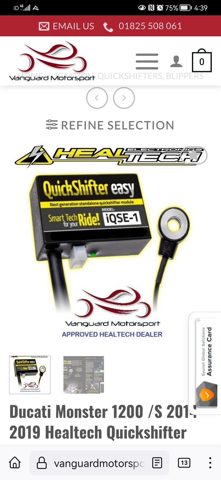

  6. Hi Sam,
    Do you have a recent 1200?
    I have been looking at a Healtech Quickshifter Easy iQSE-1 and wondered if it would work well on a 2014 Monster 1200S.
    Is it good for down as well as upshifts?
  7. Pretty sure it's only for upshifts, but could be wrong as I haven't fitted one on a Monster.
  8. It will still cut the ignition on downshifts but the gearbox is normally unloaded anyway for downshifts. On a part throttle downshift, it will let the gear go in, but of course, can’t rev match as there is no blipper, so it won’t be entirely smooth.
