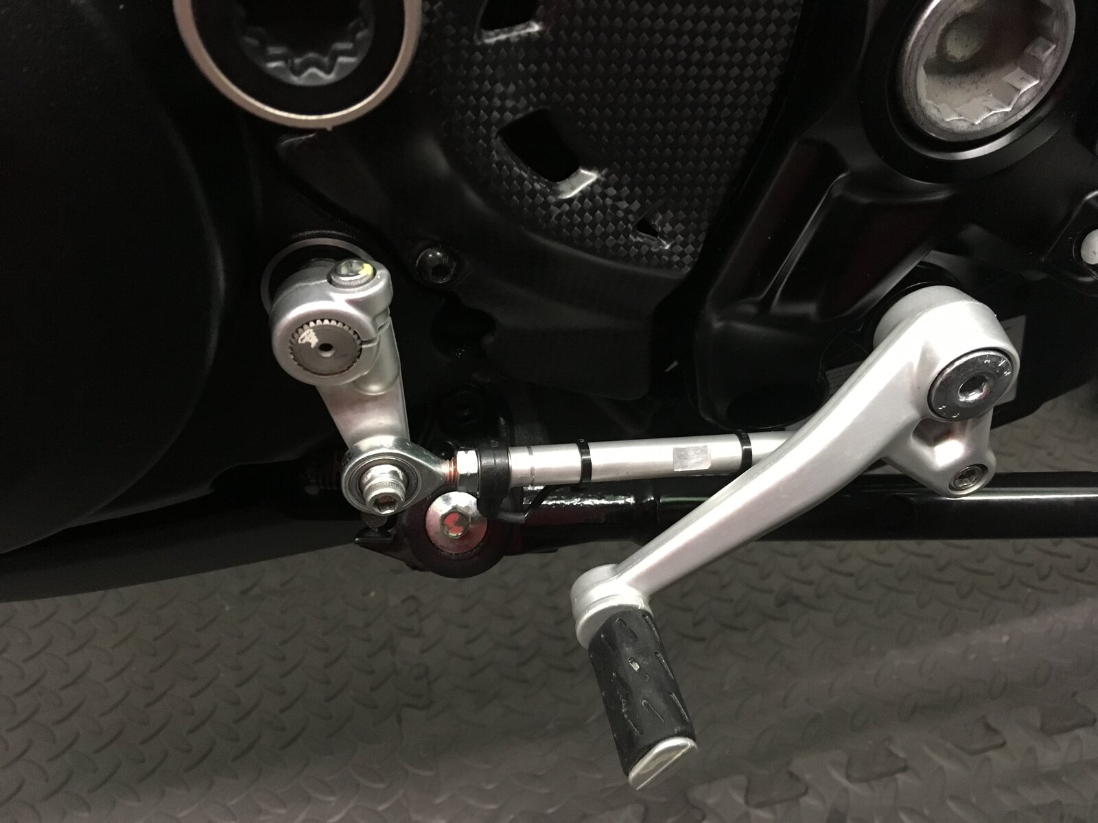

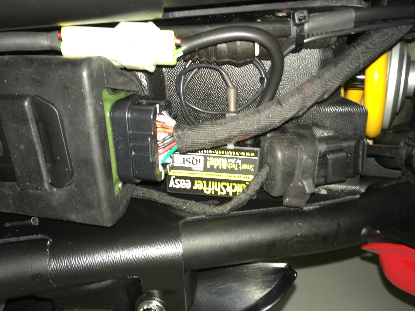

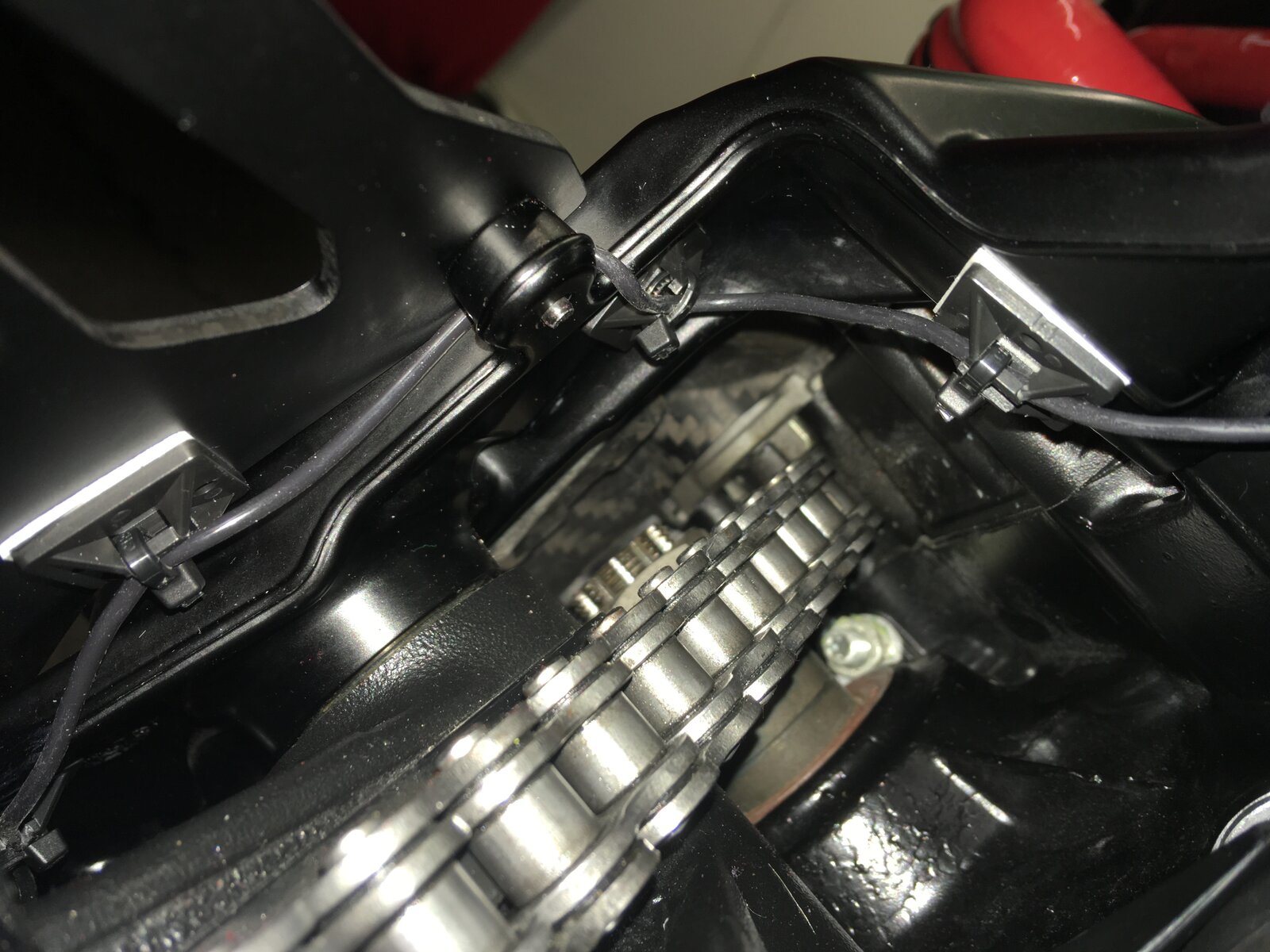

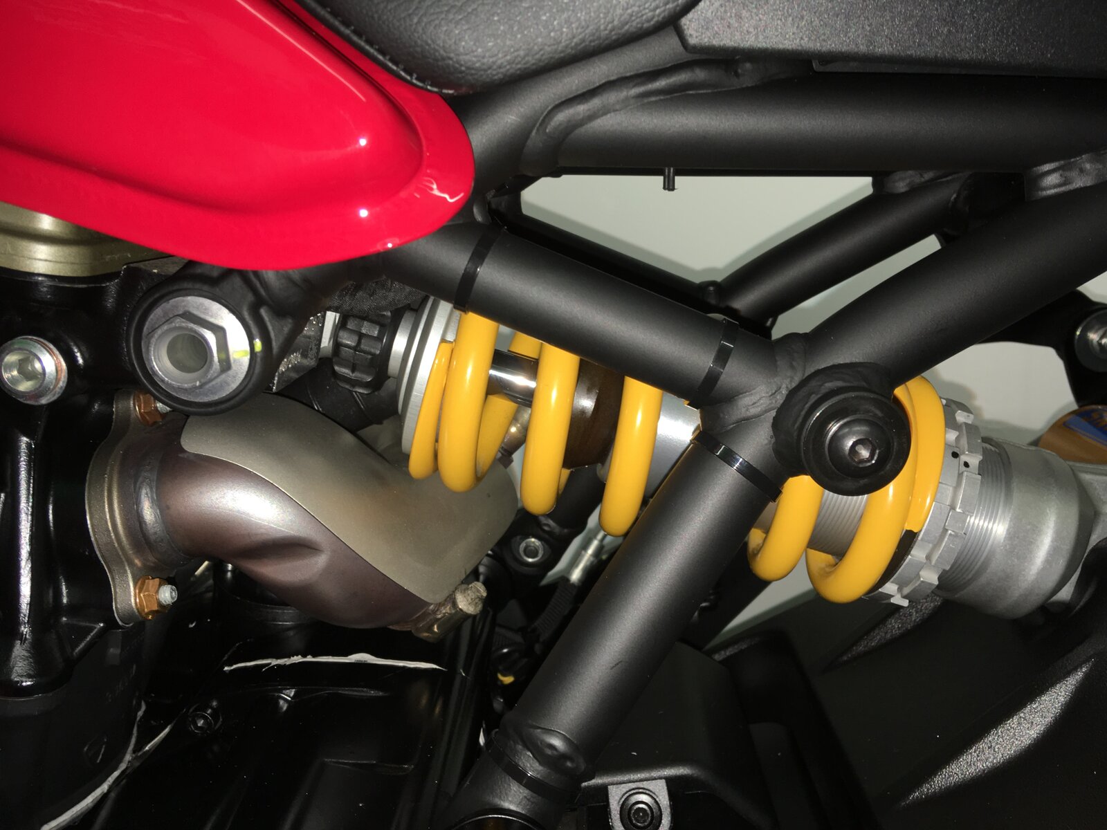

    I fitted one in my monster R but haven’t ridden the bike yet so don’t know it it works yet
    Was easy enough to fit and the app seems very good so hopefully it works well!
    Setting it up on a single sided swingarm paddock stand it pretty frightening...
