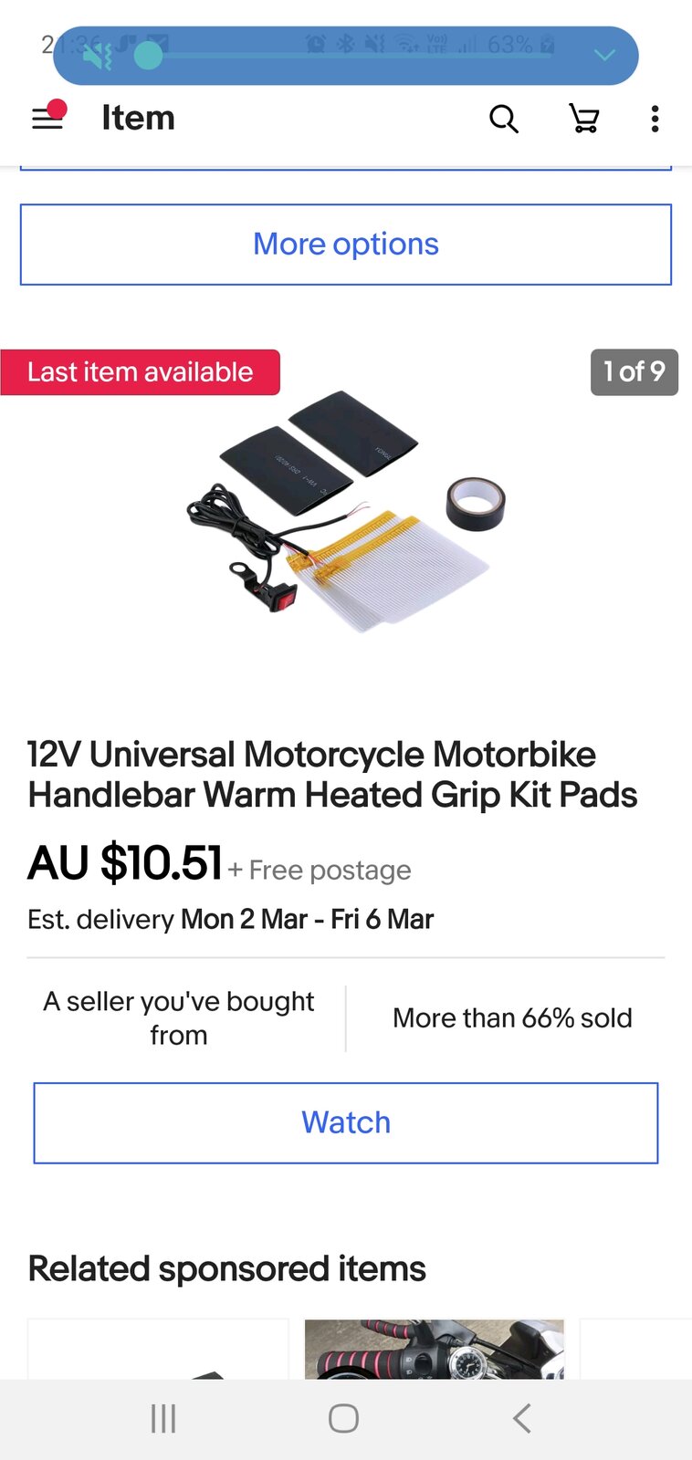

    Firstly the kit on EBay I used
    Some learning points
    The kit has the electrical connections attached to the heating element with a 'stud'. I tried soldering the old wires to these studs but this heats up and the one stud actually came loose as a result.
    Second attempt was to use the new kits electrical cabling, routing that through the grips' cable routing and soldering it to the existing old cabling were I could easily work on it, cable tying it to the clutch and other cabling in front.
    The lh grip is now so awesome I will have to do the rh side was well. Reached 38 degrees in about 2 minutes (infrared gun). Ordered a second kit (cause the stud came loose etc).

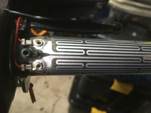

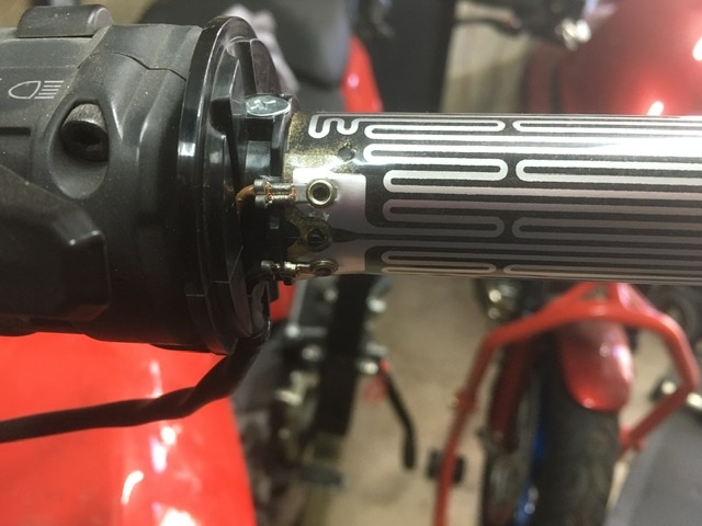

  13. Ok, got the grips off to have a look at the elements as the consensus is the damage is normally pretty obvious.....
    well I can’t see anything anywhere

  19. Yes, grips are off and elements look pretty good - pictures above!
