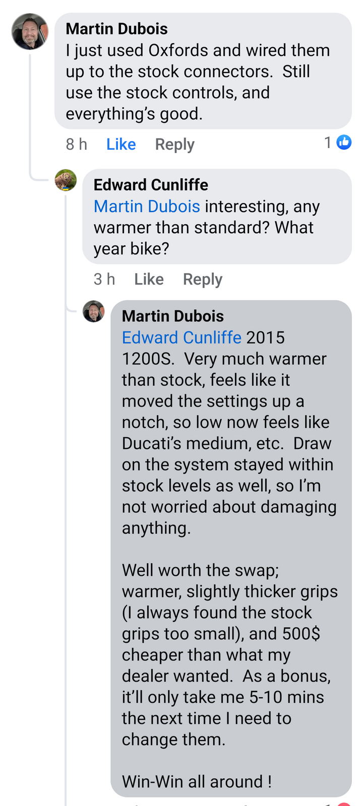

  2. I bought a set of Oxfords for my 1200DVT and wired them straight to the battery, as per the instructions.
    They have an automatic cut-off function once the engine stops, so no constant drain on the battery.
    They were much better than stock - I think they are two steps better than stock.
    Whichever way you wire them up they are an inexpensive and a beneficial upgrade.

    The stock ones are proper crap. Cool to slightly warm at best.
