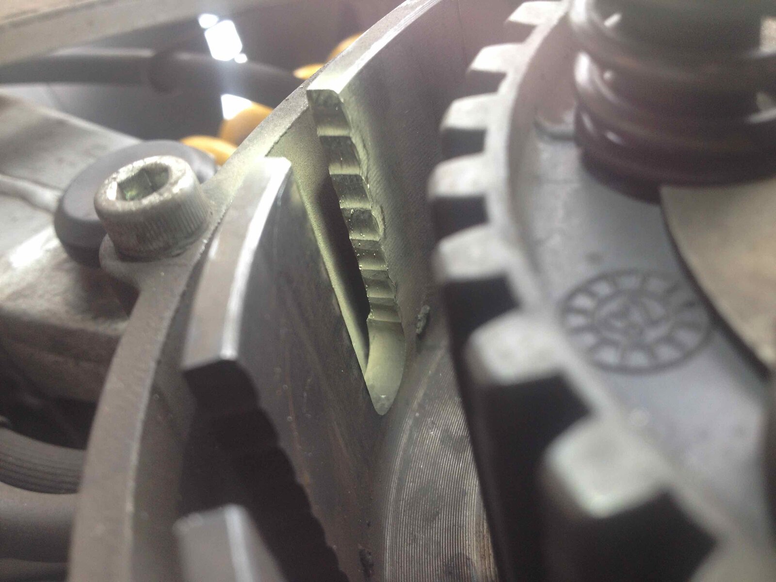

    The point about less push-rod travel is of course true, although I have to say that it didn't lead to any problems when I fitted an Oberon to my ST2. As far as my experience goes, failure to disengage properly is more likely to be a problem if the splines on the clutch basket are shot (see picture).
    IMG_4175.jpg .
