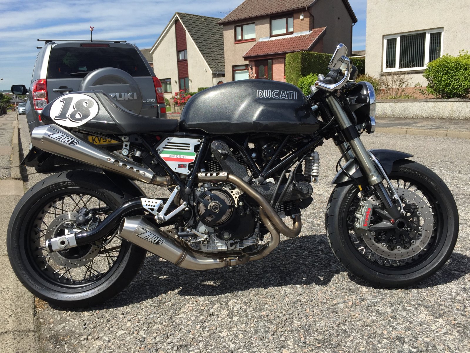

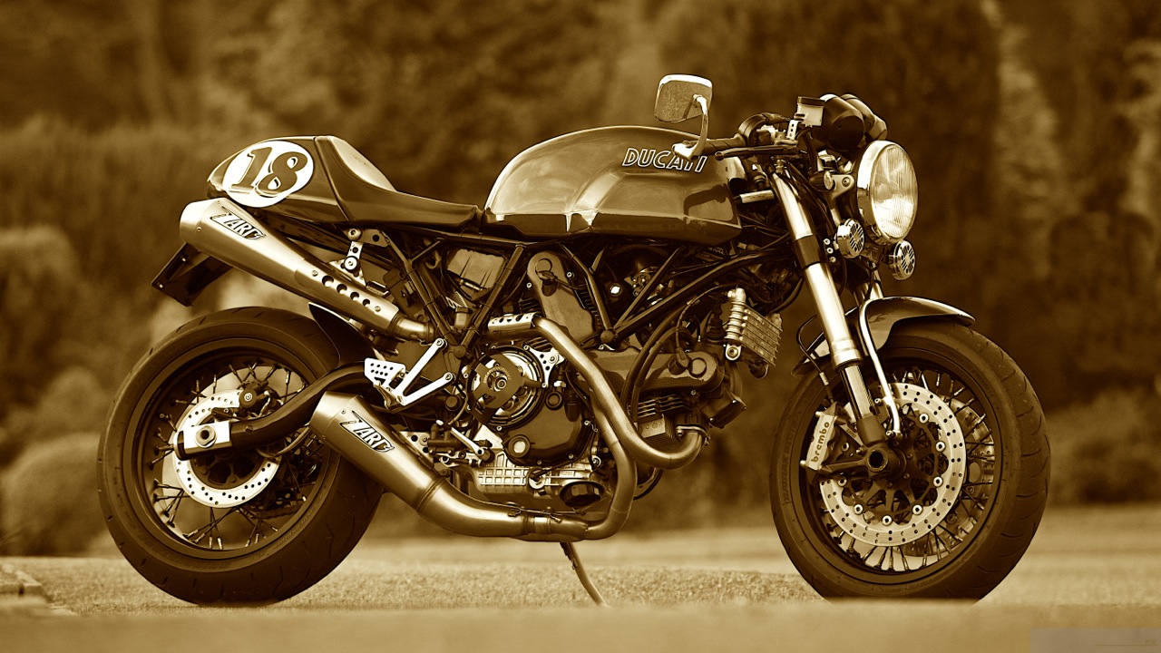

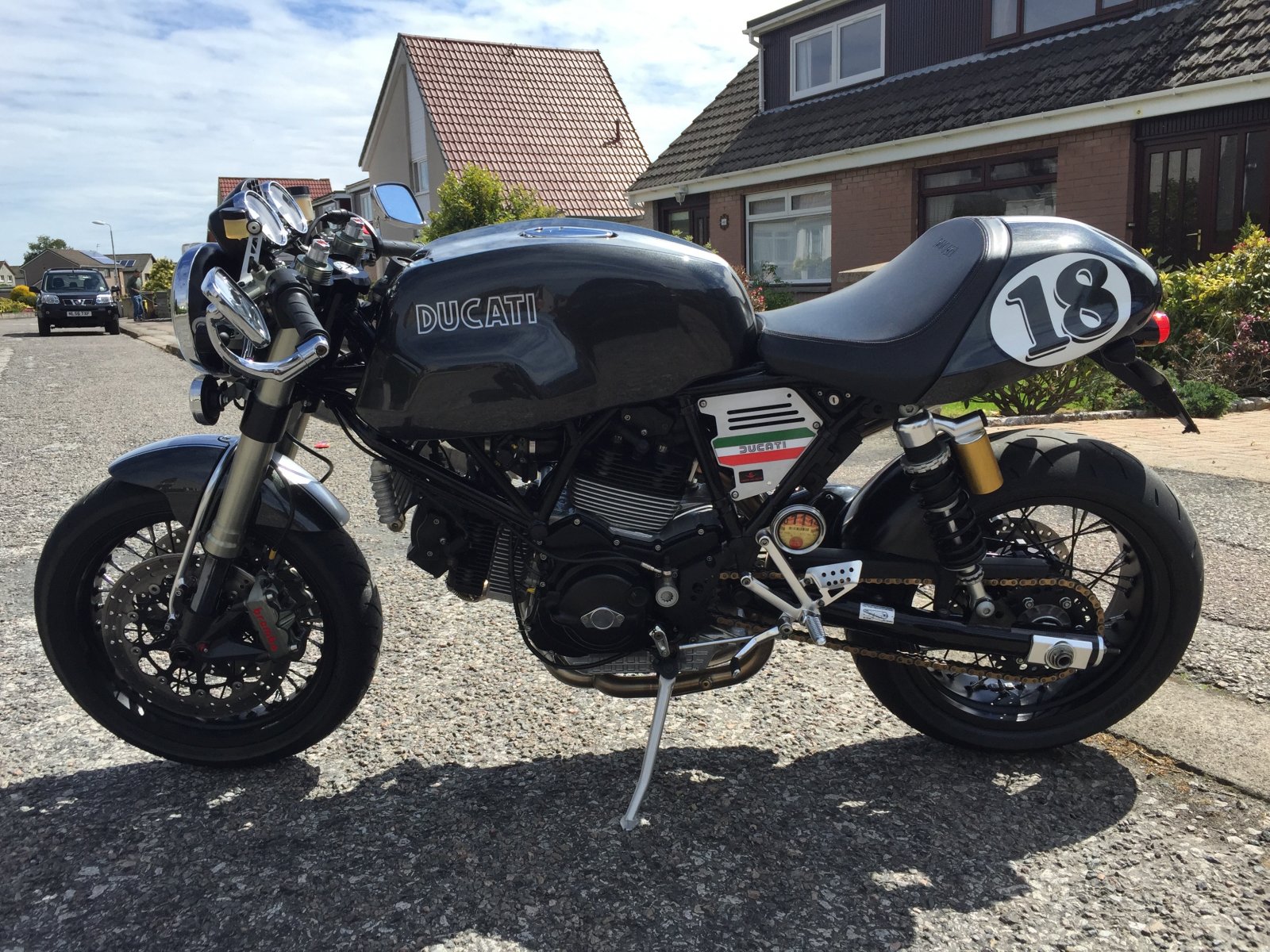

  1. I've had my SC 1000 Sport for 7 years, bought as a standard bike and slowly over time have turned it into what I wanted hope you like it. The best mod engine wise was the PUC2 intake from Intake Express big difference with throttle response power wise I don't know as I have never Dyno'd the bike yet.
    P.S: It is louder than a loud thing on a loud day as well:tearsofjoy:

  2. hello and welcome. Bike looks cool
  3. Welcome to the forum.
    Very nice looking bike. :thumbsup:

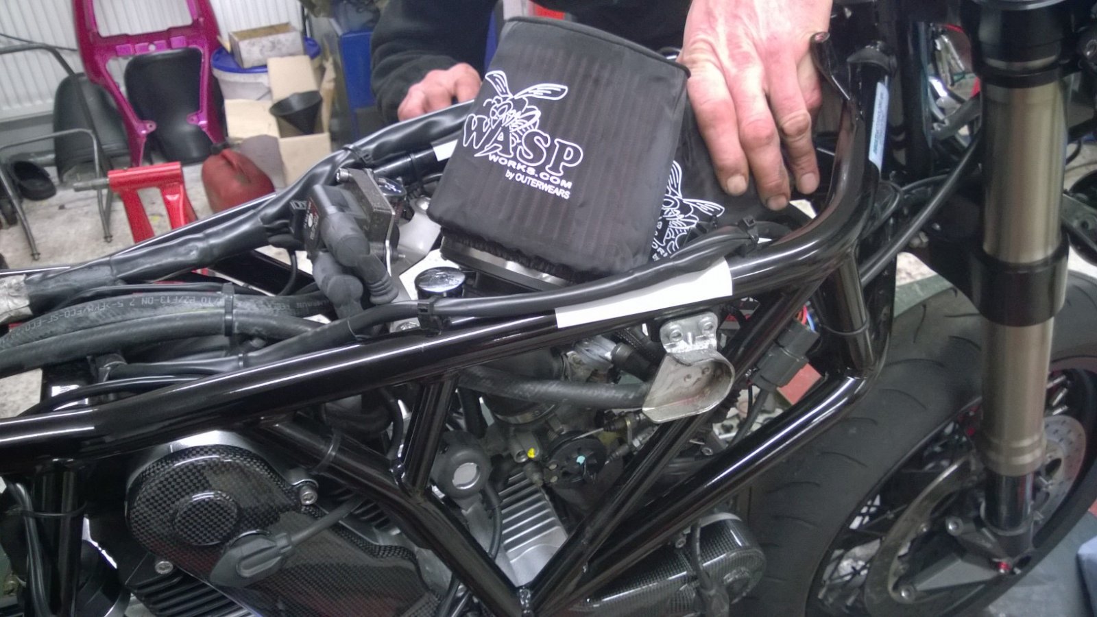

  5. If that's the wasp puk fitted on the intake iv the same , it turns the bike into a snarling thing, in fact due to the induction noise alone I have to wear ear plugs and I don't just mean for comfort , without plugs I couldn't rev the bike out lol. Anyhows looking good.
  6. Yeah it is the Wasp Induction, I know what you mean about the noise it's as load as the Zards:tearsofjoy:
  7. most of us could find room for that in our shed :upyeah:

  10. If anyone hasn't experienced the wasp power up kit ( puk) it replaces the air box with dimpled velocity stacks, a series of k&n filters and a power commander. Mine has had dyno time to map it and the bike is super smooth. The noise is a deep roar that tries to suck out your eardrums hence the ear plugs. The wasp puk is a quality piece of kit but costly. Hey ho.

  15. I think the WASP kit was a waste of money, spent a full day doing dyno runs on the SC and my Monster 1100 Evo, the SC never gained any power, the bike already had Termnis and ECU fitted and standard air box, fitting the power commander and air filters the bike made the same power, torque curve was similar, contacted WASP and sent the graphs, they offered to buy back both kits at half the price plus I was to pay shipping, WASP also sent me a new map for the power commanders but it didn't make much difference, the figures they quoted both bikes didn't achieve, they put it down to standard of fuel I was using and conditions on the day.
