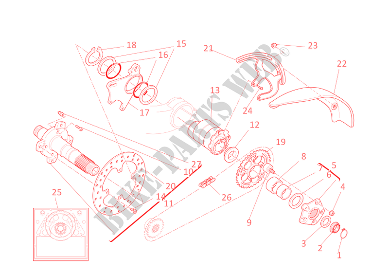

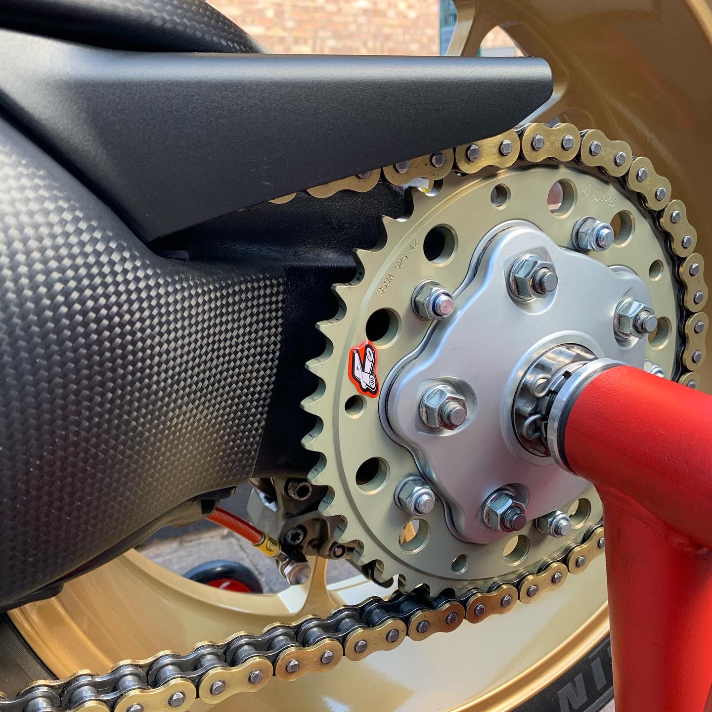

  1. So I just got my first Ducati, a 2010 Hypermotard 796, and I was over the moon with the bike the first couple of days. I had to go away and finally came back to it to check things over properly. To my mistake for not checking it at the sale, I found the chain had way too much play and even side to side movement. It freaked me out so I decided to look at the rear sprocket and found it also had some side to side play.. I took a video of it so hopefully you guys can see what I’m referring to (sadly it’s not allowing me to post it). I’m looking at potential parts replacement and found item 9 to be a suspect on my list (diagrams uploaded). However it may be just loose nuts? Any tips or help is appreciated.. 07EBAB69-7BE2-41B3-AC56-813AD62D237A.png

  7. just to be sure, those cushion things you’re referring to are item 9 in the chart correct? And when you said “chain sprocket” you mean chain+sprocket? Or?

  8. Yes number 9 are the Cush Rubbers. Yes chain, Front sprocket and rear sprocket. My bad

  10. controversial time again, although sideplay/movement shouldn't exist between rubberised cush-drive outer shoulder and rear sprocket, they nearly always end up this way and it's become "the norm"/acceptable unless movement becomes "excessive". This seems to happen more on 2003 bikes onward (for me anyway). Defining "excessive" is the difficult part as you've hit on a really grey area.
    If you manage to master downloading pictures, you could include a close-up, side-on still of your rear sprocket as it doesn't look that worn to me.
  11. Looks like an aftermarket carrier has been fitted.
    I fitted a JT carrier on my 796, and had a little end float on the hub.
    I fitted a 0.5mm ship behind the carrier which sorted the problem.
    See if you can either get a feeler gauge between the carrier and hub or measure float with a dial test indicator, this will let you know what thickness shim you will require.
