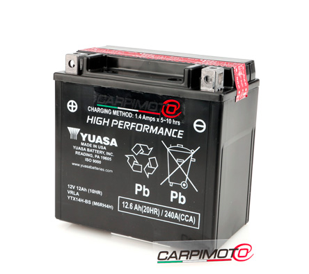

  11. I’m intrigued. I have a 1098 and I’ve just replaced my battery with the yuasa YT12 which has a depth or width of 68mm and is a snug fit with retainer to hold in place. The YTX14 has a width of 87mm so there’s no way it can accommodate nearly 20mm extra. Length and height no problem. In the past I’ve used the YT14 which has 70mm depth but is 20mm higher. Easily accommodated by removing the bottom spacer needed for the lower height YT12. I’ve seen it mentioned before but without modifying the enclosure how does it fit ?

  13. Unless Yuasa have their specs wrong with the 87mm depth there’s no way this battery would fit my 1098. Not a chance. Amongst other things I’m sure the cables wouldn’t reach and the fairing wouldn’t fit. I was tempted with the increased CCA but would love to know if someone has fitted the YTX14 to a standard 1098 for future reference.
  14. Seen many threads where bikers have used the YTX14 in a 1098 with no reference to fitment problems. Would be good to know what the depth actually is from someone that has one fitted. The battery carrier depth just accommodates my 68mm YT12 on my 2007 1098s Tricolore and anything greater would stop the fairing fitting. Maybe I’ve got it wrong but really can’t see it fitting my bike.
  15. The Yuasa specs are correct at 87mm.

    The YTX14 is standard fitment on some later bikes like the 1098R Bayliss and 1198 SP as mentioned already...

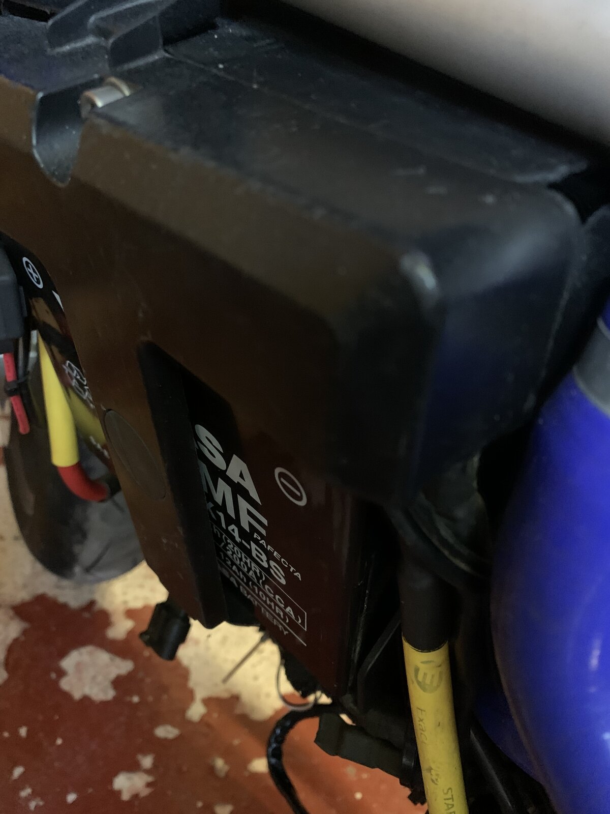

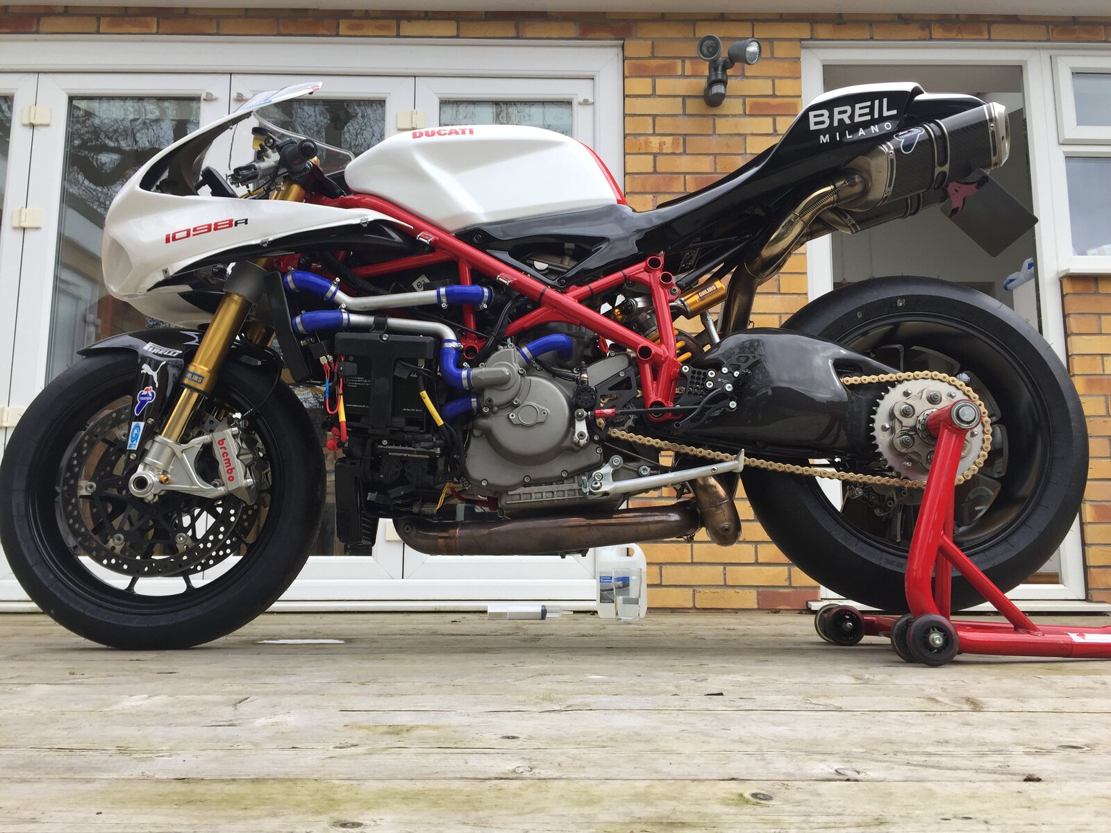

    I have YTX14's fitted to all my 1098R's in standard battery boxes with no issue even with the additional Exact-Start Cable kit fitted...
  16. thanks for that. Looking at the parts numbers they changed the part for the holder after 2007. The last digit after 2007 change from 1 to 2. As you say it has spacers so I can see it would fit if I replaced my battery compartment. Simply removing the spacers to move back wouldn’t work as the cover support wouldn’t fit with the additional overhang. Thanks for clearing this up
    and now makes sense why 1098 people get them to fit but as is I would have problems without additional changes.
