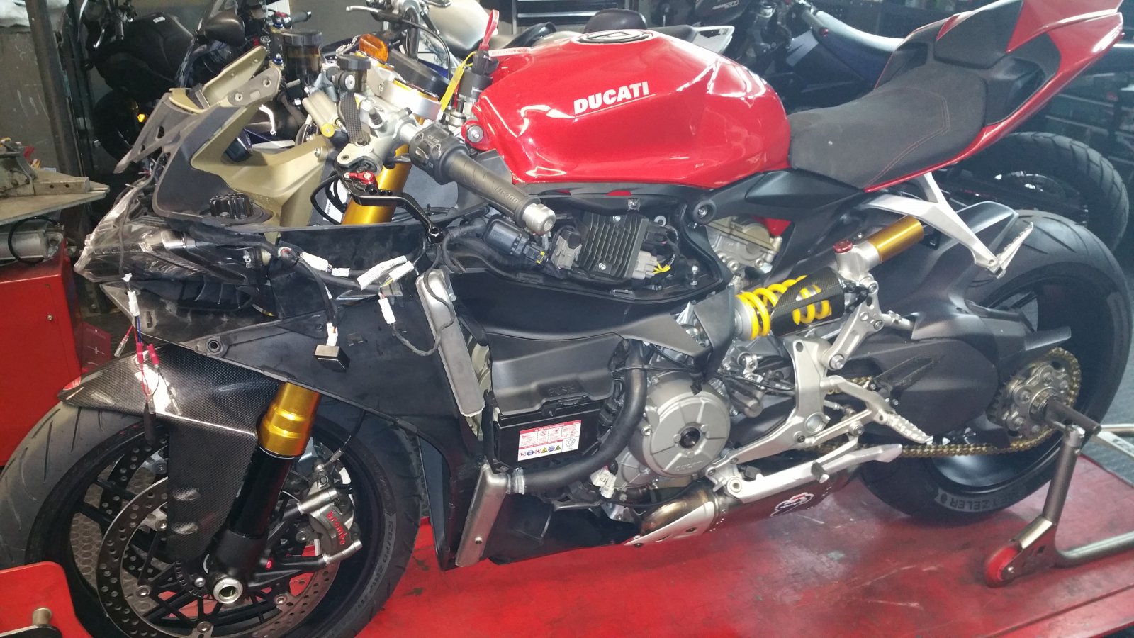

  1. Hey Guys coming close to finishing my 1199 s. :) 95 % completed then my worst nightmare happened!! Tightening one the pinch bolts with the torque wrench, then snap the head clean off and the rest is still in the fork leg. Hands on my face after getting both wheels on the fork.
    Any advice you guys can give me? Thinking of drilling it out with a tungsten bit and hoping for the best.

  4. pic may help. Feel your pain.
  11. Oh, that looks awkward.
    Can we get a side view? See anything from on top or is it blanked off?
  12. wow! what do you have the wrench set to, rear wheel torque?! Can you somehow drill it out from the back?
