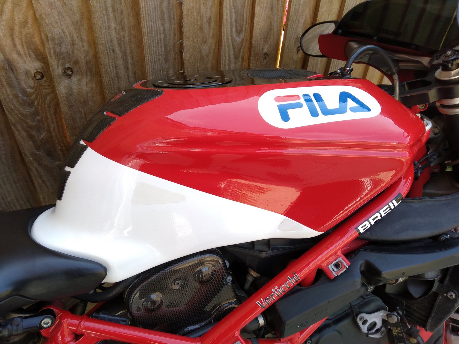

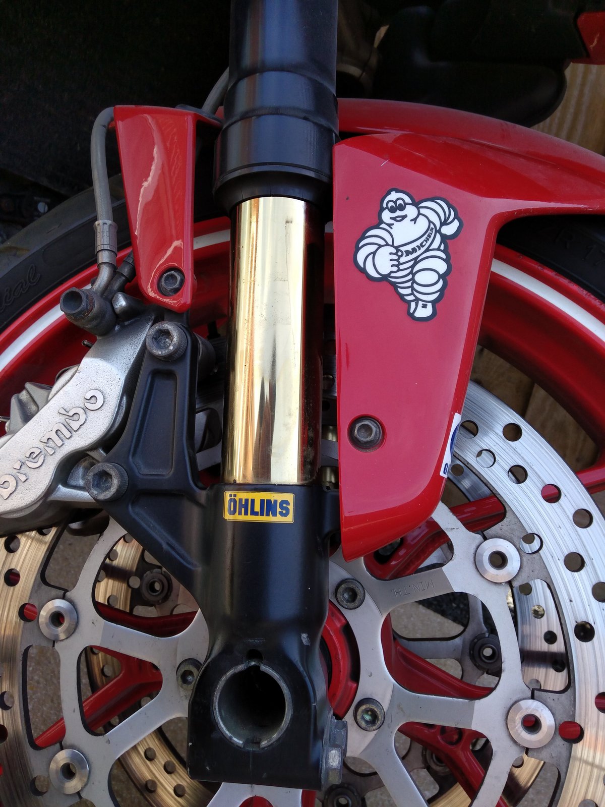

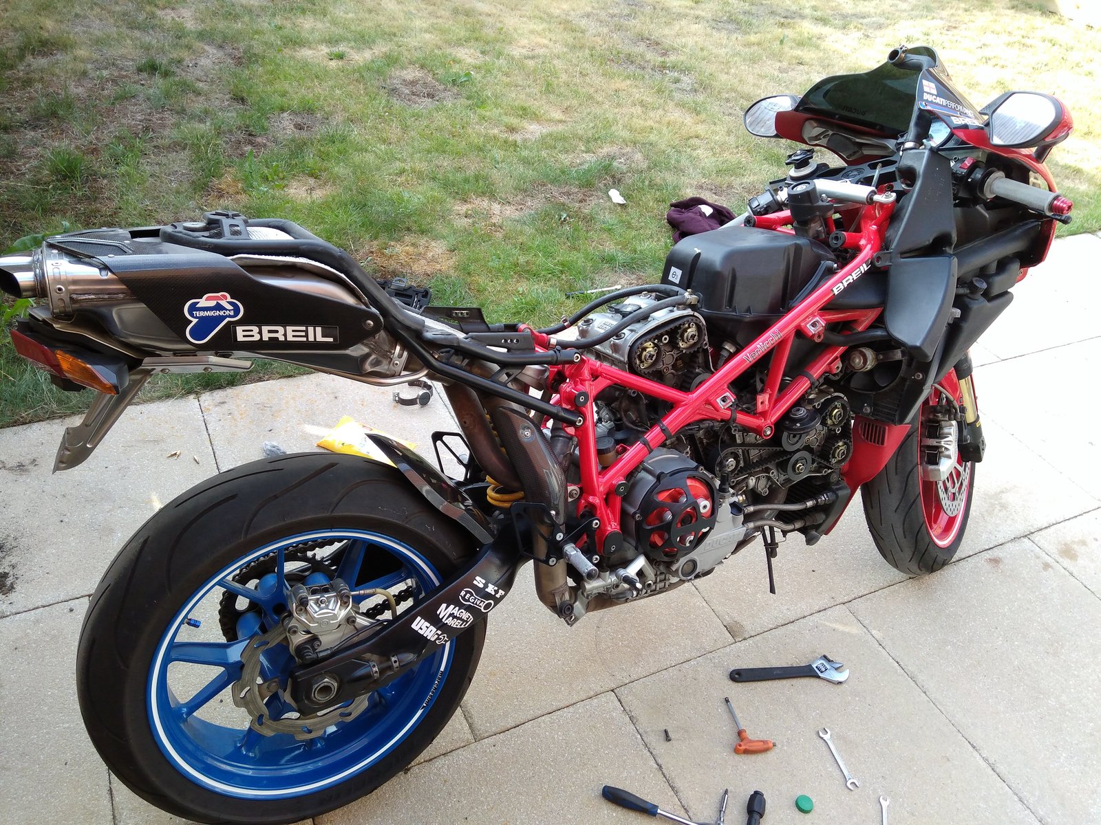

    I've bought a 749s with lots of bits on it, just wondering what brand they are, I have receipts from dealers but they are in generic terms, main one is the ohlins, I'm wondering if they are genuine or just painted. others are the rear sets and the cf tank. may start a separate thread on tidying this bike up if anyone's interested. IMG_20180720_105837977.jpg IMG_20180720_105857905.jpg IMG_20180720_105804210.jpg IMG_20180720_105846257.jpg IMG_20180725_170547352.jpg IMG_20180725_170640481.jpg IMG_20180725_170602392.jpg IMG_20180725_170656554.jpg

  2. Forks are not Ohlins - painted Showa.
    Is that a carbon tank?
  3. The forks and shocks look stock to me and just painted. Maybe they have ohlins internals and the slider a gold nitride finish?
    @RickyX , @Exige have a lot of knowledge on these bikes :)
  4. Yes carbon tank, yup fork sliders are gold, that's what threw me, rear shock is a showa. Cheers

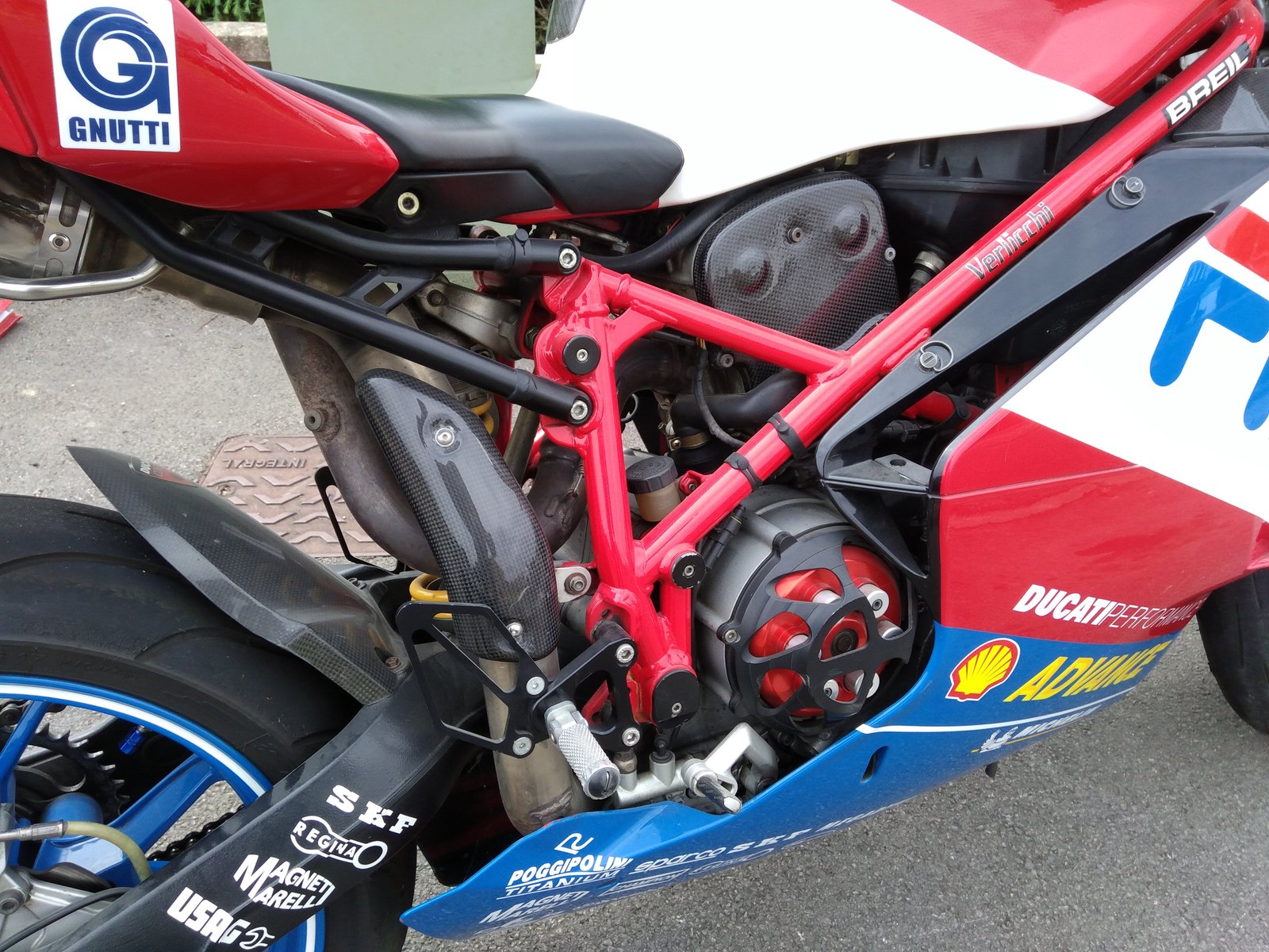

  6. Rearsets are made by RCM and the tank is made by Evotech. Suspension parts are stock as mentioned :upyeah:

  8. So no standard Ohlins on a 749s as you would get on a 999s?

  10. probably but them's not the ohlins forks. The ohlins fork bottoms are noticeably different.

  11. Only the 749R has Öhlins suspension.

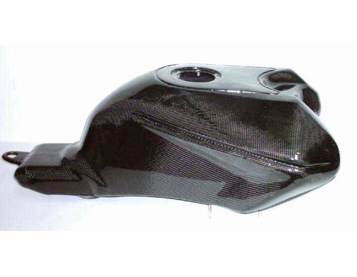

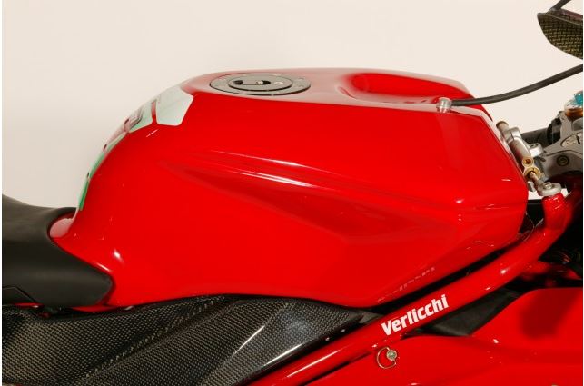

  12. If the tank is full carbon fibre, then I would guess at QB Carbon. They used by stock tank in 2003 for the moulds, in return I got a free carbon tank.
    Hope this helps.
  13. The tank isn't stock shape as you can see... It's an RS look made by Evotech.
  14. Doesnt look like a standard tank shape to me
  15. Who, said the QB Carbon tank was stock shape, sorry if I confused anyone. They used my tank to mould the lower area, mount points, ignition area etc, and then shaped the top section to look like the WSB tank at the time.
    I'm still confident it's a QB tank, will dig out some picks of the tank etc
  16. QB Carbon tank ..... Looks close to me.
  17. You're probably right @Carbon749 :upyeah:

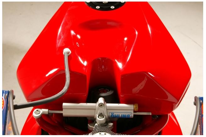

    Looked for a good pic of the Evotech tank and this is the best I found:
  18. Just stripped the bike down, so I can fit new belts this weekend, tank looks like the qb one posted above.

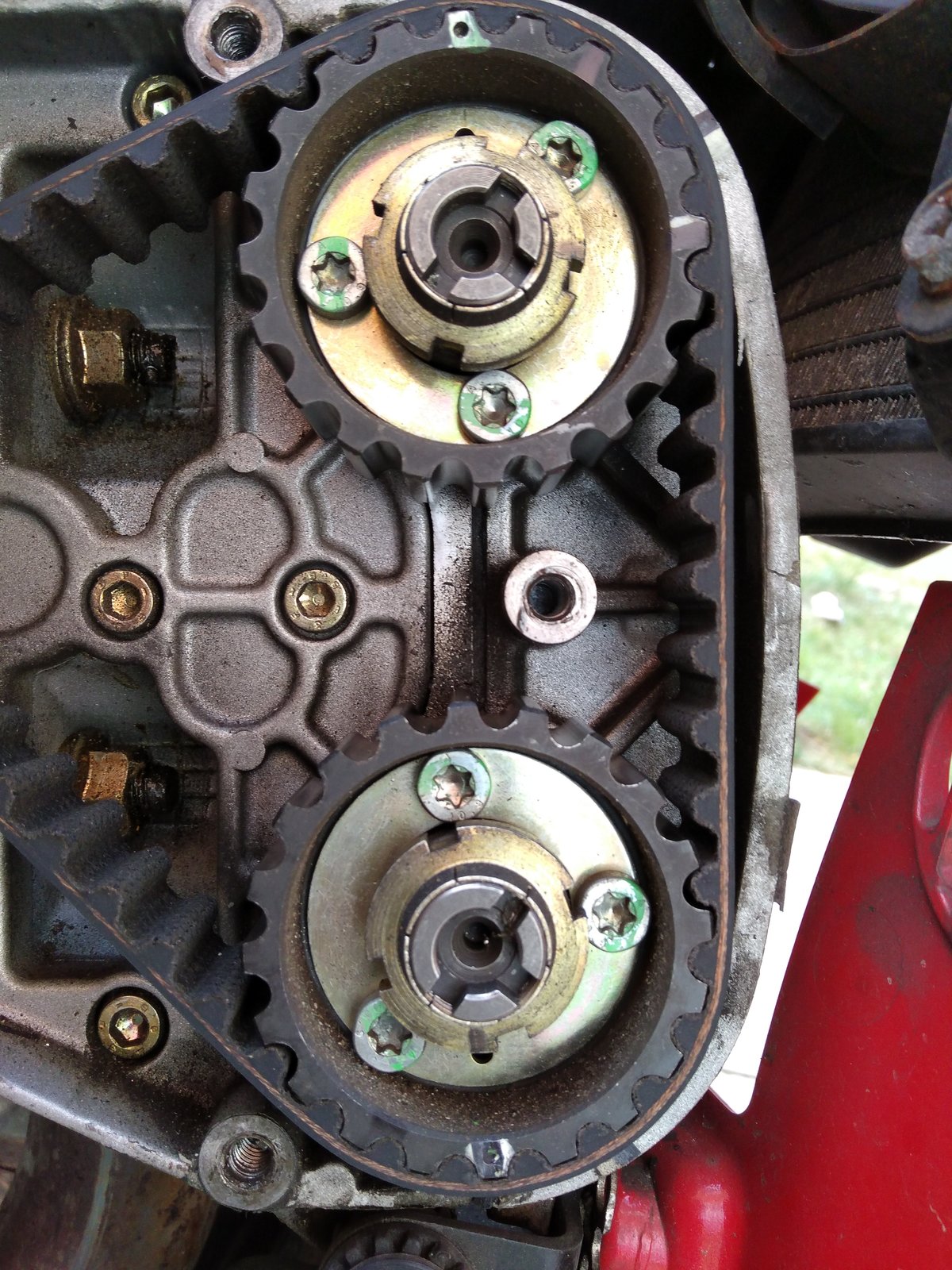

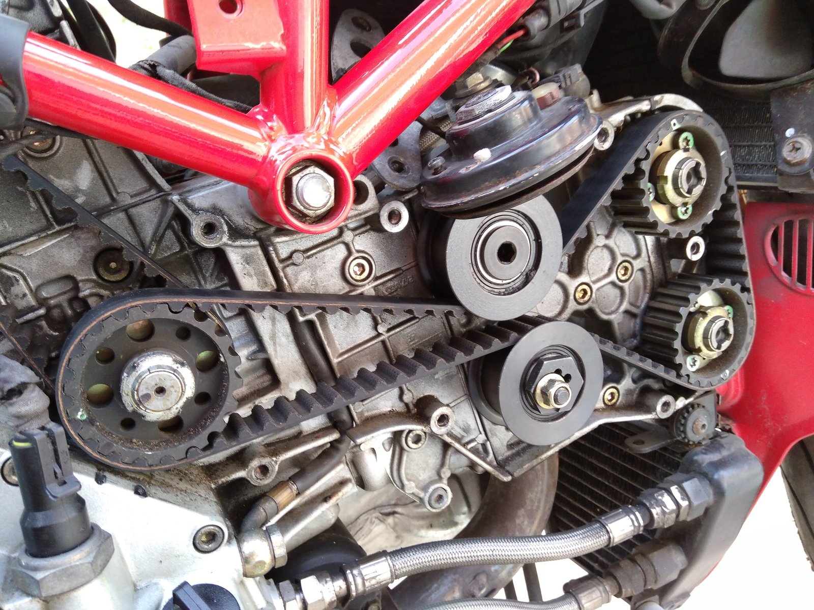

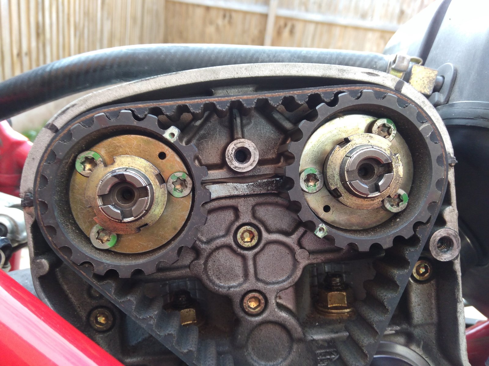

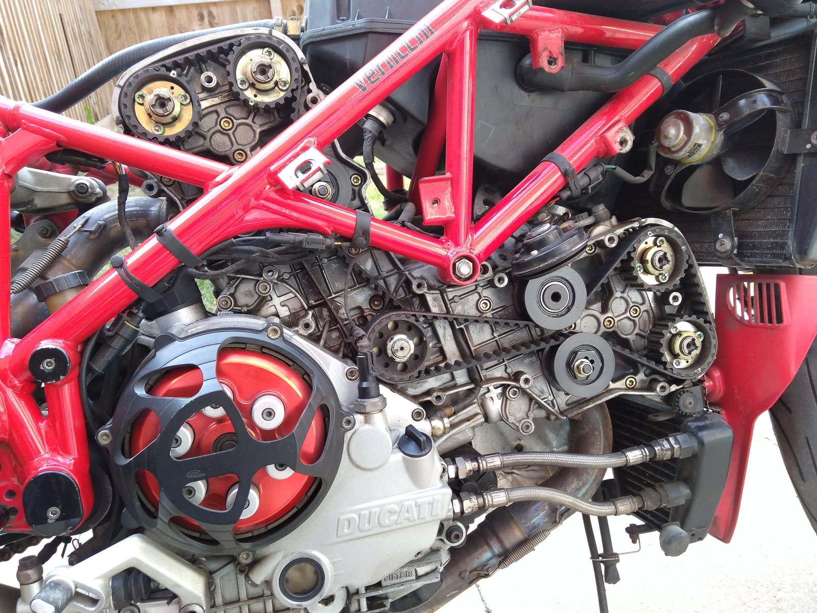

    On another note, the housing for the belts is quite grubby, the cams too, can I use normal degreaser or something less abrasive? IMG_20180726_184556308.jpg IMG_20180726_184436753.jpg IMG_20180726_184444814.jpg IMG_20180726_185000344.jpg IMG_20180726_185004905.jpg Cheers.
