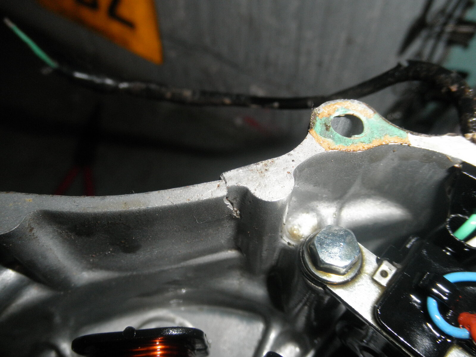

    Problems with a 2014 Honda CRF 125F.
    So we were out a Drumclog at the W/e and my daughter came in dropping oil everywhere after the chain came off.

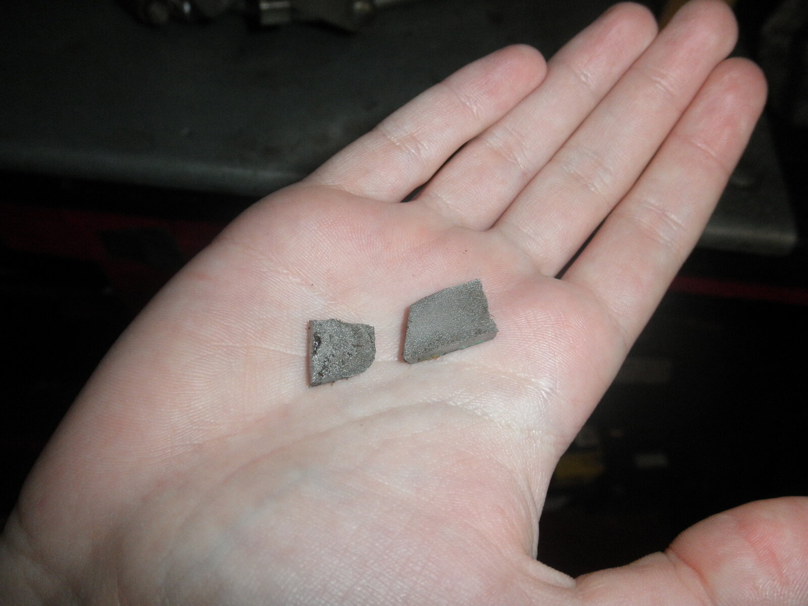

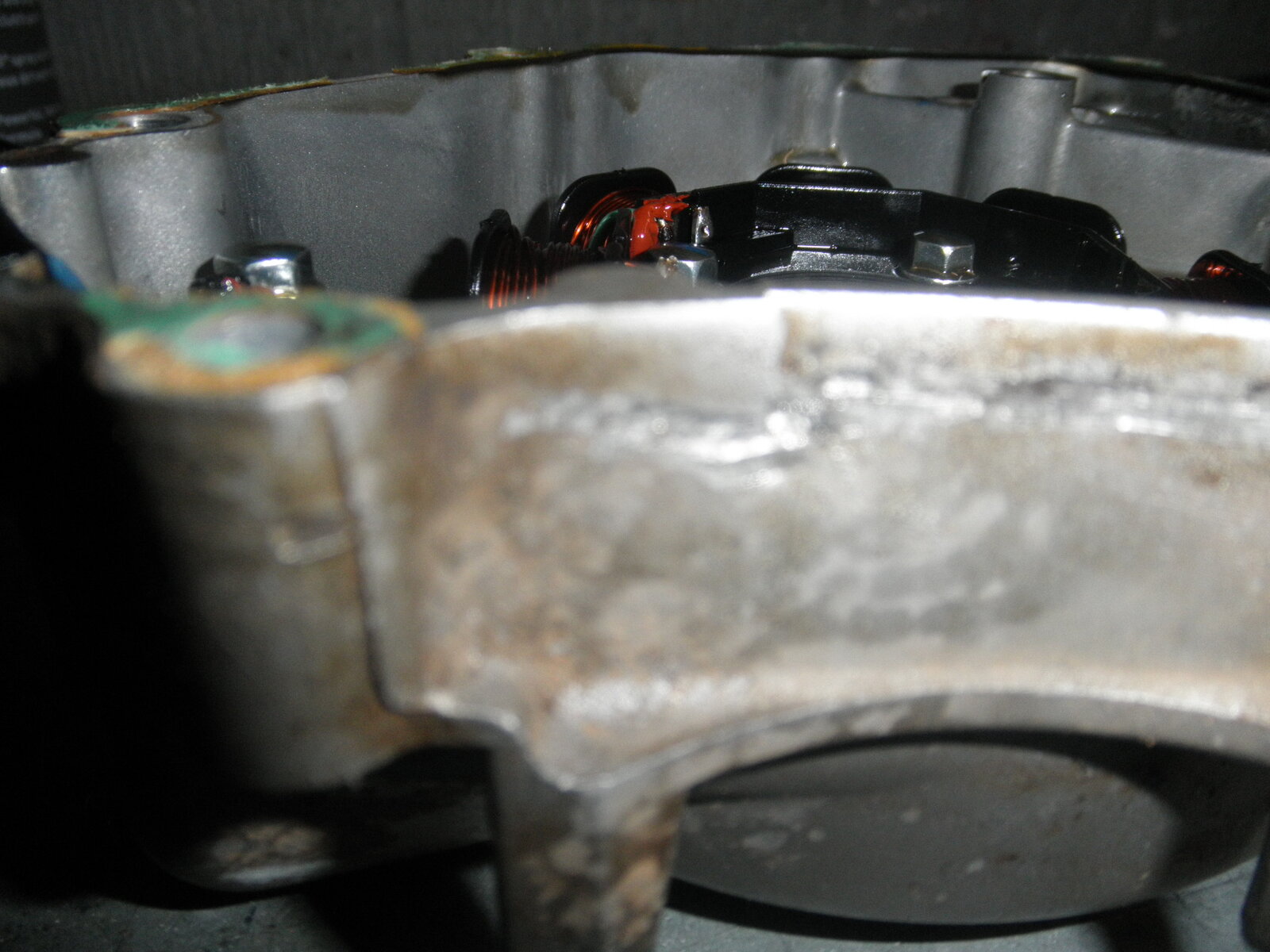

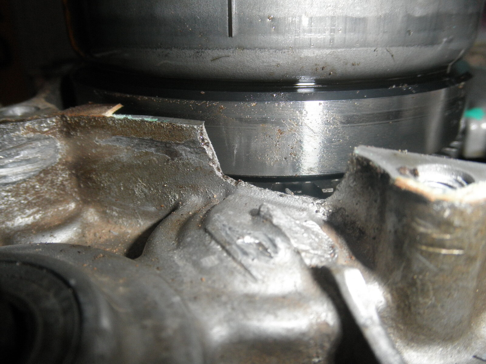

    Subsequent examination show that the chain (or something stuck in it) has taken a nice bite out of the LHS crank case at the mating surface of the generator housing (couldn't have fecked it better if we'd tried!) have a wee look at the attached piccies as a salutary warning on chain maintenance...
    Anyhoo, to all you workshop gurus out there the question is this: Do we think this can be JB welded with the recovered pieces or am I just wishful thinking? The alternative is an entire new crankcase at God know's what price so I am keen to avoid that option if at all possible.

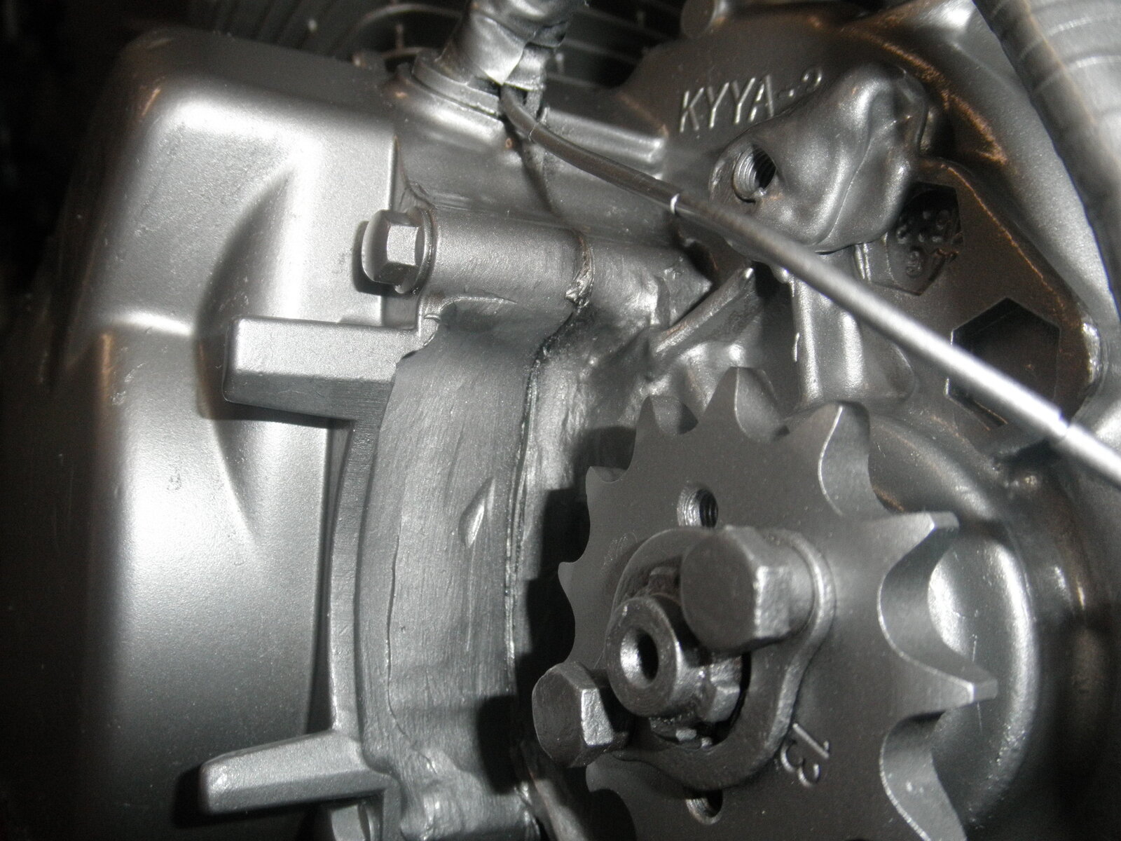

  11. Started today. Deep clean, superglued the two wee parts together for convenience, cut a small strip of metal to reinforce on the outside of the casing, curing and drying over night, JB the fuck out of it tomorrow.
    Question, can JB be shaped and tapped, will it take a dremel with small grinding heads?
  12. Yes it can, if you go steady .

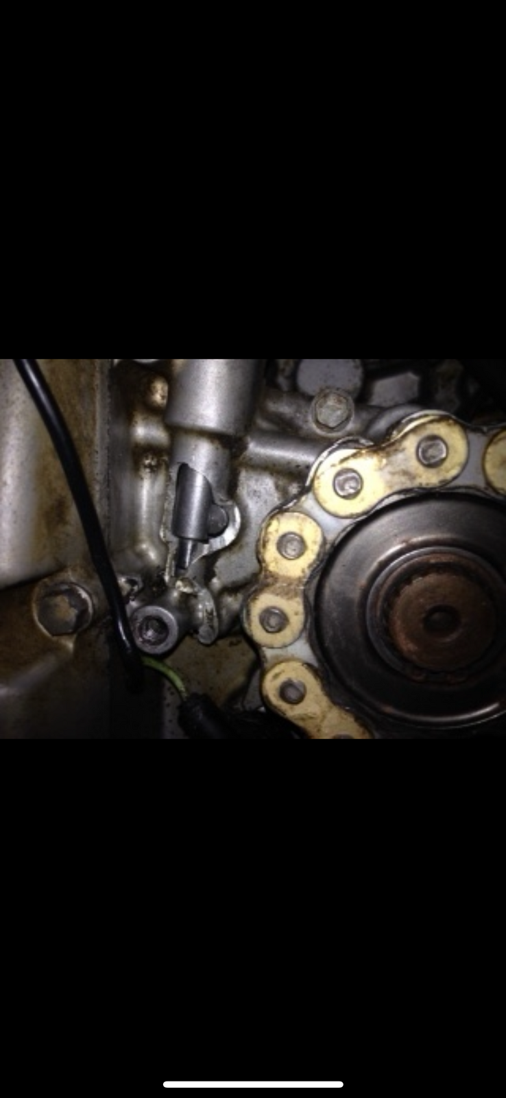

  14. Hey, I had the exact same thing in my KXF, I thought I was honing to have to buy a pair of crankcases.
    However I found a welder ,one set of old boys in Reading, who said he could do it. I said I would need to strip it and he said he could do it I situ.
    And he absolutely did and it still works…I couldn’t believe his skill
