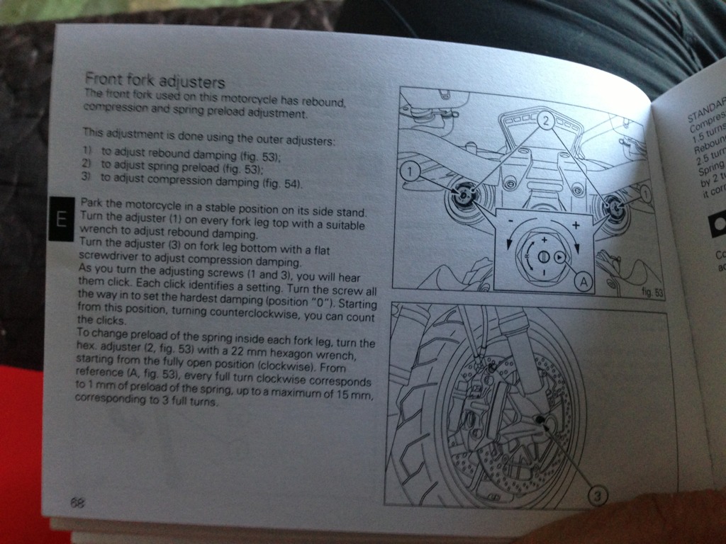

  1. Can someone with an 848 sf please let me have their front rebound and compression settings please. I keep reverting back to mine but looking at all the other sf848 I think I must have a misprint in my book. it is on page 68. Thanks.:upyeah::upyeah:
    You can download online in Ducati UK website

  4. How do you know? What are you looking at that makes you think its wrong?
  5. Because when I look at my standard settings the rebound out screw is hardly out of the fork compared to 4 other bikes I have looked at today. Also looking at the standard settings char has just posted my compression is 2 out and rebound is1/2 out.

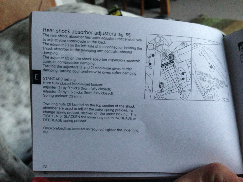

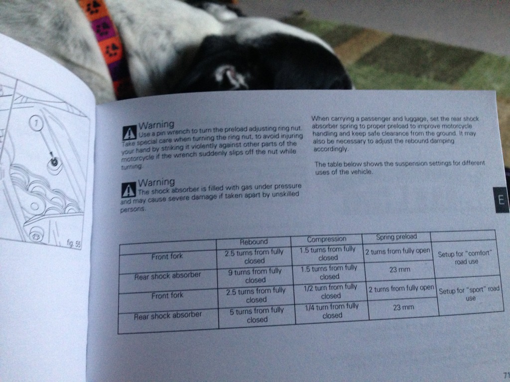

  6. Char thanks I just about got your setting from your book can I have the rear too please? The ducati website only posts for the 1098 engine variants with the corsa shocks
  7. That's much better.:upyeah:
  8. Thanks.......................... You are a star.:upyeah::upyeah::upyeah::upyeah::upyeah:
