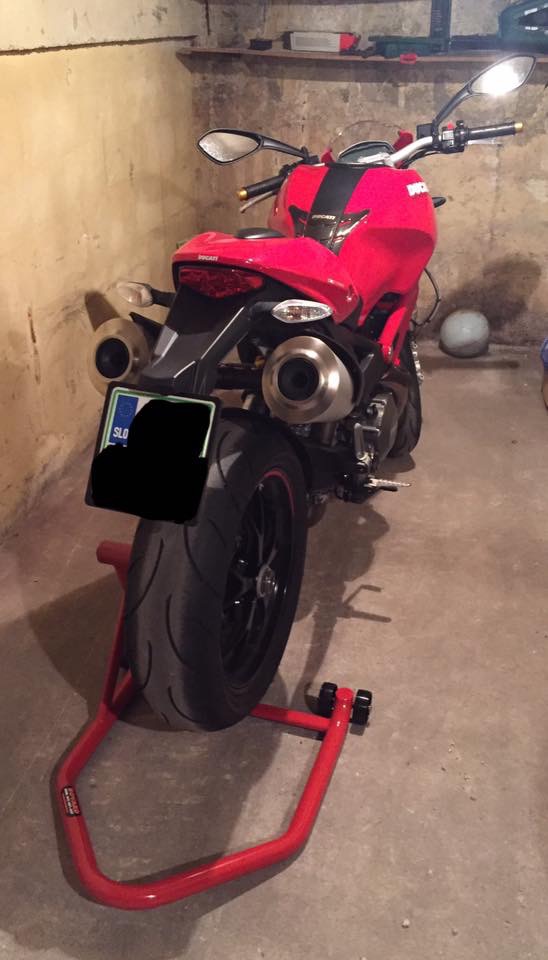

    I need a small help. If anyone know, what is size of Diavel’s y.2011 rear wheel hole? I need to change an axle on my rear mono paddock stand for bigger axle and don’t know the diameter I need! Can not check it, because I will pick bike next week!
    I am thankful for any help,
    Don’t mind on photo is Monster
    Cheers

  5. Indeed....I think bolt is 55mm and the hole diameter is 40mm.....but I am not sure...definitely bigger as at Monster :)
  6. The pin diameter of the sssa paddock stand for the Diavel is a nominal 40mm. I have 2, 1 (plastic spindle) measures 41mm and 1 (metal spindle) measures 40.5mm. Andy
