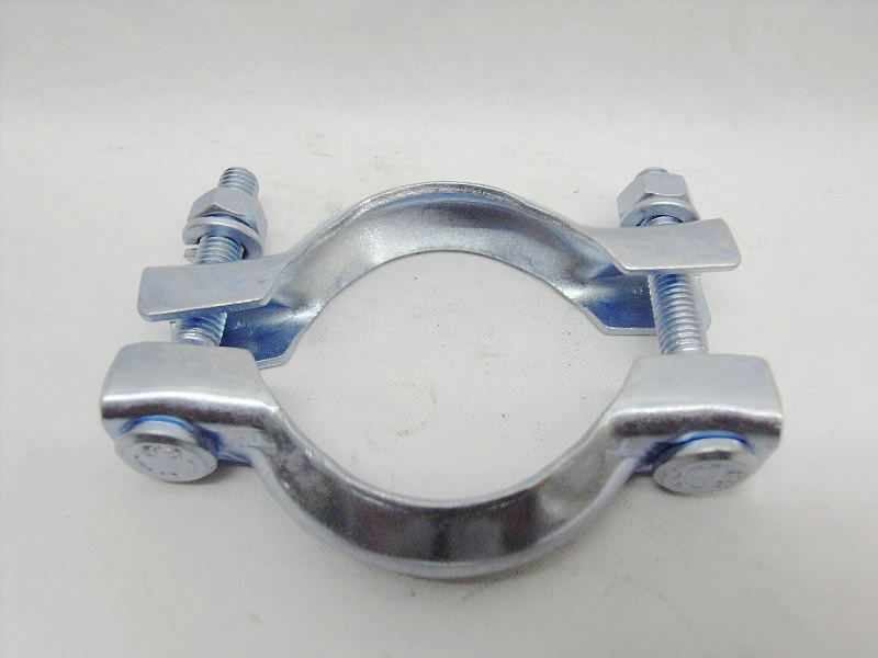

  5. can you get some sort of exhaust clamp round it . that will give you something to get hold of.
  6. emery...good idea :upyeah:
    clamp..good idea but i don't have a puller set either...:upyeah:
