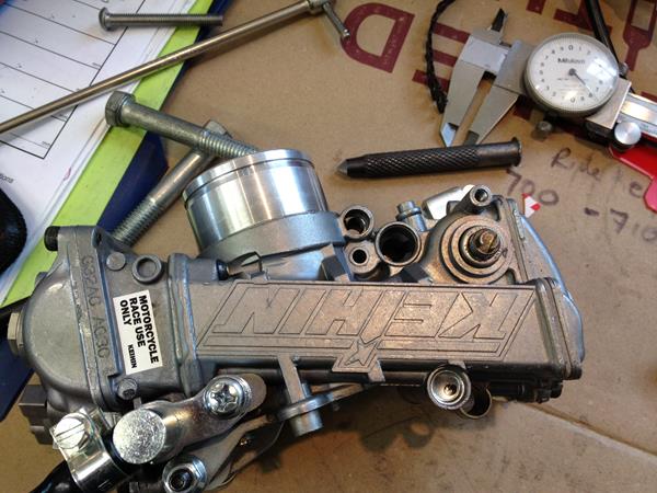

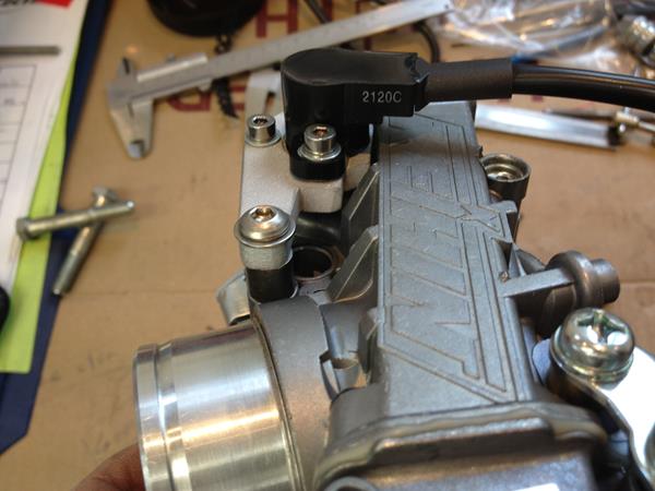

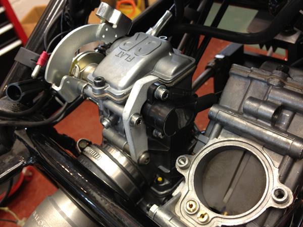

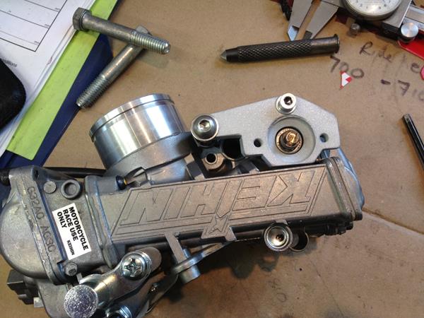

  4. It's a Keihin branded TPS, fits onto the end of the throttle shaft. I had to change the shaft for a longer one - TPS was supplied with the shaft and a bracket although the bracket wasn't substantial enough for my liking so I made a new one.
    Some pics;
    Fitting it allows another 'dimension' in the ignition map, meaning you can get a different advance based on throttle opening and RPM rather than, at the moment just RPM. Made the throttle response much less on/off whilst not losing the ability to just whack it open and get full throttle immediately.
    I got the TPS from 'Frank MX' in Holland; http://www.frankmxparts.com/ price was reasonable and he was very knowledgeable and helpful.
