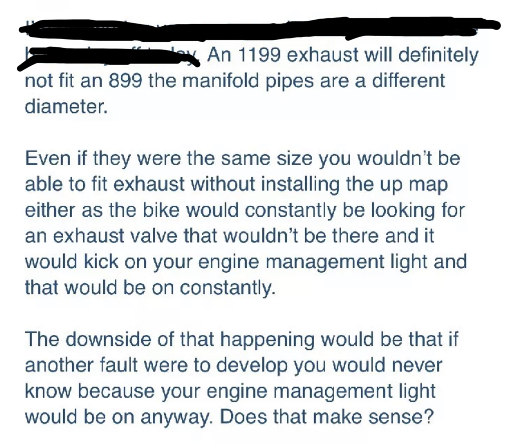

  1. A chap contacted a main dealer to ask if the 1199 under belly pipes I am selling would fit his 899. This is the expert technical advice he was given:
    Now, correct me if I am wrong, but an 899/1199 do not have a manifold (it has headers), the manifold (headers!) are irrelevant anyway as this just bolts to the clamp after the headers meet (the same type and size on 899 and 1199), and because it bolts on after the clamp/valve, there certainly won’t be any errors from a missing valve, because you don’t touch it!

  4. But they aren’t different diameter. Sure, the Termi full system is a bigger diameter, bit the flange with 3 bolts after the flapper valve that the silencers bolt to is the same on the OEM 899 and 1199.

  8. Thank you! So it will bolt on, and the other scare story from the dealer about the flapper valve is irrelevant because it isn’t touched.
  9. Maybe it was the question asked? Maybe the question was replace the system, ie from the heads all back, so it would affect the valve.
  10. Just to clarify too. I had a 1199 with termi which was written off. I replaced with a 899 and the cans swapped straight over. I simply had to swap the upmap with a member on here.
  11. Not really. The answer is super confused. Either you’re fitting the silencers only, which might have meant the header size is a problem (even though it isn’t), or you are putting a full system on which causes the flapper valve error (which is easily resolved without an upmap).... you can’t have both problems regardless of what question you ask... just a load of confused nonsense, at least half of which is incorrect.
