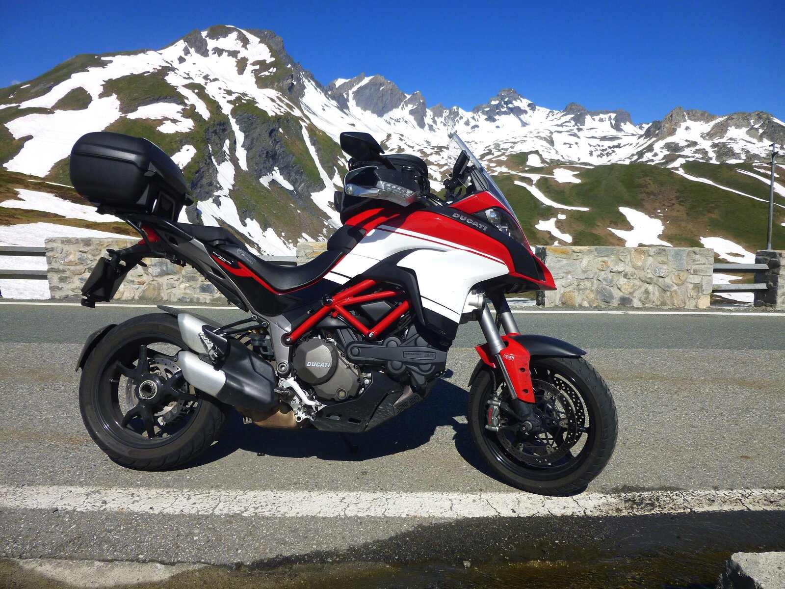

  9. It is an S version with Skyhook (no problems once the shock that was replaced), LED lights, plus heated grips, the paint was done by dream machine, also had Ventura Shield on from day 1. Another pic below - I took the comfort seat and running lights off, but I do still have the rear rack (Hepco & Becker one). If you buy the bike you can have it if you want it.
    It's also a D-Air, which is usually worth a premium, but I didn't pay any extra for it as it was the only one they had in stock. I bought it new from P&H in Crawley. I traded it in at Pro Twins in August last year but I think the milage was a bit high for them so they sold it on. Was used for commuting for a year or so and then mainly touring trips to Europe.
    Issues
    (these were all changed under warranty):
    D-Air sensor
    New rear shock (£1,800!) as there was a break in the wires on the old one (dealer probably damaged it during a service). PS the new one was much better, so I think the old one had an issue. This was only done June 2018
    New fork seals (July 2019)
    New Exhaust cat as the flap had stuck (Early 2018 I think), I fitted a DUC-EE eliminator (which I will be selling as I found it doesn't fit my 1260)
    I think I had a fuel sender and possibly heated grips changed?
    Feel free to send me a PM if you want more info. It will probably want an annual service by now, but the big (£1,000) was done just before I sold it so it doesn't really need one.
