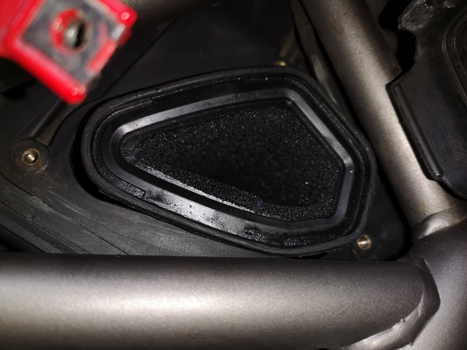

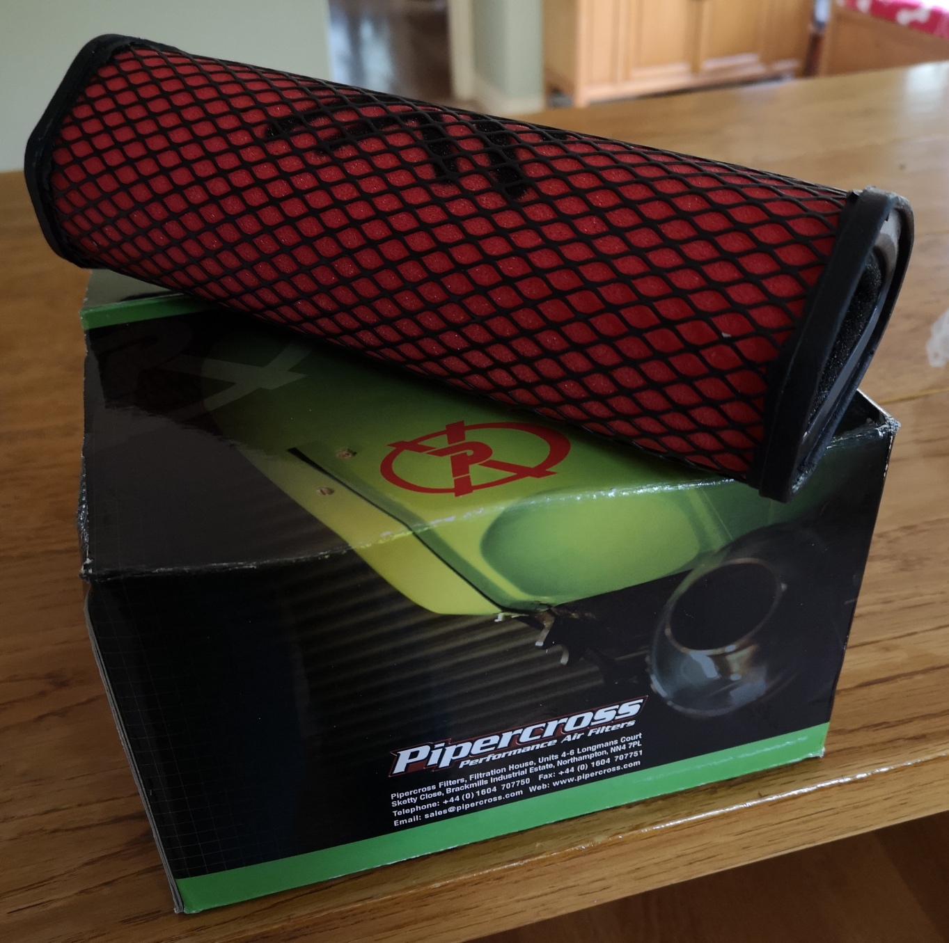

  10. 2010 with 34k miles:
    • Dash - Still on original, some light bleed but didn't get worse over time.
    • Fuel gauge sender replaced once
    • Heads replaced
    • Forks still on original seals
    • Still on first replacement chain & sprockets but nearing replacement time
    • Engine case flaked and replaced under warranty, other side started flaking recently so fitted R&G engine cover whick is an easy solution.
    • Swing arm paint is just starting to bubble....
    • Engine goes like it's in it's sweet spot, a little noisy now the Mivv Suono has lost it's wadding.
    • Just changed the air filter for Pipercross at £42 - highly recommended - Note that it can be changed without removing more than the one black side trim, if you are careful with a long allen key!
    Overall, what a fantastic bike it's been from 2010 until now. Up to Scotland for a trip in a couple of weeks.
