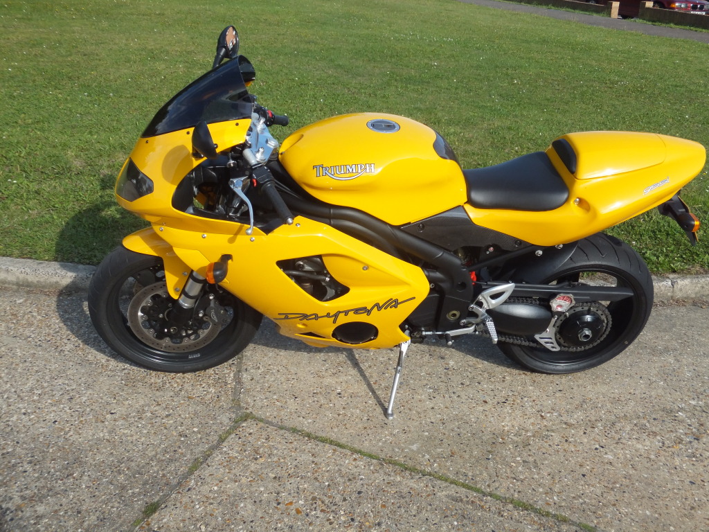

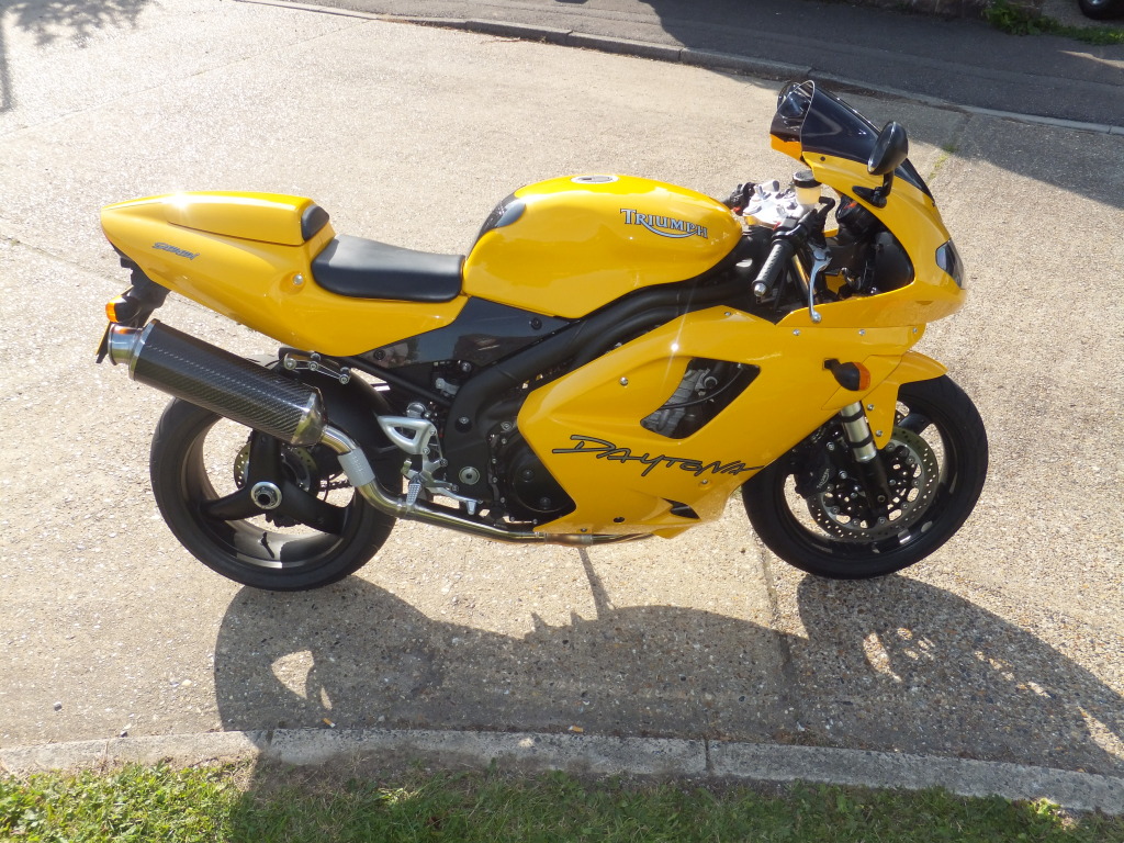

    Think you might've seen my yeller one at Bury Hill a couple of months ago?
  10. look nice in yellow :upyeah: my yellow one is now white tho.
