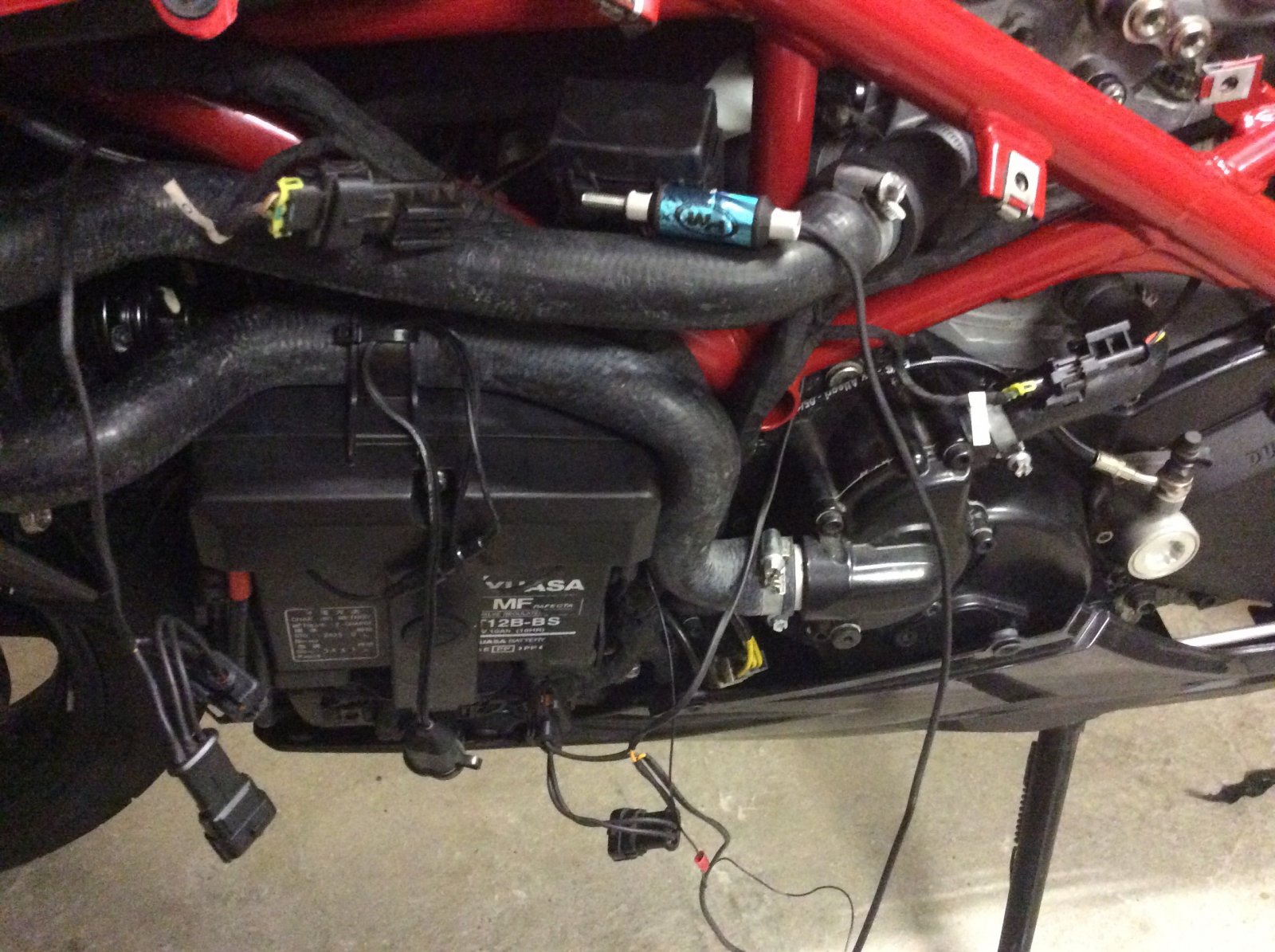

    Fitted the unit it to the bike but now it won't run. It was a second hand unti without instructions. Tried fitting the loom plug on each cylinder in case they are firing order sensitive. The QS is grounded directly to the batter. The bike tries to turn over and sounds as if it's only one cylinder that's firing. I do not have the sensor connected to the shift rod or rearset.

  2. There are a lot of connectors that are disconnected in the picture ? - all should be connected or you will have an open circuit, essentially what the QS does when you press it. It will not start if the circuit is open. Likewise if you remove the QS and leave the loom in place the bike will not run without fitting a bridging plug to the end where you removed the QS from.
  3. Hi,
    The picture was taken to show that I didn't have the unit installed. Everything was connected when I first tried to start the bike. From what you have said noting would happen if there was an open circuit. The bike was trying to start.
