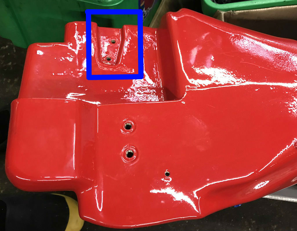

    I'm in the final stages of re-assembly of my 2012 HM1100. I'd really appreciate help with two sets of brackets that I can not locate:
    1) The bracket that sits under the battery to which the rubber strap securing the battery attaches (see blue square in attached image). HM69_battery_bracket.jpg

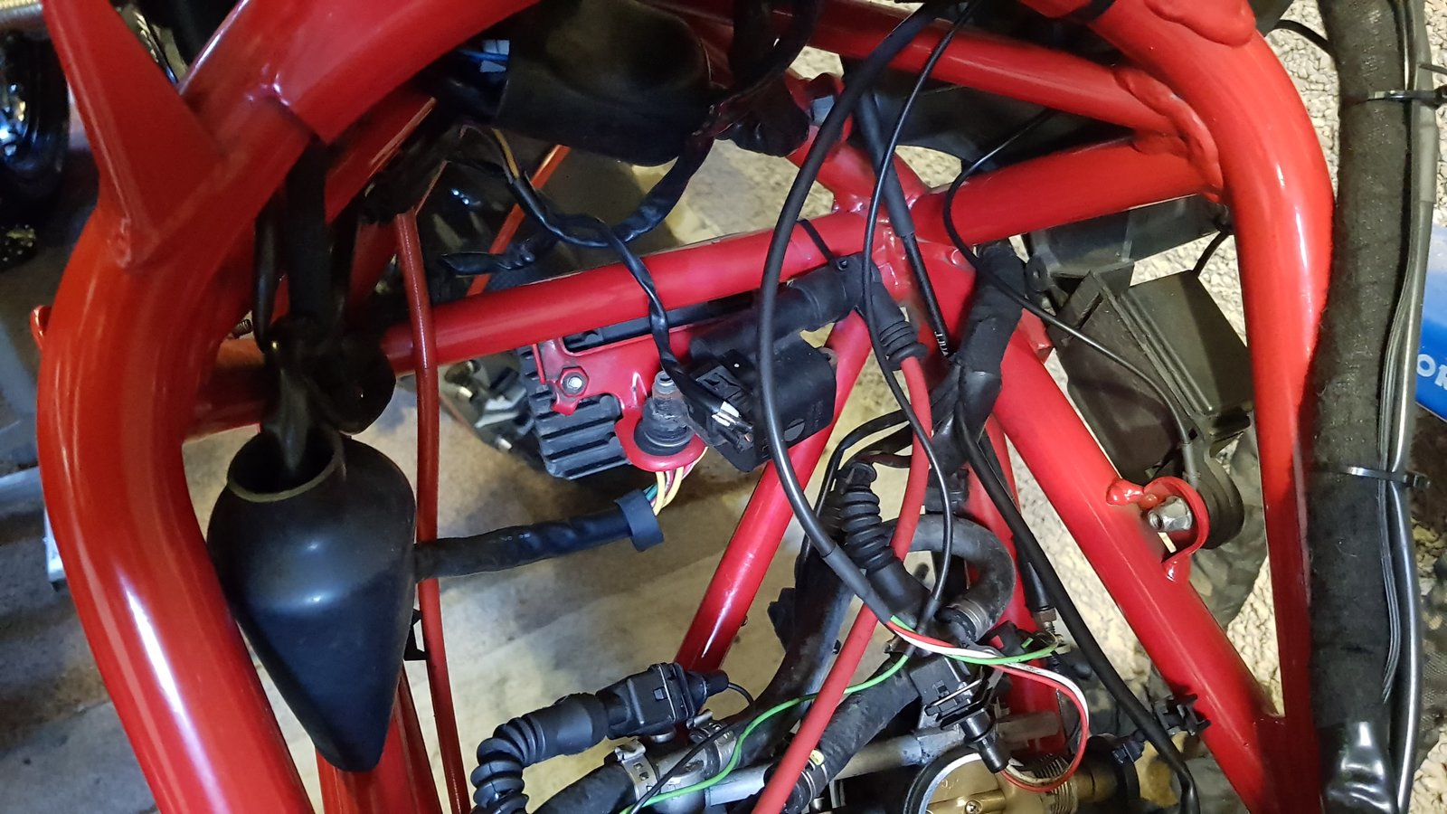

    2) How does the front cylinder coil attach to the tank (or airbox).

  5. Front cylinder coil is at the front if I'm mistaken...
  6. Where your talking about is a rectangular bar with a hook on the end which the rubber strap hooks to..
  7. With regards to the front coil....mines got velocity stacks fitted so I had to "find another place for the coil" which I did....the only problem is I can't go anywhere near the garage today on pain of death as I was out pretty well the whole day yesterday getting the hyper engine split...
    When I get in there I'll take a photo of where mine is (the front of the bike is still relatively intact!)

  9. Here's the location of mine...
