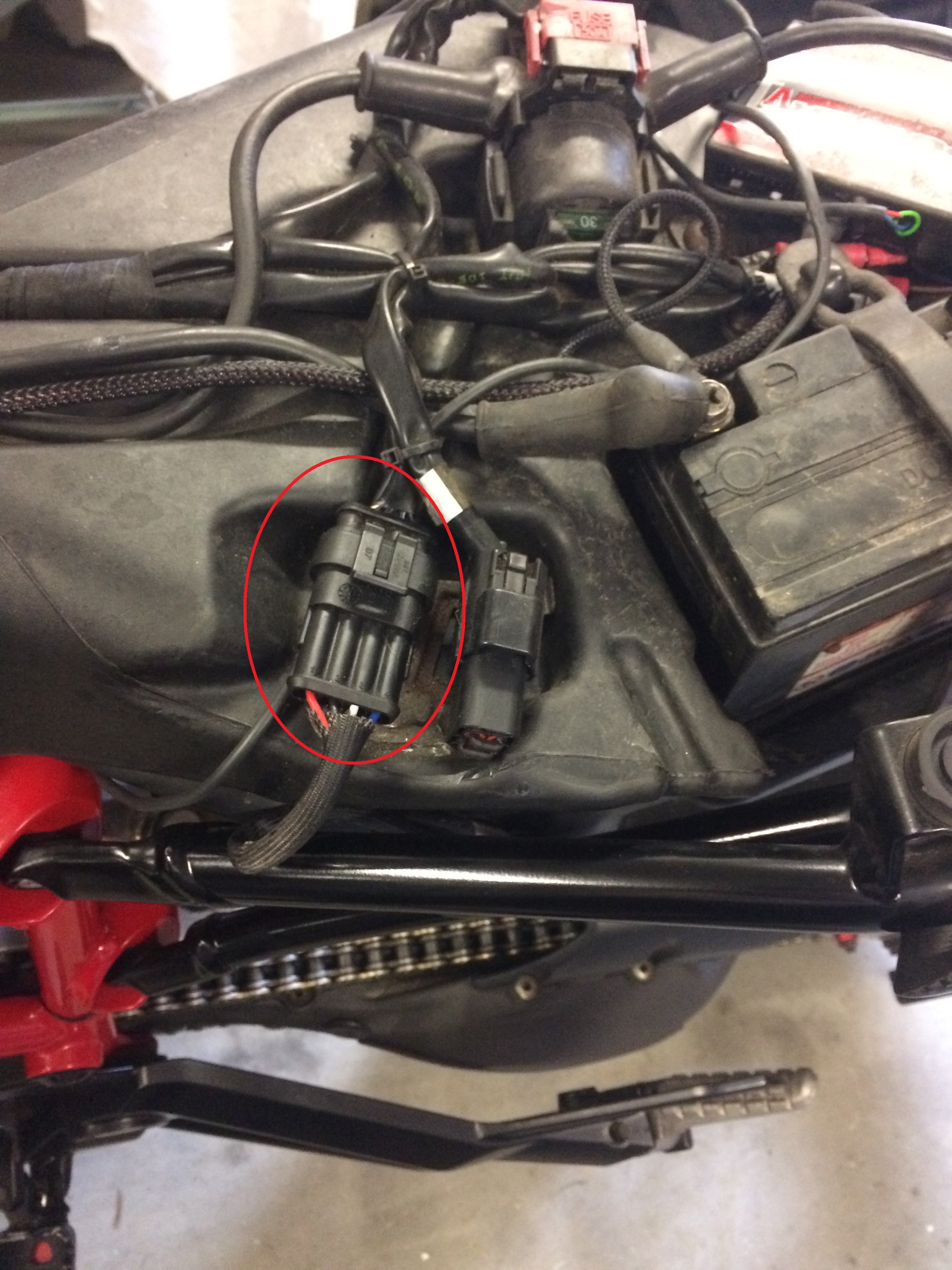

  2. Try unplugging and reconnecting the fuel pump connector a few times, I have a similar issue on my 796 however it occurs when I wash my bike. For some reasons the terminals on that connector like to get corroded (despite being "waterproof"), after reconnecting the connector a few times the corrosion seems to wear off and it works fine. I'm not sure why spirited riding would have an effect on this but it's worth a shot [​IMG]
