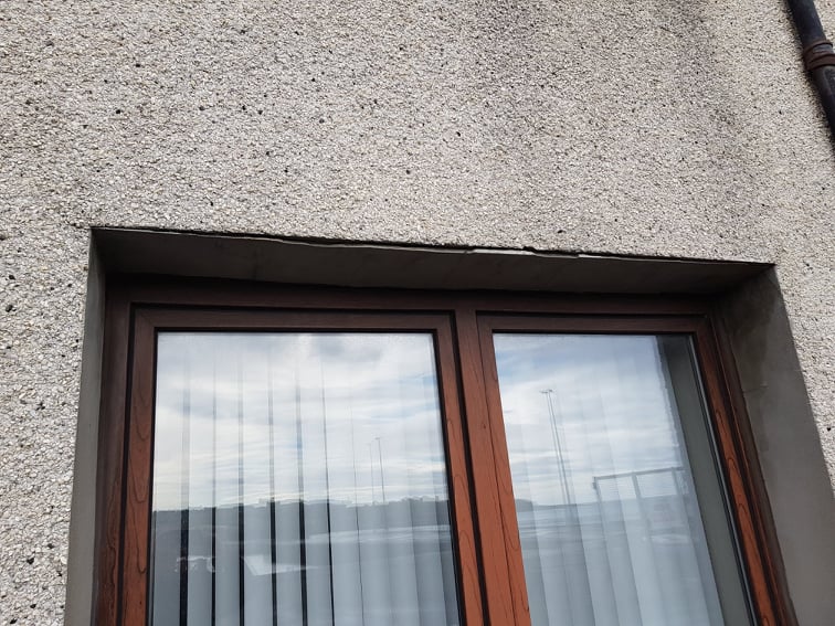

    Looks like my Stone built house may need the living room window lintels replaced, How much approx is this likely to cost?????? Also as I don't want to be in the dark and would like to know exactly what im been quoted for what questions should I be asking the building company while there here?
    Its a stone built house, Wall is 650mm thick, I believe the lintels in there at the moment are steel which I believe are rail tracks???

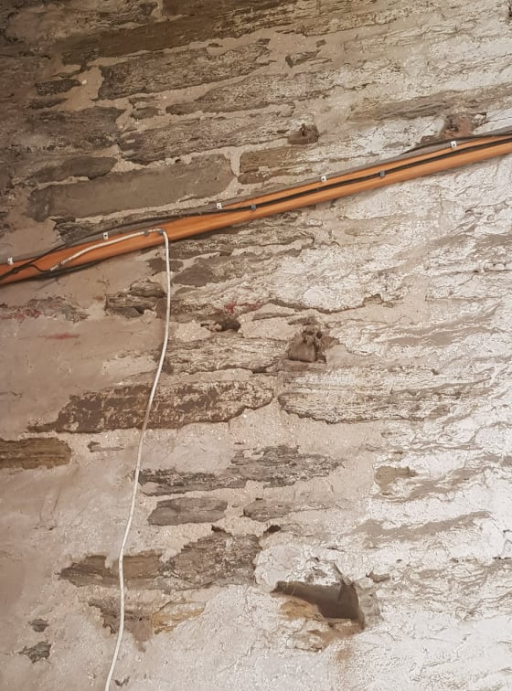

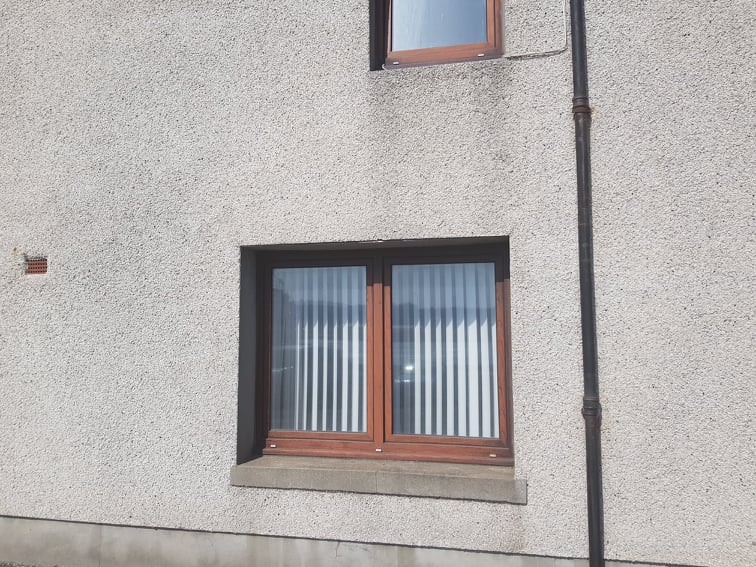

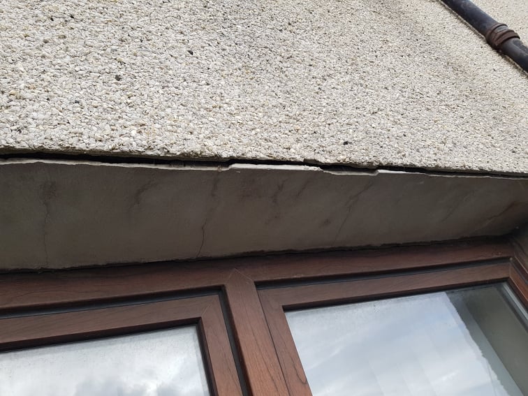

    Ive added a few photos to assist on any info you could help with, The underside is just a concrete finishing not the surface of a lintel,
    Would really appreciate and guidance on any of the above as I have no idea whatsoever about this type of thing, The last photo is just of the inside of the garage so you can see the type of stone build it is, 58033206_904546483049342_2963803733781118976_n.jpg window.jpg 57987739_422270448506676_3622809239208067072_n.jpg 57439897_268811897407630_7805337138962104320_n.jpg
  2. Cannot tell much from the photo's, but you say rail tracks but I am guessing you mean rsj's, it looks to me as the render is coming away from the steel, there are no structural cracks above the window area so I would say all is ok. I would remove the render to see exactly what is under there.

  3. Just looks like it needs making good to me. Who suggested replacement?
  4. ok lads,
    I had asked advice of a friend of a friend (Bricky) and he seemed to think the lintel was rusting and the reason for the render dropping, maybe reason for pushing the render away?? there are a couple small cracks one at ether side about 4" long going up at 45 degrees (are small) , Hard to see, now on the inside the window blind has dropped slightly, just thought that maybe the same thing was happening there??

  5. Looks like it could be made good to me as well. And in fact if you did the Rolls Royce job on it, would still be cheaper than replacement.
  6. Rather than guessing no matter what youre going to have to pull the plaster off to see the state of the lintels....then you'd be able to see.....even then lintel replacement isnt that bad....go to local tool hire, hire out props, drill into the wall just above the lintels themselves, slide the props in and tighten them to take the weight of the wall above, remove the window and then use a jackhammer to get to the lintels....
    We took out and entire supporting wall in our house to open up the kitchen and dining room...its no different. You could also buy 2 lintels and replace one side at a time...ie a double skinned wall which looks like what youve got there...factor in a day per lintel just to be safe...assuming they needed to be replaced of course...
  7. Having said the above they look to be ok to me....unless its the stonework directly above the lintel that could be crumbling??
  8. Depends on the condition of the steel. Break off the render and I'd guess you'll probably be looking at an RSJ with scale on it.

    So the steel gets corroded, gets bigger as it rusts and then blows the render.
    You need to brighten the steel with an angle grinder or MBX type machine then apply something like this....
    http://www.mapei.com/public/COM/products/453_mapefer1k_gb.pdf
    Then get your roughcaster to re-render as normal. Thousands saved...:p
    No need for new lintels...

  11. If the lintels are real railway rails, you haven't got much to worry about; unless there is only one holding up 650mm thick masonry above an 1800mm wide window (and then that is only the amount of masonry roughly inside a 45 degree triangle above the window where the triangle base is the bottom of the lintel and the sides of the triangle spring from the reveals).
    But the double casement window appears to be 1200mm wide rather than 1800mm, so the triangle would only just about reach the sill of the single window above.
    However, it does look to me as though the underside of the double window head soffite is suffering from water ingress, from the way it is cracked and it irregular along the front edge.
    Personally I would find out what that soffite actually is, because it looks really thin - almost looks like asbestos.
    Basically the vertical wall rendering should have a drip formed, so it sits lower than that window head soffite - I wouldn't expect to have to remove any render from the vertical wall face to form the drip. Could be done by screwing an aluminium drip section to the render having bedded it on a suitable mastic.
  12. It does look like when rendered, they forgot to put a drip bead in
    Can I ask, has it had insulation material added like a full insulation jacket and then rendered over with in recent years?
  13. Looking at the air brick and the gutter i would say it has been rendered with no insulation and if i am being honest not the best job i have seen, lazy rendering in the gutter brackets and smooth rendering the window reveals.
  14. The window is 1800mm, No insulation has been added in the past, The soffite is mortar and is a little thicker than the photo shows (not asbestos)

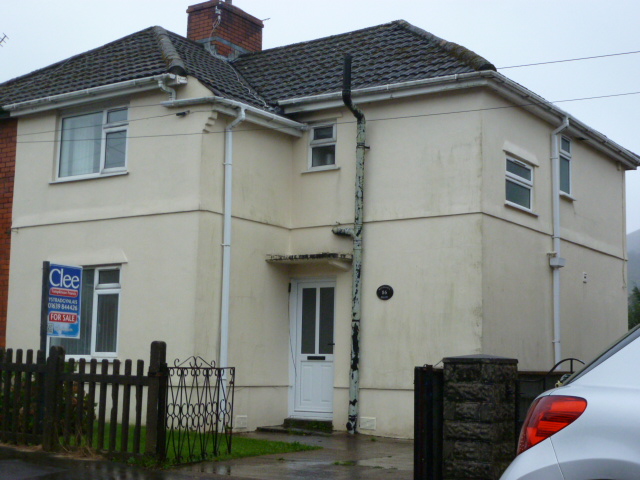

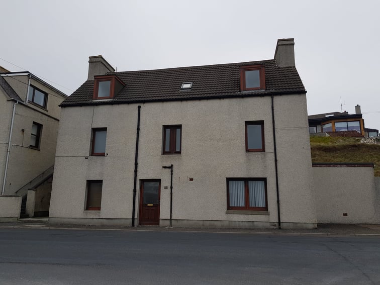

    I wont manage to remove plaster inside or the underside render outside just yet but will update when I get to it, Just to give a better idea this is the outside view of the house, Window in question is bottom right, As said before I really appreciate the advice, Cheers
  15. The wall finish looks like what used to be called Tyrolean render. It wasn't actually sprayed on, but a bloke used a revolving 'drum' which he aimed at the wall and turned a handle which chucked the render onto the wall.
    I doubt you have much to worry about - the house had been standing for years.
    My place has a mixture of masonry walls with varied thickness (cavity and solid) but most of the lintels are crappy timber - they seem alright, though.
  16. Part of my mct training is to access lintel's prior to window removal, a job I dislike as it often can lead to conflict with the customer, your build is not the norm, brick, cavity ,brick being the standard type build, your windows are set well into the building leaving a large unsupported area above the window head, how the brickwork is being supported can only be seen with a bit of digging.

  18. That is exactly what I have to look for, in your case window removal would compromise the building structure , render is always a problem as fitting a concrete lintel is easy to do as it will never be seen as it will be covered by render, problem being is patching in render is almost impossible to get a good match the op house being a good example.
