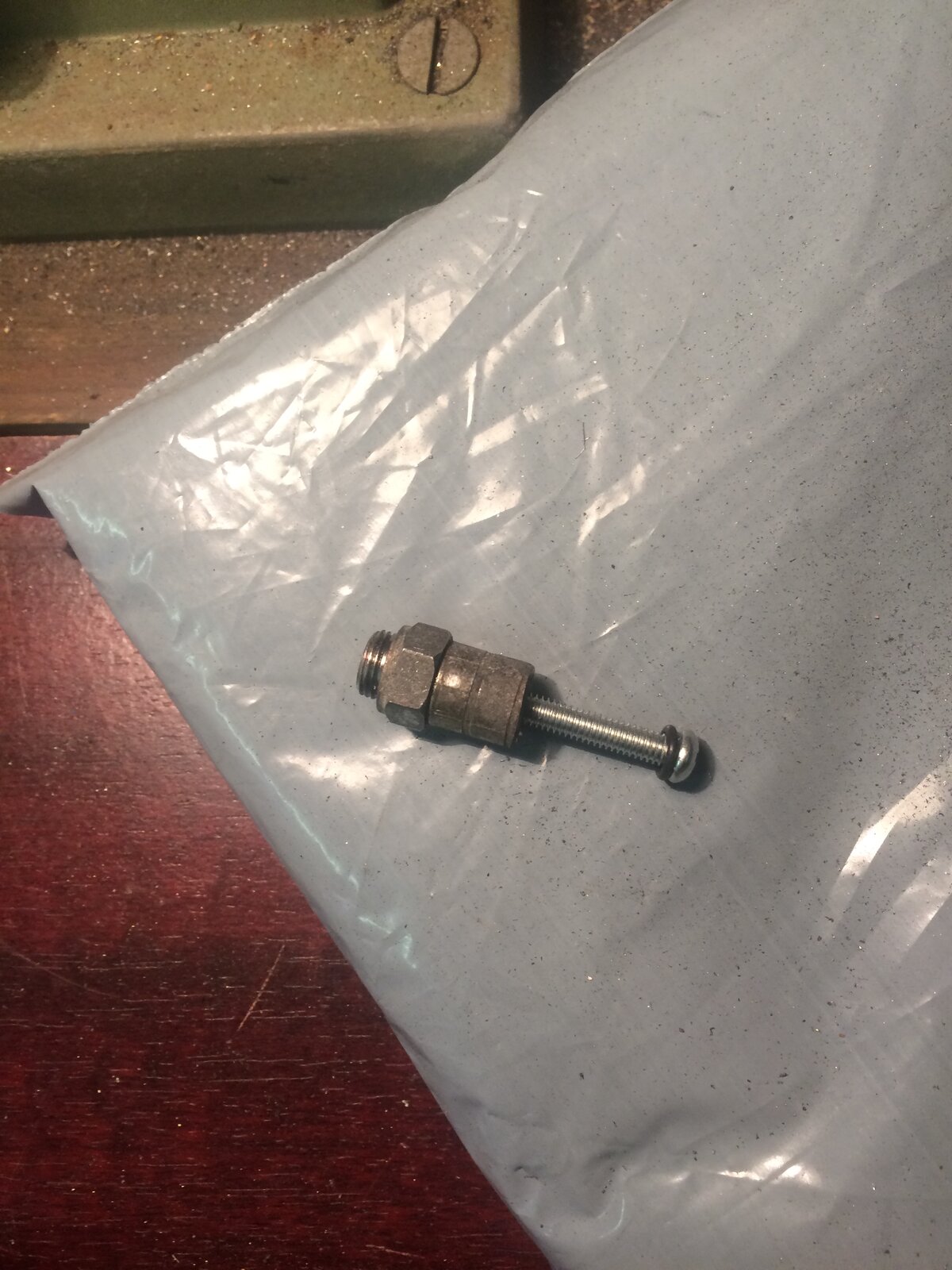

  3. F1D396F9-DD7D-4149-A638-D79A55521B69.jpeg 7786DFA5-A51B-4D39-A5C8-B07F6D118693.jpeg 0B943B78-AC7F-471E-8B9C-594DB0B719FD.jpeg 473FCD4C-3BDD-4F4A-8021-B51D598C2930.jpeg Thanks for the replies, I have done a temporary (bodge) fix for tomorrow, those of a nervous disposition please look away now!
    I’ve made my own blanks by cutting off the unions, tapping M4 and fitting screws with O rings and Sikaflex as blanks , the original pipes were badly kinked so I was going to replace them anyway, I do need a replacement bowl & pipes soon though.
    (The Sikaflex is there as a threadlock, the screw being threaded through the entire length of the fitting and a small O ring under the screw head will do the sealing, it was only after I applied it that I found my bottle of threadlock!).
