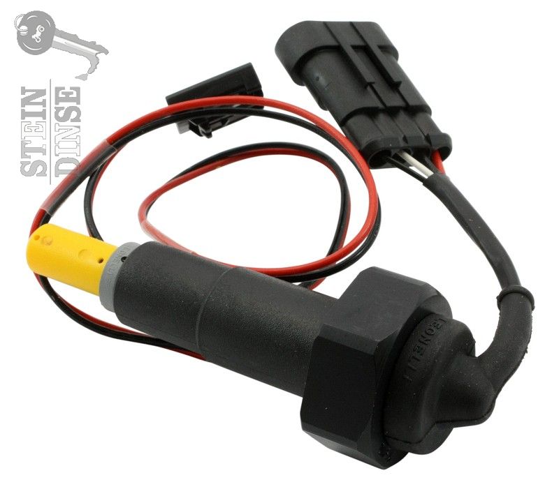

  8. could get a cheap syphon pump and empty the tank easier than drain plug for the majority of fuel
    fuel level sensor just unscrews from bottom of tank although
    the plastic nut has a tendancy to break because they are well crap any sediment around the sensor etc could cause it to stick a little

  9. OK! Thanks, everyone.
    I get it - if the sender is duff, I'll end up having to empty the tank anyway, so I might as well bite the bullet and syphon the tank empty. that way, I can check that/when it tells me that the fuel's low and replace it if I need to.
    Thanks very much johnboy for the picture (and the fragile plastic alert).

  12. they aint cheap little buggers either
    stein dinse show them at 140 euro
    did buy one a couple of years ago from itlia moto in Lincoln
    to be honest I cannot remember what I paid !
