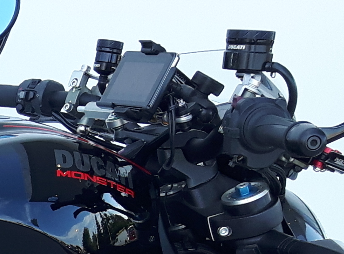

    Screenshot from 2020-03-27 08:20:41.png

  16. Damn, I was enjoying my tomato.
  17. I'm surprised you can get a decent charge from a standard USB port, however the demands of these devices for power is getting bigger: I assume you get a charge it just doesn't charge as fast as the rate that it is being drained. I have a normal (and quite cheap) usb socket tucked away under the bars, with the cable running under the tank, i just plugs it in where the charging socket is under the seat. It powers my Samsung s8+ fine and I normally run google play and maps on a split screen. (quad lock mount).
    I did find an optimate usb socket (didn't even realise i had it) in a box of bike bits whilst i was looking for a full size number plate and the baffles ready for an MOT. I might look at using the optimate connecter and then running a usb cable from under the seat to the bars because:
    1. I use a short usb cable at the moment and some times the usb cable lifts out of the socket where the wind catches the cable
    2. If i leave the usb cable in while i'm parked up it is easily pinched
    3. it will look a bit cleaner ..
    I think USB C at both end will make it water proof (more than a standard Usb connection anyway) :thinkingface:

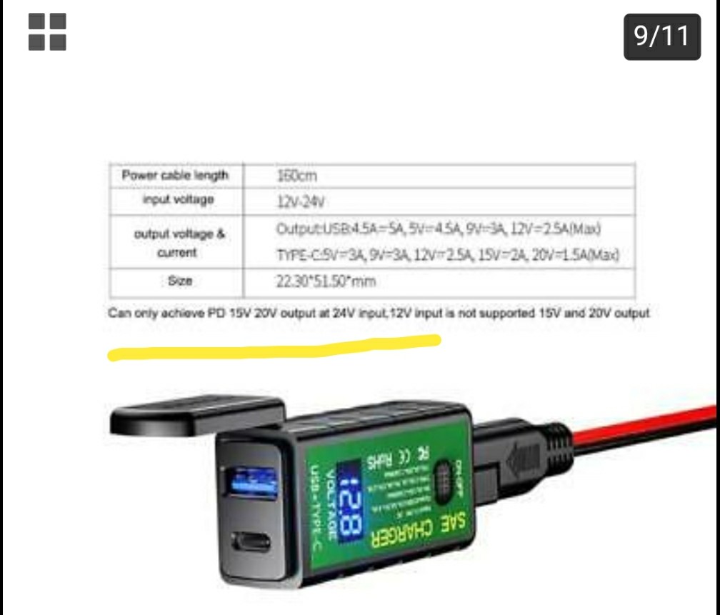

  18. Good news - bad news Rex. Have a look at image #9 where the text says you will only achieve PD charging if the device is supplied at 24V input, so bad news:weary_face:. Good news is that it's showing a SAE connector!
  19. I think I need 5v. But I did miss that...
    I believe many (or some) of the other USB types have enough power... but if they are not USB-C the logic needs to be there.
