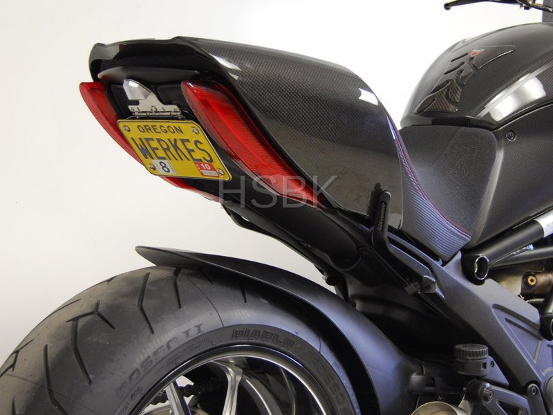

  1. I'm looking for a tail tidy for my 2015 Diavel, as I really don't like the standard location.
    I've found this, and would be able to make up something similar.
    OK, I accept that I will need a slightly smaller than legal plate, which I'm OK with.
    But, the question is, how illegal / police attention grabbing, would a number plate positioned this be?
    I was looking to angle the plate away towards the back of the bike, as per a traditional set up. But, quite like the look of the this style, just wondered if I'm going to spend all my time getting stopped by the police.
    What do you think, asking for trouble, or 50/50 OK?
  2. It's the size that's key. May get you a pull but long as visible from the back 'think' it's ok :upyeah:
  3. It's around £30 for a illegal size number plate but I'd imagine you'd be getting a 'fix within 30-days notice'. If you actually tried to use that on the road.

    If the angle isn't going to make it more of a police magnet, I may give it a go.
    Watch this space :imp:
  5. Small plates are around £10 max, had one for a lot longer than 30 days so don't listen to bollocks like you'll get a ticket with one.
  6. It's not the issue of the size of plate that I'm bothered about, its if the position will draw more attention, than a typical position angled away from the bike ... ie: traditional style.
  7. The plate is not visible to a fixed camera. In the unlikely event you are followed by a traffic officer, IMO it is likely you will get pulled. Andy
  8. Its a £100 fine. It went up from £60 not long ago. I generally get hit once a year.
  9. OK, a slight tweak to bring it a little closer to vertical, but, not enough to hit the tyre on full travel.
    All else OK for me to give it a try.
    Thanks for the comments and views.
  10. Legality is often a case of interpretation. In this case most coppers would say it is illegal and most magistrates would agree. Most times their is no appeal

    In other words, make sure it can be seen from the sides as well as from directly behind and make sure it's illuminated at night.
