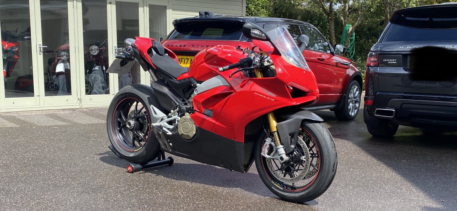

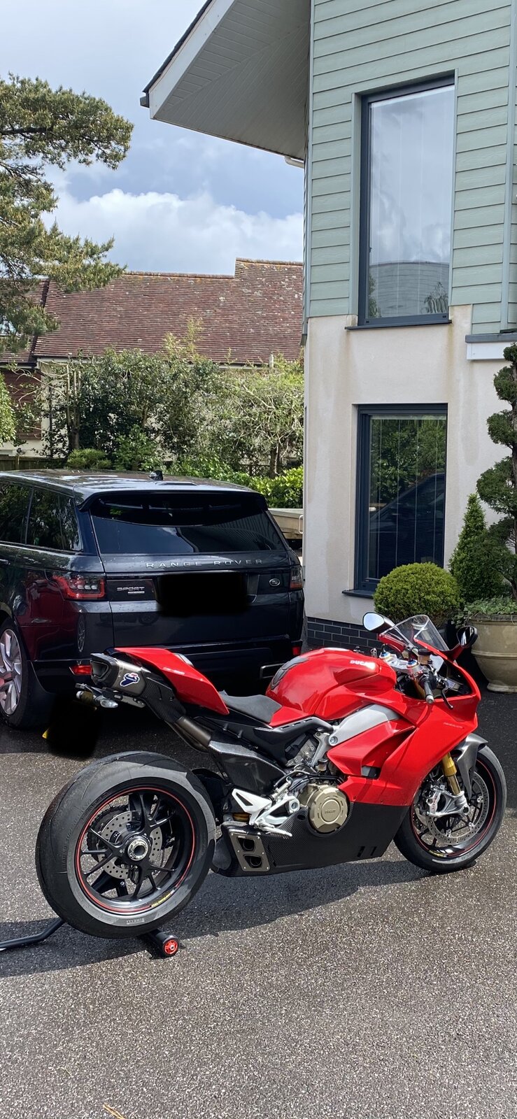

  13. Holy fucking shit, it’s loud.....
  14. ah, yeah, that will wake the dead.
  15. Looks well :):upyeah: Any yep, it's a loud system. My only allowed playground in UK is Donington (loud day). 90% of my trackdays are euro gigs.
  16. Thought so! Jerez, as soon as possible....
  17. It’s so pretty....
  18. Wise choice Sir.... :D
