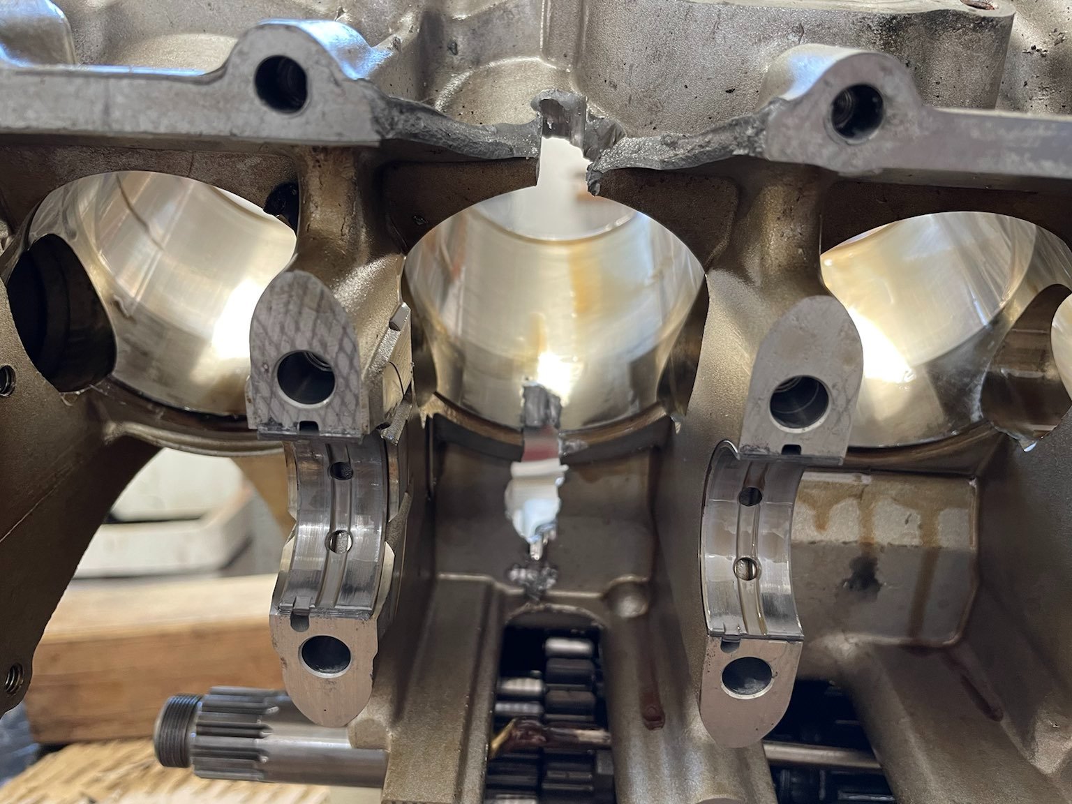

  1. I blagged a broken R6 engine from my local mechanic for the sole purpose of stripping it down and then rebuilding with a view to a) learning how its done and b) make a cutaway engine from it.
    I've quickly learnt that taking an angle grinder to aluminium isn't the best way to go about things so, question is....what's the best way of cutting an engine block ?
    In case you're wondering, #3 conrod had enough and threw its toys out of the pram!
  2. By the looks of the thickness of the cut, you are using one of grinding disc proportions, not a cutting disc of around 1.6mm
    Also, aluminium does not like being ground out so much and melts, clogging the disc. Special discs are available for cutting aluminium to
    alleviate the problem, but you will need to comply with the disc rpm guidelines for them to be most effective.
    A big band saw is what you really need.

  3. Band saw, slow & oily feed type.
  4. Actually that's the result of the #3 conrod breaking!
    The band saw would need to be pretty big though, no other alternatives ?
  5. You could try one of those abrasive wires used for cutting pipes with restricted access. Look like a cheese wire but impregnated with diamond etc.

    Hard to make a nice clean cut without a band saw really.
    Some of the lads may be able to advise if water jet cutting or similar is feasible for such a task.

  12. After carefully planning to position your cuts so that they show the internal workings you are trying to display without the moving parts falling out, cut the big lumps out with a hacksaw, (as has already been suggested) & then finish the edges on a milling machine.
    It's also nice to paint the different internal areas different colours, i.e. inlet tracts, exhaust tracts, etc
