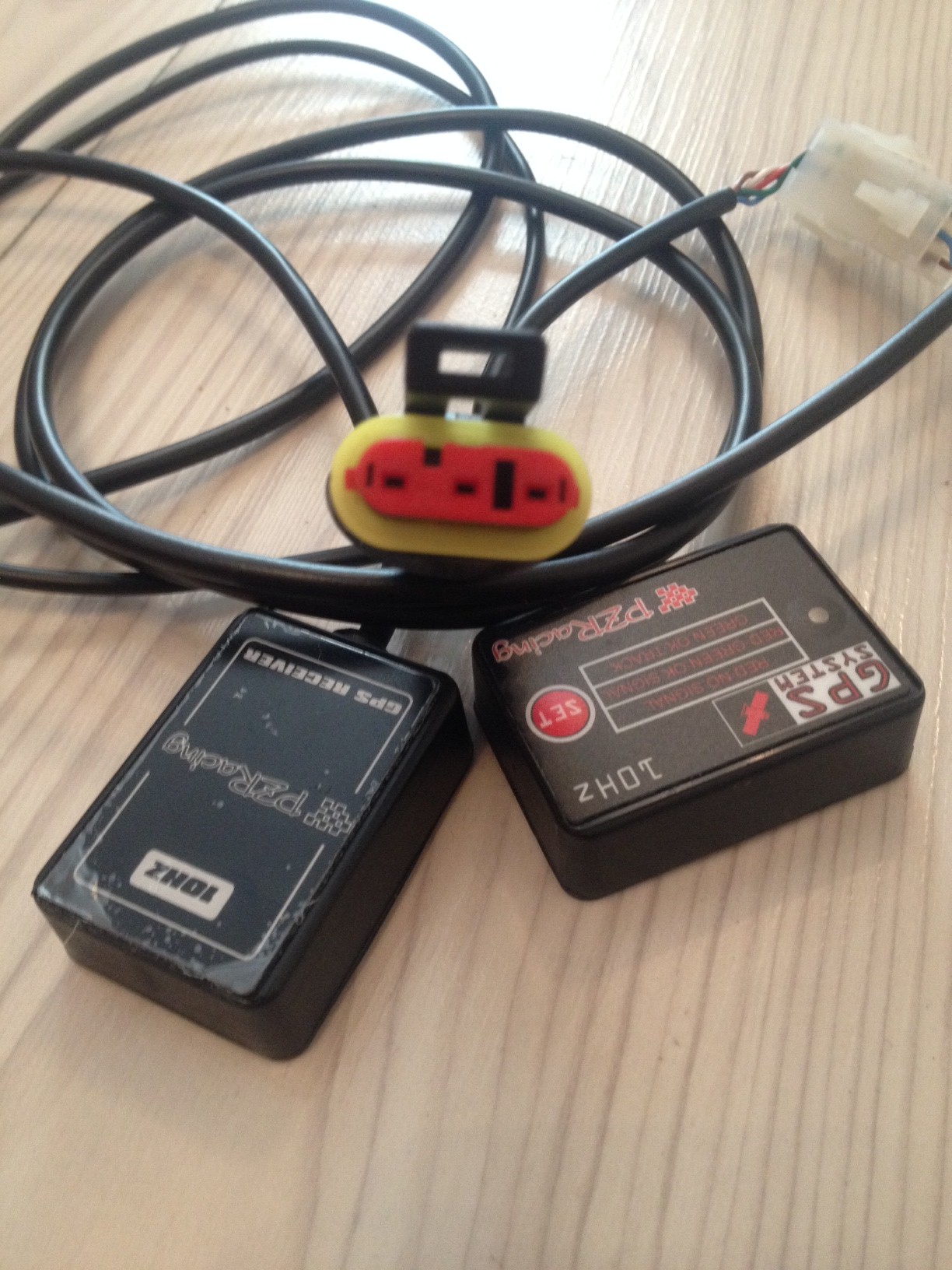

    I bought a GPS laptimer from pzracing but the installation instruction is not clear.
    Quote from manual : "Fit the Desmotronic connector to the special input of your motorcycle... "
    Does anybody know where the special connector is located ?
    I had a look and can confirm that it is not the diagnostic port ( just below the ecu ) and neither where we connect the DDA ( under the passenger rear seat ).
    I have attached a picture of the connector.
    Many thanks

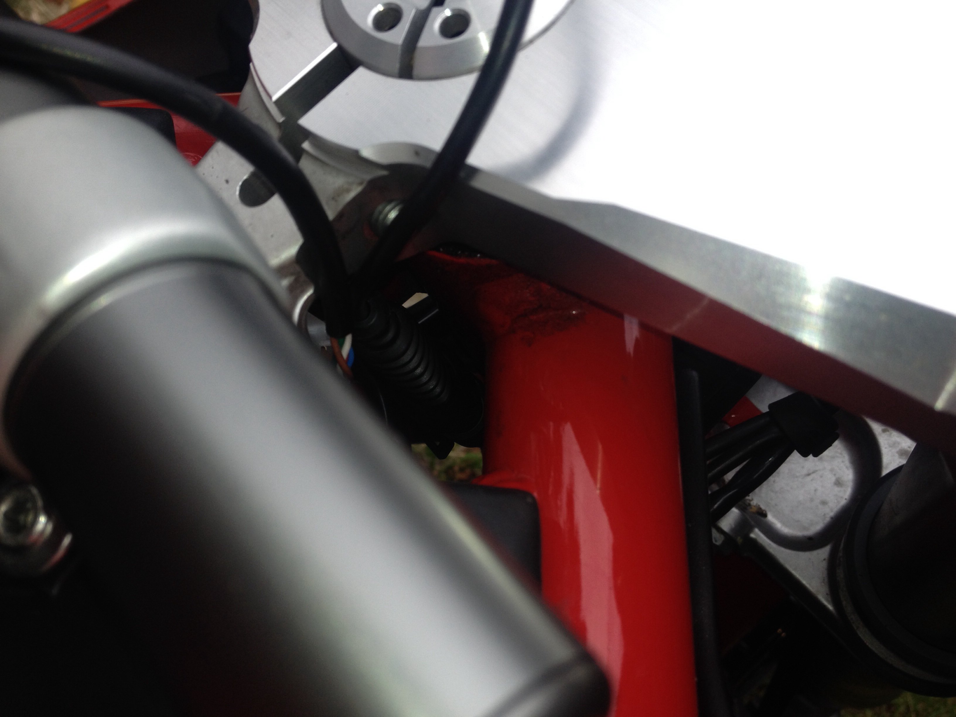

  2. What bike would help
    On the 749/999 it's on the side of the headstock
  3. Sorry, the bike is a 848 evo corse.
    Thanks for the tip. I will remove the front fairing and see if I find it.

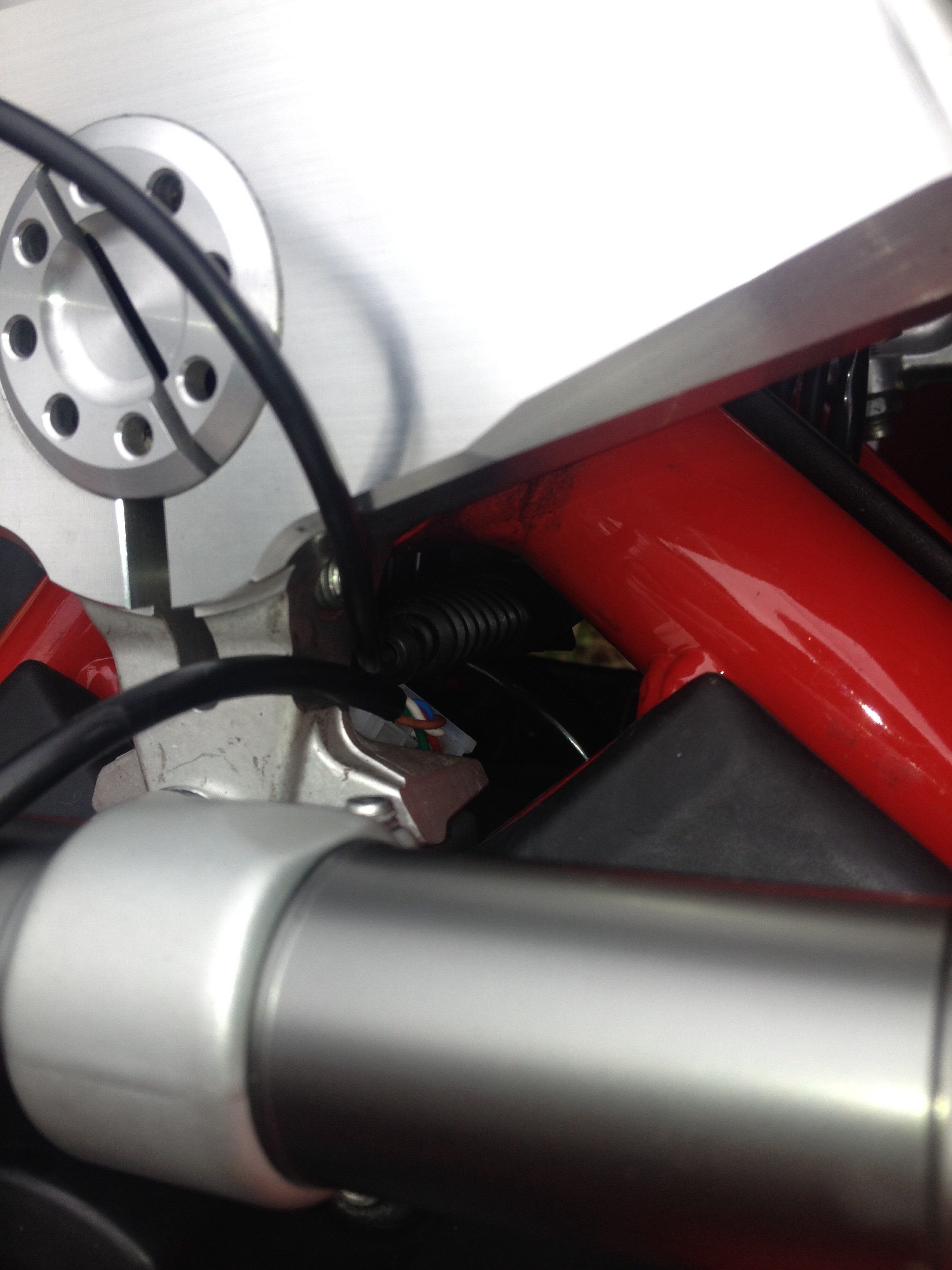

  4. Look behind the headstock, or infront as I can`t remember which it is, and you`ll see the socket with a blank plug in it.
    For the best results you`ll want the DDA USB stick as well.
  5. Thanks, I will have a look this weekend.
  6. Hi guys , I managed to install it. The connector is just behind the headstock . If you look down between the tank and the top yoke you will see it. See pic.
