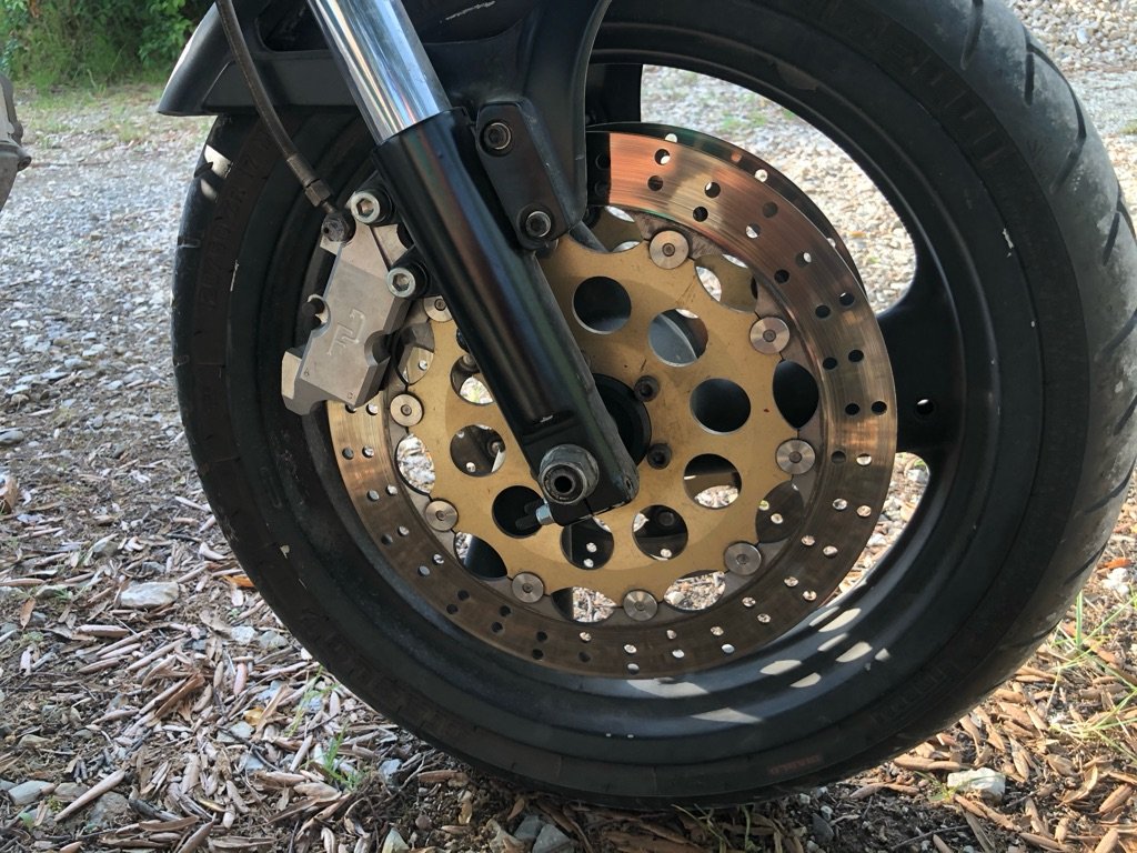

  17. The M600 i've seen for sale in my neighbourhood has unfamiliar brake calipers. Does anyone recognises them? Expensive billet calipers or cheap Chinese junk?
