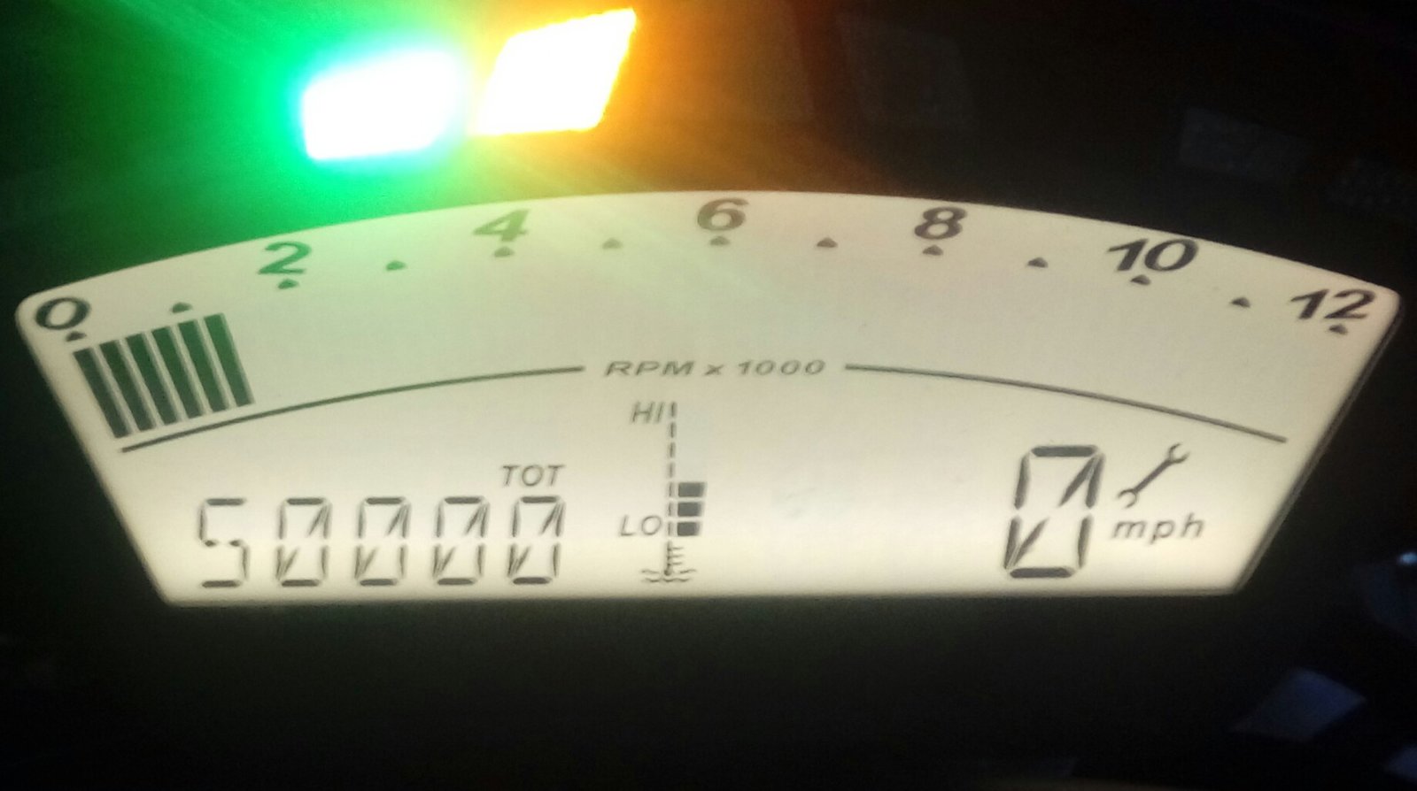

  1. This happened today...
    50,000 miles, 6 years of fun, not totally trouble free but suprisingly good.
    Not seen a dealer since 18k, 4.5 years ago.
    Will add a timeline of stuff.
    Roll on the next 50...
    Someone will point out the spanner sevice warning & engine lightcare on no doubt.

  9. Had the engine had any major work in these miles , just out of interest so
  10. Replaced the exhaust valve guides at 45k, evr 48t clutch basket & plates at 20k, oil changes every 4k, belts 2 yrs. New starter motor at 45k. That's it really for the motor, gets ridden pretty hard as possible on the road, generally 25 mile minimum journeys, 2 min warm up before set off.
    Uses no oil between changes, to the points point I never check the level!...
    I ran it in
  11. Not bad really , pretty strong old lump the air cooled unit
  12. [QUOTE="I ran it in[/QUOTE]
    Meant to say, I ran it in quite hard, in fact when I started to rag it I was dissapointed in performnce as I had probably been using 85% power not the 50 I thought I was... Still once decated & remapped etc. I was happy with performance.
