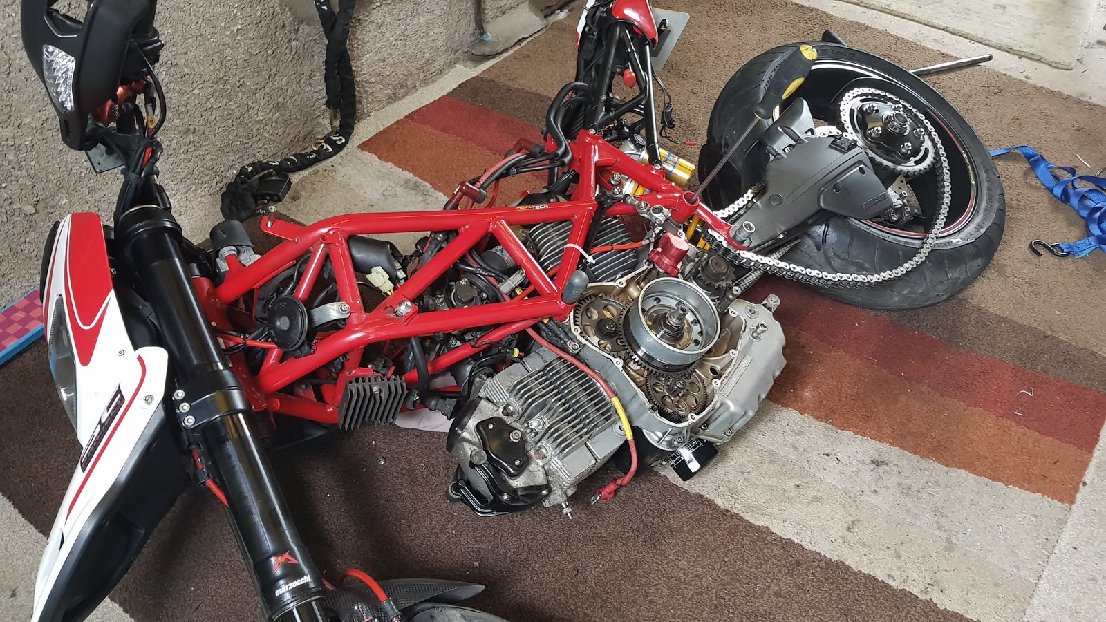

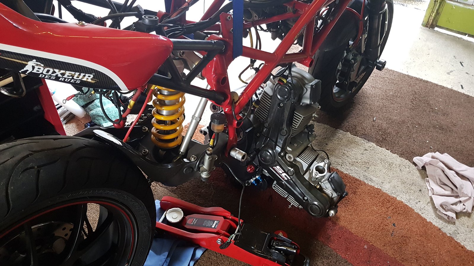

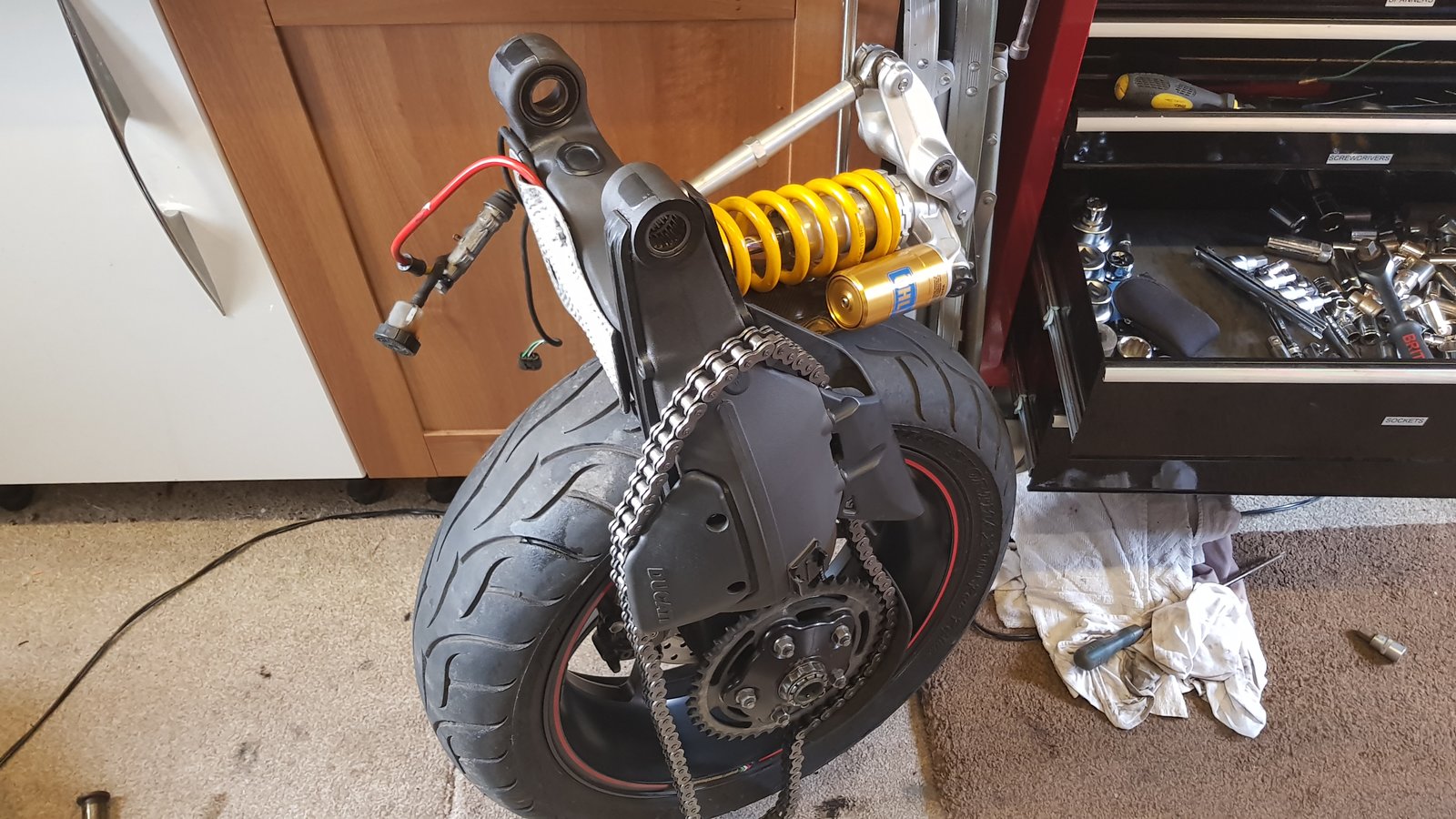

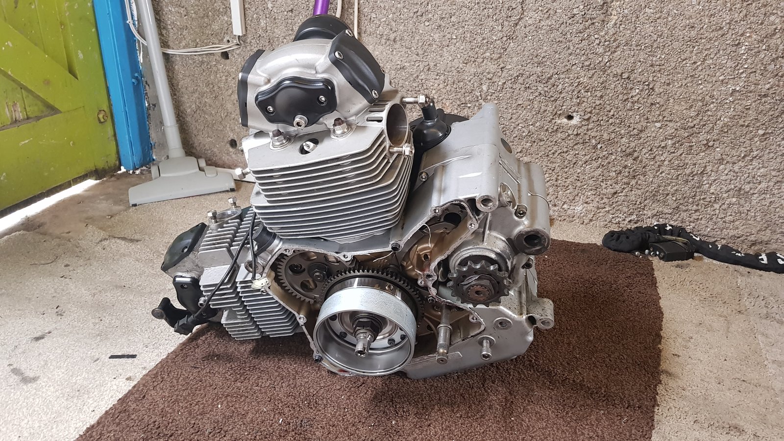

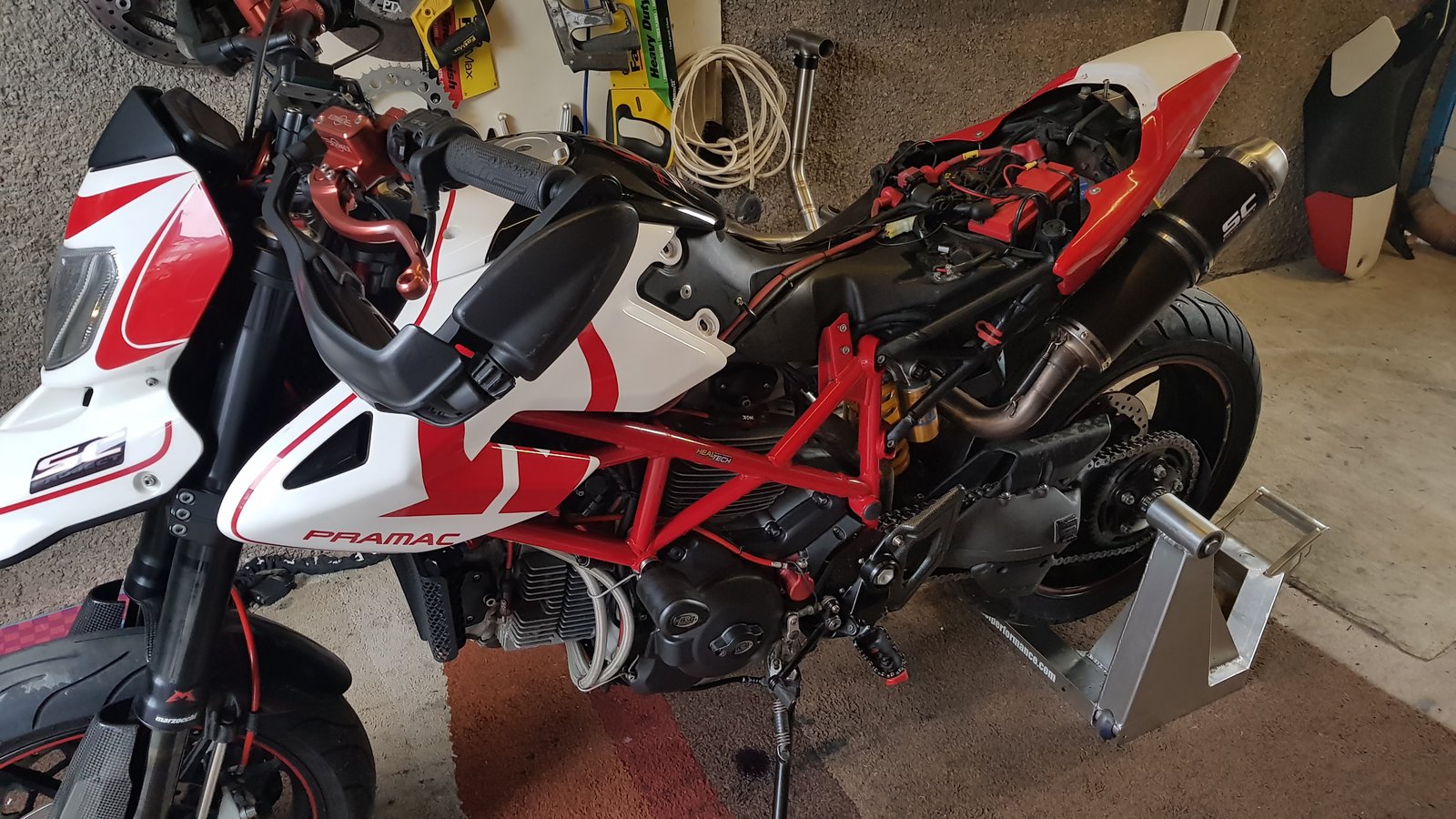

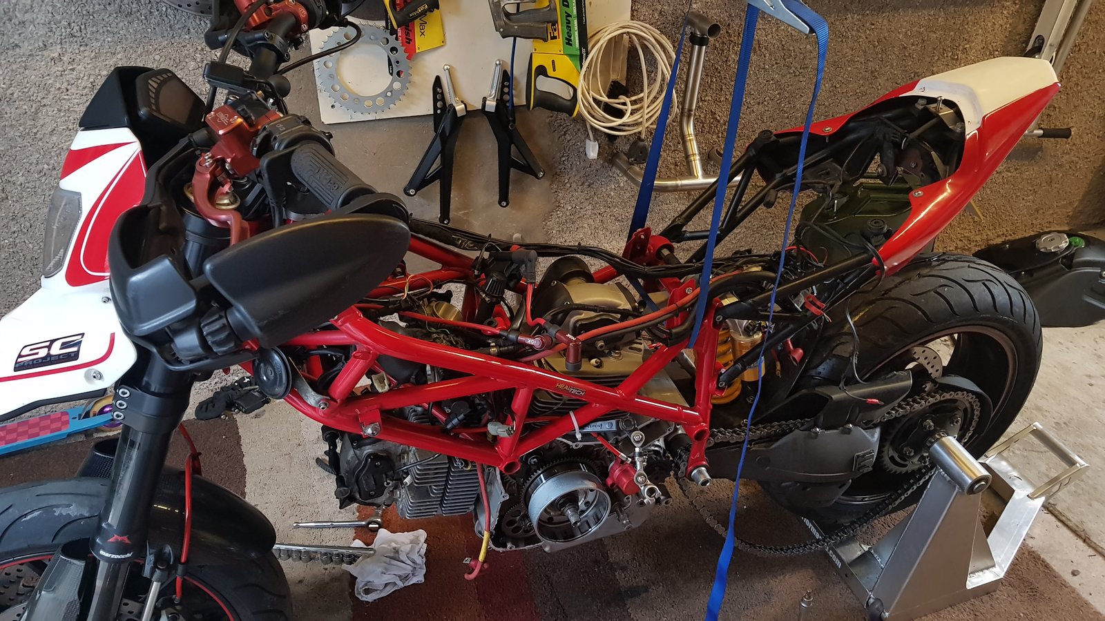

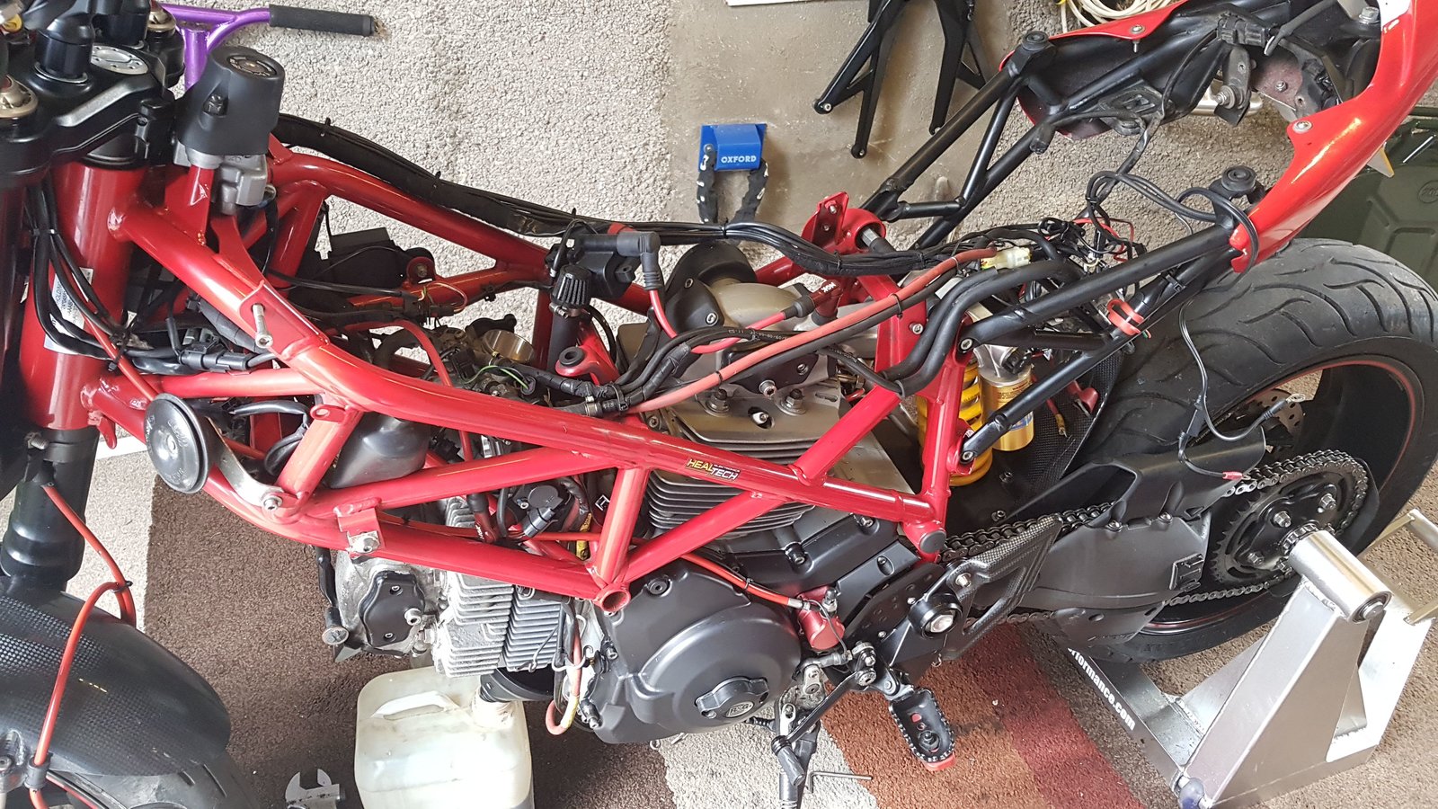

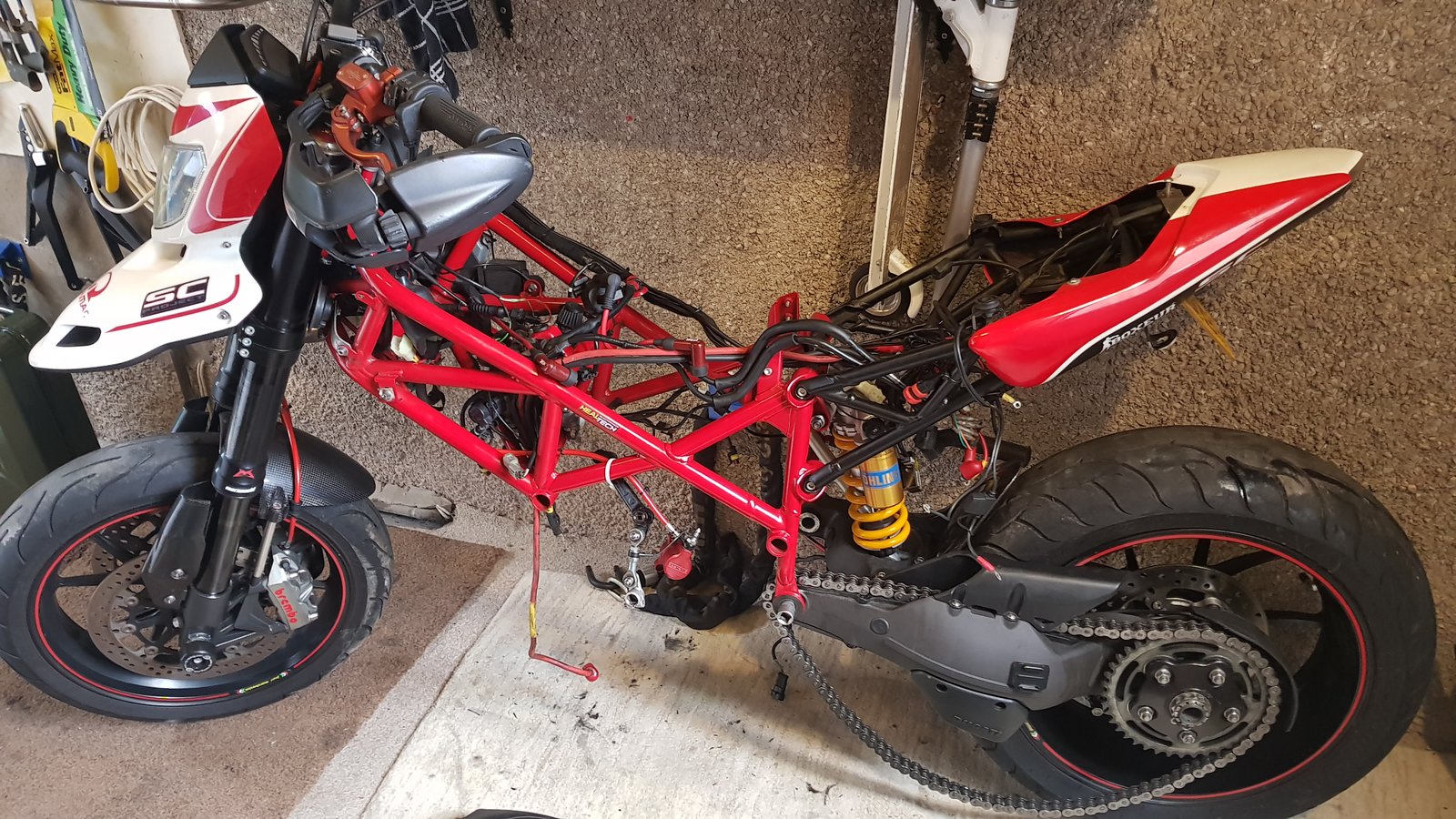

  1. This. Is going to be a long one. 5 hours in the garage this morning removing the hypers motor. This has kinda spilled out some other jobs. Swing arm pivot bolt needs a service ( 2 hours of the job was just removing that ). Loom needs a good clean. Some coating on a few bits attached to the sub frame...

  5. Yeah....crank seized....not found out why yet...

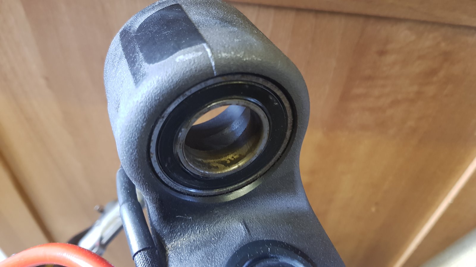

  17. I don't think it's going to get much worse...what's the verdict on the swing arm bearings....I can't feel any play but the they're a little corroded where the spindle goes through...
    It's a sealed unit so not sure how I can get some grease in there...

  20. Check the needle bearing on the left of s/arm, mine were shagged at 18000 due to insufficient grease from factory.
