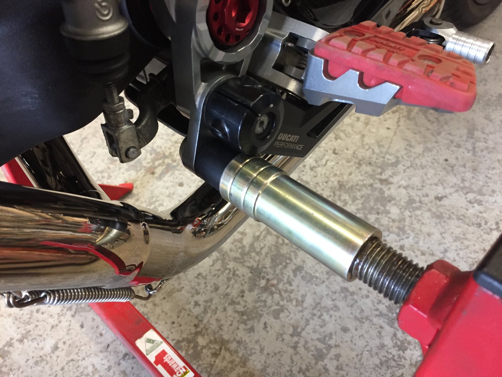

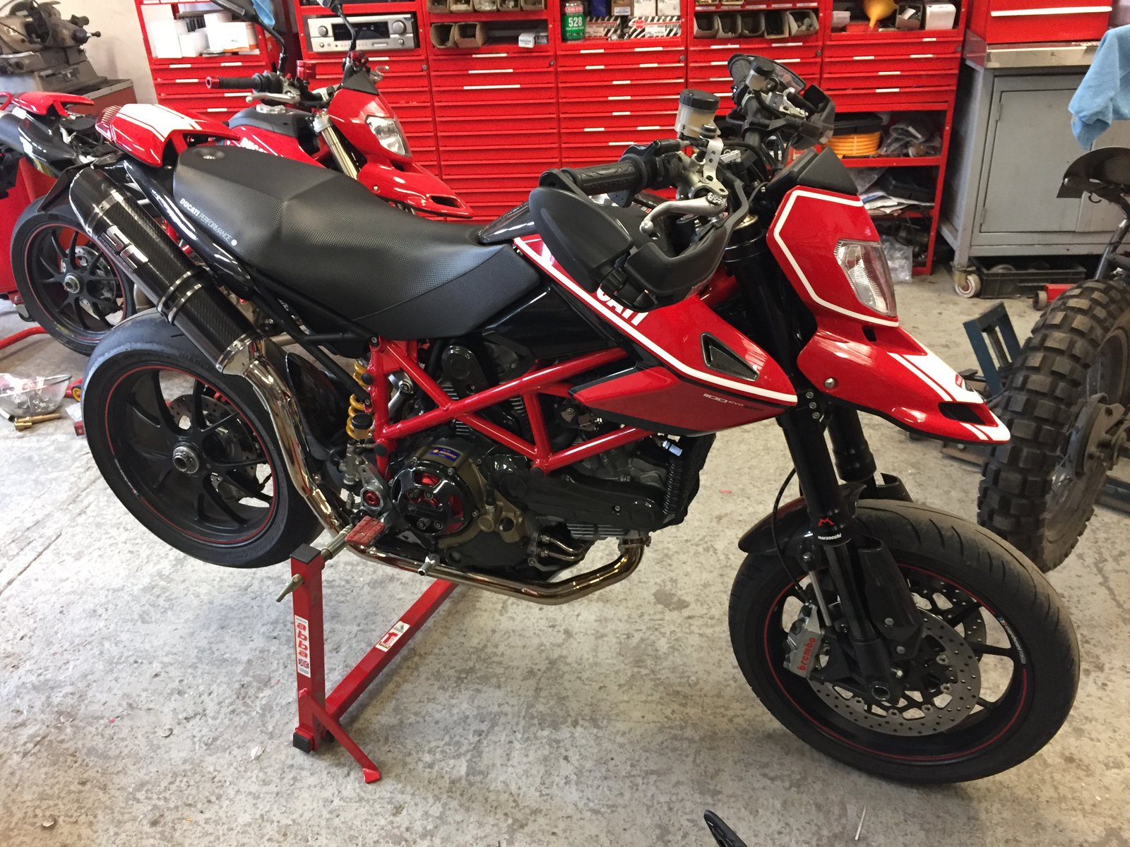

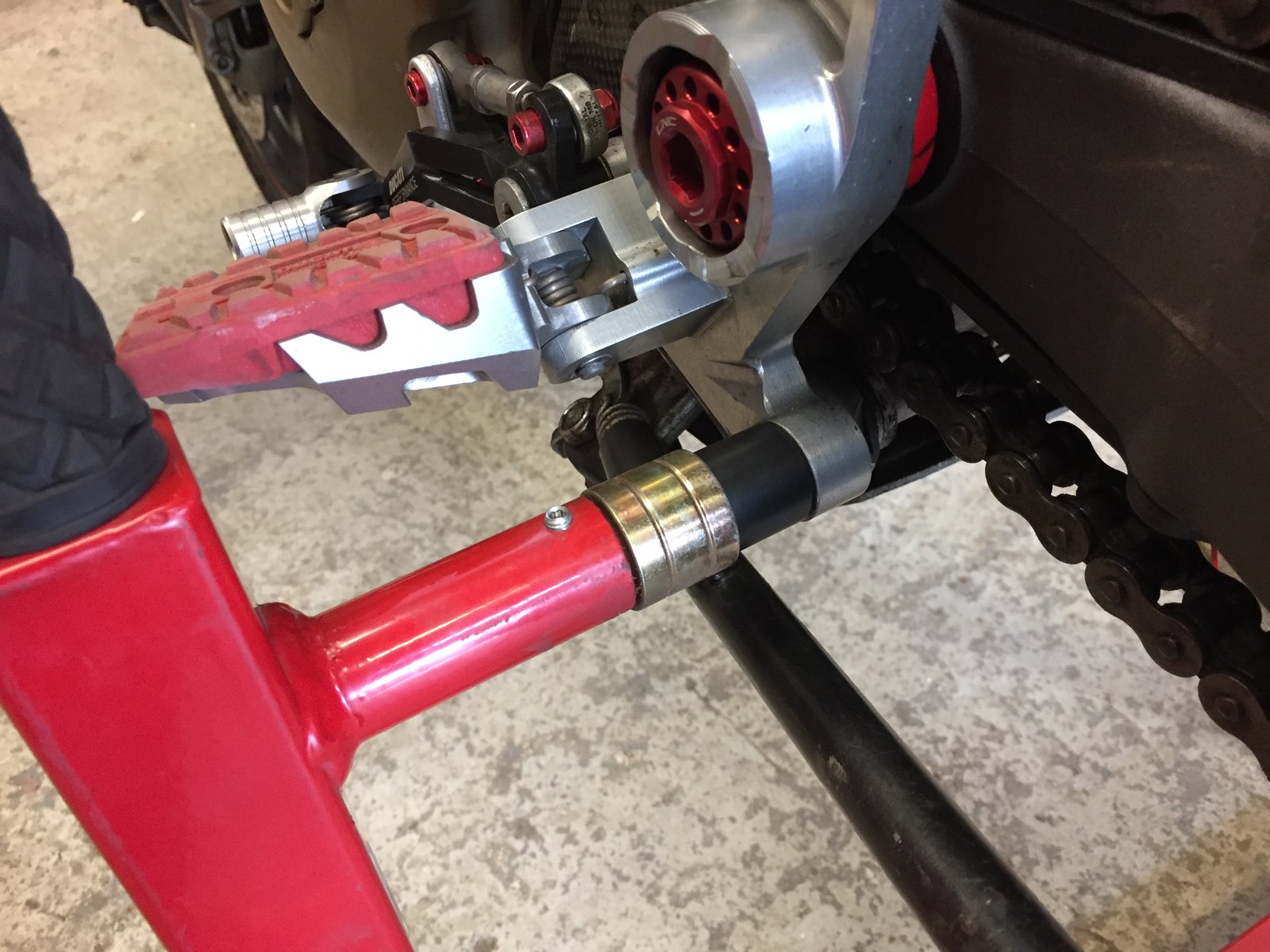

  1. IMG_7731.JPG IMG_7732.JPG IMG_7733.JPG Hi folks. I thought I'd share this simple mod with you guys, as Abba Stands do not make any kind of adaptor to use their product on aircooled Hypers. I had a quick measure up and came up with a simple machining job that took only 20 mins from start to finish. I machined the adaptors out of hard nylon - strong, but non-marking.
    Simply remove the pillion footrest brackets and bolt on the nylon adapter and you can use the Abba stand as normal. Cheers, Matt
